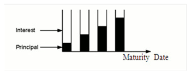

The following are the explanations of each of the amortization type codes.
100, 400, 500, 600, 840 - Conventionally Amortizing AMRT_TYPE_CDs
Description of amortization type codes follows
The conventional amortization loan types have loan payments that are unevenly divided between principal balance and interest owed. The total payment amount (principal + interest) is generally equal throughout the life of the loan. The interest portion (non-shaded portion) of each payment is calculated based on the record's interest rate and the remaining balance of the loan. Therefore, close to the loan's origination, a higher portion of the payment consists of interest rather than principal. As the loan is paid down, an increasing portion of each payment is allocated to the principal until a zero balance is reached at maturity.
NOTE |
For Lease amortization, the principal is reduced to the amount defined in the RESIDUAL_AMOUNT column rather than zero. |
For these five AMRT_TYPE_CDs, the amount in the CUR_PAYMENT and/or ORG_PAYMENT_AMT fields should equal the principal plus interest.
Following is a breakout of these four conventionally amortizing AMRT_TYPE_CDs:

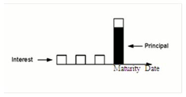

700 Simple Interest (Non-amortizing)
For simple interest amortization type, no principal is paid until maturity. If NEXT_ PAYMENT_DATE < MATURITY_DATE, OFSA calculates interim interest-only payments as shown in the earlier diagram. OFSA pays the entire record's principal balance on the maturity date along with the appropriate interest amount.
For this AMRT_TYPE_CD, the CUR_PAYMENT and/or ORG_PAYMENT_AMT fields should equal 0.

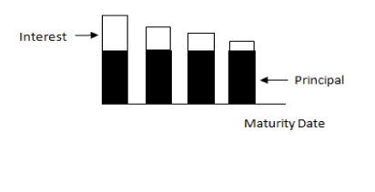

820 Level Principal Payments
The level of principal payment is the amortization type in which the principal portion of the loan payment remains constant for the life of the loan. Interest (non-shaded portion) is calculated as a percentage of the remaining balance, and therefore, the interest portion decreases as the maturity date nears. Because the principal portion of the payment is constant for life, the total payment amount (principal plus interest) decreases as the loan approaches maturity.
For this AMRT_TYPE_CD, the amount in CUR_PAYMENT and ORG_PAYMENT_AMT fields should equal the principal portion only.

AMRT_TYPE_CD 700 (Simple Interest) : CUR_PAYMENT equals interest only. The cash flow engine always calculates the interest component of any payment amount. Therefore, for extracting purposes, a simple interest record's CUR_PAYMENT = 0. If a repricing event (payment recalculation event) occurs, the interest amount of the payment (financial element 430, and if applicable, 435) is recalculated as indicated under the ACCRUAL_BASIS_CD. The only principal payment is made at maturity (Maturity Payment = financial element 195, 197).
AMRT_TYPE_CD 100, 400, 500, 600 (Conventionally Amortizing) : For extracting purposes, CUR_PAYMENT = principal + interest. If a payment recalculation event occurs, the cash flow engine re-calculates the total CUR_PAYMENT amount using the following formula:
Description of formula to calculate the Current Payment follows

AMRT_TYPE_CD 820 (Level Principal) : For extracting purposes, CUR_PAYMENT = principal only. If a repricing event occurs, the cash flow engine recalculates the total CUR_PAYMENT amount using the following formula:
This calculation yields the principal payment amount only (financial element 190 or 192). To derive the total payment amount, the interest amount (financial element 430) calculation is applied and added to the principal portion.

2. MATURITY_DATE is considered the final payment date. Any remaining principal balance that was not reduced by a scheduled payment date is paid on the MATURITY_DATE (regularly scheduled principal runoff is financial element 190 or 192 and maturity principal runoff is financial element 195 or 197). Therefore, at the MATURITY_DATE, the record's balance is reduced to 0.
3. If the record has a balloon amortization, the maturity payment includes the balloon or large final payment.
