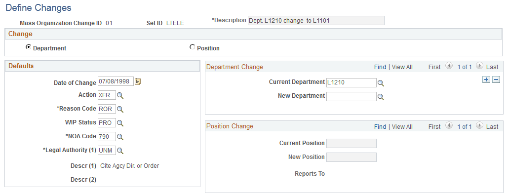

Use the Define Changes page (GVT_MOC_DATA) to define mass changes.
Image: Define Changes page
This example illustrates the fields and controls on the Define Changes page. You can find definitions for the fields and controls later on this page.
Define Changes page
Change
Indicate if the change is a department or position change. When you select Department, the system makes the fields in the Position Change group box unavailable. When you select Position, the system makes the fields in the Department Change group box unavailable.
Defaults
The system inserts the values you enter here into the new job data rows it creates for the employees affected by this mass organization change.

Department Change
You can add more than one row to accommodate changes to a number of departments. If you are merging two departments into one, for example, enter two rows and select one old department in one row and the other old department in the other and select the new department they are merging into in the New Department field in each row.
