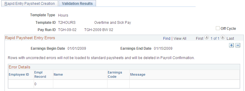

Use the Validation Results page (PYRE_INVALID) to view employee and earning code errors relating to rapid entry paysheets.
Image: Validation Results page
This example illustrates the fields and controls on the Validation Results page.
Use this page to identify errors to be corrected.
Note: If no errors are found, a No errors found in validation process message displays on this page.
You are automatically transferred to this page upon save if you have selected the Validate on Save check box on the Rapid Entry Paysheet Creation page (PYRE_AMT_ENTRY). If you do not select Validate on Save, the Load Paysheet Transaction process performs the validation. Invalid entries are not loaded and can be reviewed on the Validation Results (PYRE_INVALID) page.
