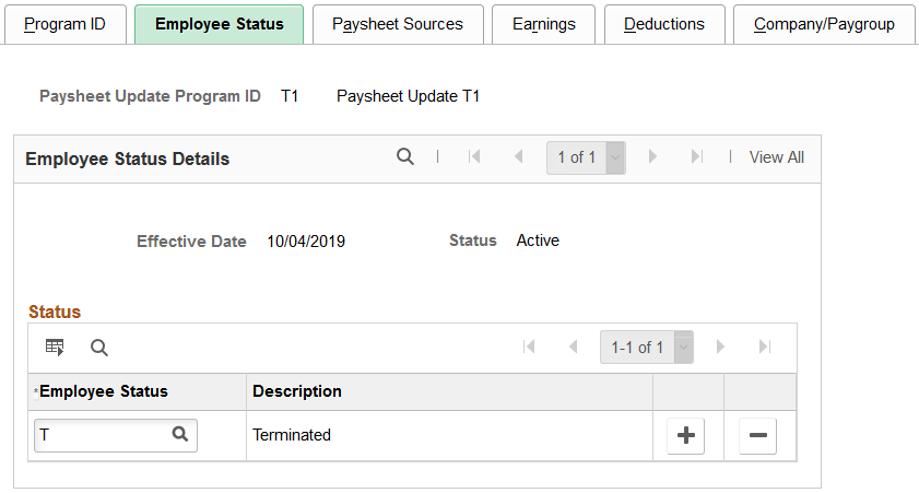

Paysheet Update Program - Employee Status Page
PSHUP_EMPL_ST_DEFN
Specify employee statuses used for loading paysheet transactions for inactive employees.

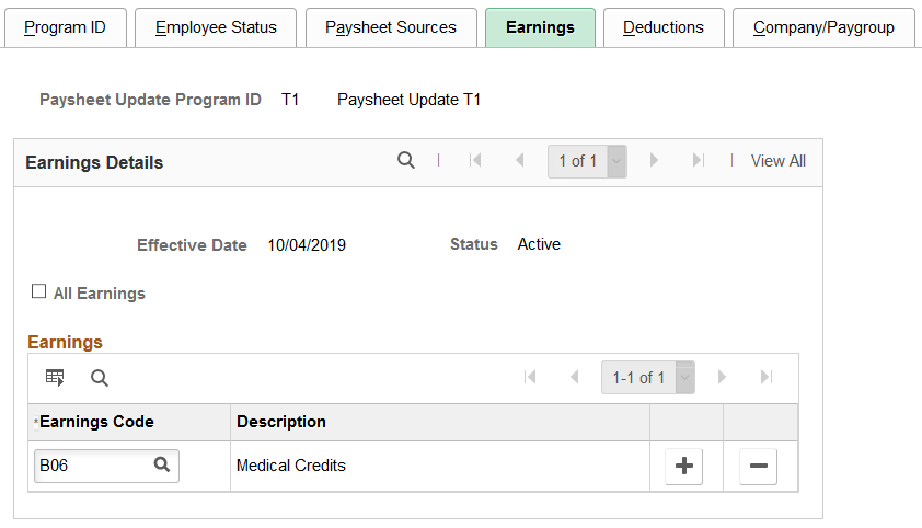

Paysheet Update Program - Earnings Page
PSHUP_ERNS_DEFN
Specify earnings codes used for loading paysheet transactions for inactive employees.

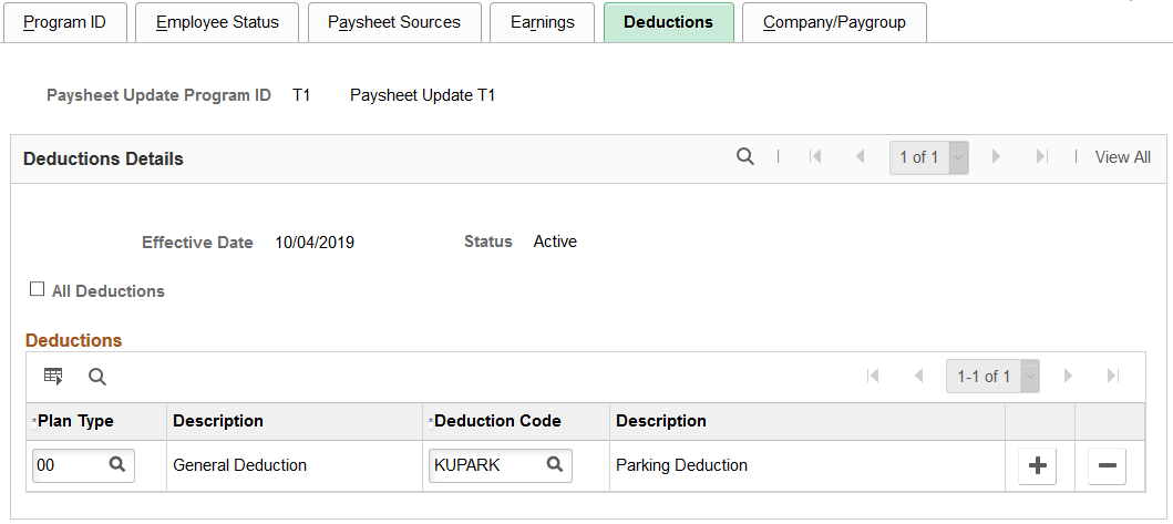

Paysheet Update Program - Deductions Page
PSHUP_DEDS_DEFN
Specify deduction codes used for loading paysheet transactions for inactive employees.

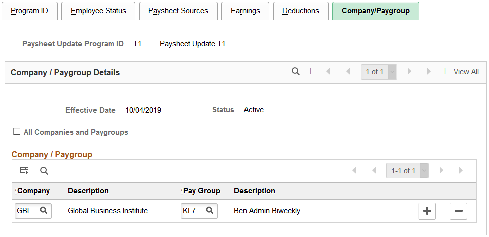

Paysheet Update Program - Company/Paygroup Page
PSHUP_COMPANY_DEFN
Associate paysheet update programs with companies and pay groups for inactive employees.

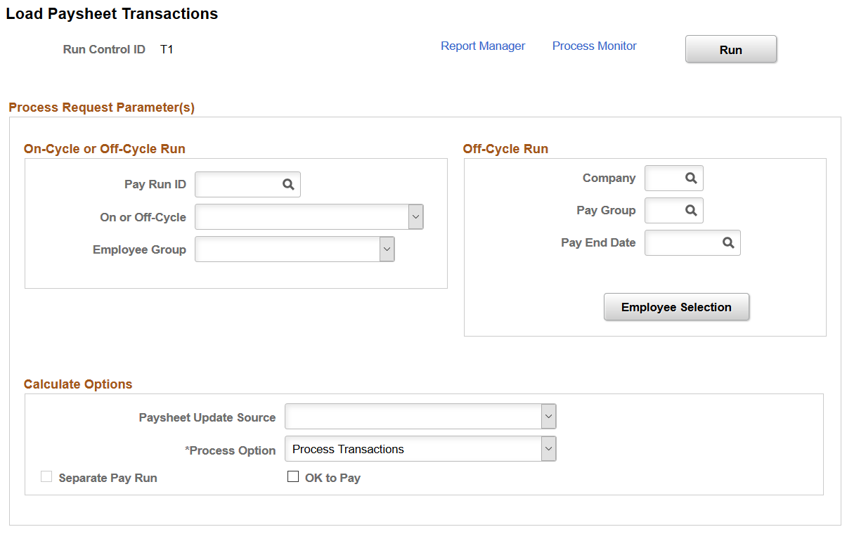

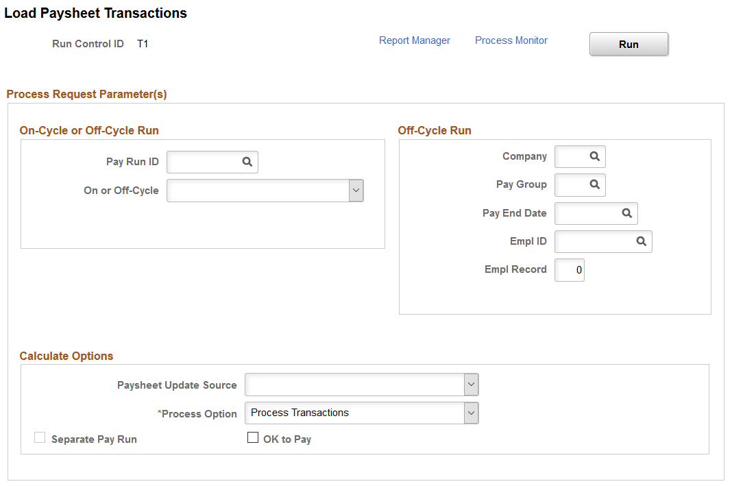

Load Paysheet Transactions Page
RUNCTL_PSHUP
Run the Load Paysheets (PYLOAD) process that loads transaction data into paysheets or resets transaction statuses before reloading data into paysheets.

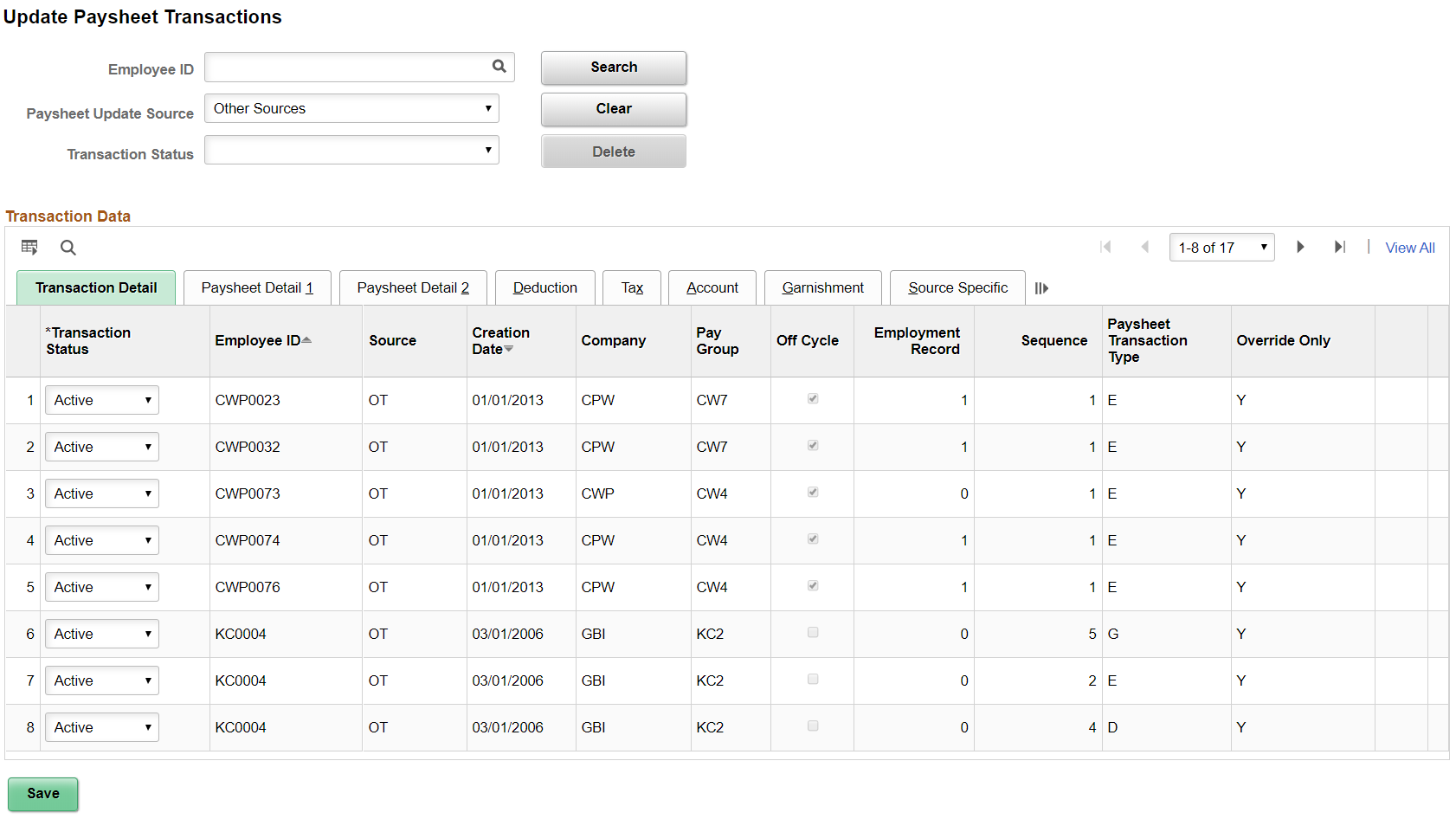

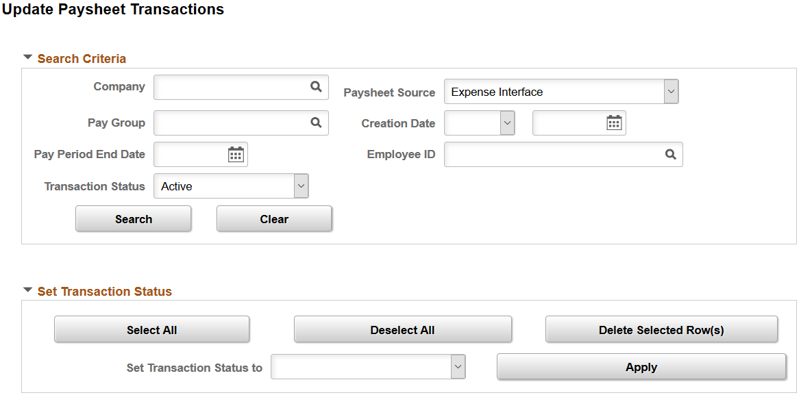

Update Paysheet Transactions Page
PY_PSHUP_TXN
Review transaction data from the PSHUP_TXN record and optionally update transactions before loading them into paysheets.

On-Cycle and Off-Cycle Processing
When you enter parameters to run the Load Paysheets process, you specify whether you are loading on-cycle or off-cycle data.
When you load data from rapid entry paysheets, the choice of on-cycle or off-cycle controls which transaction rows are loaded. For example, if you choose to load rapid entry paysheets for on-cycle transactions, then only on-cycle transactions are loaded. If you choose to load rapid entry paysheets for off-cycle transactions, then only off-cycle transactions are loaded.
For all other sources, the transactions do not have their own on-cycle or off-cycle designation, so all transactions for that source are loaded, and they become on-cycle or off-cycle according to the parameters you selected on the Load Paysheet Transactions Page.

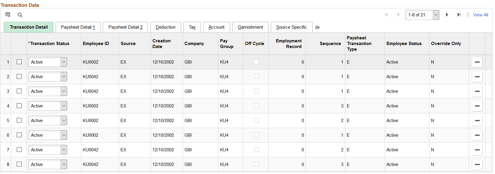

Reviewing and Inactivating Transactions
You can review transaction data that is available from the PSHUP_TXN record on the Update Paysheet Transactions Page. When you review active transactions (transactions that have not been loaded into paysheets), you can manually exclude or inactivate transactions to prevent them from being picked up and loaded by the process. The system updates the PSHUP_TXN record with the new status and with an indicator that the status has been manually changed.
You can only activate transactions that were manually excluded or inactivated.
Resetting Transactions
The Reset Transactions process option on the Load Paysheet Transactions page performs differently for rapid entry paysheets than for other transaction sources:
  • Rapid entry paysheets.
    The Reset Transactions process option resets rapid entry paysheet transactions to Active, and then re-creates the paysheets.
  • Transaction sources other than rapid entry paysheets.
    In the event of a pay unsheet, use the Reset Transactions process option to reset transactions to Active, then run the Load Paysheets process again.
    Note: If you want to reload transactions from sources other than rapid entry paysheets, in addition to running the reset transactions process, you must either unsheet the pay run or remove the previously loaded transactions from the paysheets. If you reset the transactions but do not delete the previously loaded transactions from the paysheets, the system views the reloaded transactions as duplicates and will not process the load.

    • One or more earnings codes for which eligible employees get paid. Transactions that contain any of these earnings codes and originate from any of the matching sources for employees with matching inactive employee statuses will be considered by the Load Paysheets process.
      See Paysheet Update Program - Earnings Page.
    • One or more deduction codes (for example, garnishments, medical premium) for which eligible employees are responsible. Transactions that contain any of these deduction codes and originate from any of the matching sources for employees with matching inactive employee statuses will be considered by the Load Paysheets process.
      See Paysheet Update Program - Deductions Page.
    • Company and paygroup combinations to which these paysheet update program rules apply.
      See Paysheet Update Program - Company/Paygroup Page.

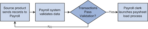

This diagram illustrates how data is loaded into the payroll system and validated:
Image: Illustration of how payroll data is loaded into the system and validated before the payroll clerk launches the paysheet load process
This diagram illustrates how data is loaded into the payroll system and validated.

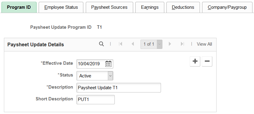

Use the Paysheet Update Program - Program ID page (PSHUP_PROG_DEFN) to define general information of paysheet update programs for inactive employees.
Image: Paysheet Update Program - Program ID Page
This example illustrates the fields and controls on the Paysheet Update Program - Program ID page.
Enter the basic information of paysheet update programs, for example, the effective date, status, and description.
A paysheet update program consists of rules that are used by the Load Paysheets process to select and load transaction data into paysheets (or reset transaction statuses) for inactive employees. In the paysheet update program setup, you specify:

Use the Paysheet Update Program - Employee Status page (PSHUP_EMPL_ST_DEFN) to specify employee statuses used for loading paysheet transactions for inactive employees.
Image: Paysheet Update Program - Employee Status Page
This example illustrates the fields and controls on the Paysheet Update Program - Employee Status page.
Field or Control
Definition
Employee Status
Enter at least one inactive employee status.
Paysheet transactions for inactive employees that belong to statuses specified on this page will be considered by the Load Paysheets process.

Use the Paysheet Update Program - Earnings page (PSHUP_ERNS_DEFN) to specify earnings codes used for loading paysheet transactions for inactive employees.
Image: Paysheet Update Program - Earnings Page
This example illustrates the fields and controls on the Paysheet Update Program - Earnings page.
Field or Control
Definition
All Earnings
Click this option for the system to select and process paysheet transactions that contain any earnings and originate from any of the matching sources for employees with matching inactive statuses.
When selected, the Earnings section is unavailable for edit.
Earnings Code
Specify at least one earnings code to be paid to inactive employees, if the all option does not apply.

Plan Type and Deduction Code
Specify at least one plan type and deduction code combination, if the all option is not applicable.
Use the Paysheet Update Program - Company/Paygroup page (PSHUP_COMPANY_DEFN) to associate paysheet update programs with companies and pay groups for inactive employees.
Image: Paysheet Update Program - Company/Paygroup Page
This example illustrates the fields and controls on the Paysheet Update Program - Company/Paygroup page.
Field or Control
Definition
All Companies and Paygroups
Click this option if you wish to use this paysheet update program for all companies and paygroups in the system.
When selected, the Company / Paygroup section is unavailable for edit.
Note: You can select this option for only one active paysheet update program.
Company and Pay Group
Specify at least one company and paygroup combination that uses this paysheet update program to process paysheet transactions for inactive employees, if the all option is not applicable.
Note: You can associate any company and paygroup combination with only one active paysheet update program at a time.
Use the Load Paysheet Transactions page (RUNCTL_PSHUP) to run the Load Paysheets (PYLOAD) process that loads transaction data into paysheets or resets transaction statuses before reloading data into paysheets.
Image: Load Paysheet Transactions page with the Paysheet Update for Inactive Employees option Disabled
This example illustrates the fields and controls on the Load Paysheet Transactions page when the option to support the loading of transaction data into paysheets for inactive employees is disabled.
Image: Load Paysheet Transactions page with the Paysheet Update for Inactive Employees option Enabled
This example illustrates the fields and controls on the Load Paysheet Transactions page when the option to support paysheet update for inactive employees is enabled.
Note: The layout of this page is different depending on whether the feature to support paysheet update and loading for inactive employees is enabled.
If the Inactive Employees option for Paysheet Update is selected on the Payroll for NA Installation Page, additional fields and options become available to support the feature.
On-Cycle or Off-Cycle Run
Use this group box or the Off-Cycle Run group box to the right to specify which transactions you want to load into paysheets or reset transaction statuses. For on-cycle runs, you must use the On-Cycle or Off-Cycle Run group box; for off-cycle runs, use this group box if you want to process data for employees in batch by pay run ID.
Field or Control
Definition
Pay Run ID
Select the pay run ID that identifies the pay calendars for which you want to load data. The system loads data for employees in the companies and pay groups represented by the pay run ID.
On or Off-Cycle
Your selection here performs differently depending on whether you're loading rapid entry paysheet transactions or transactions from other sources.
See Understanding the Load Paysheets Process (PYLOAD).
Employee Group
Specify whether to load data into paysheets for active employees or inactive employees for the selected pay run ID and cycle type. Leave this field blank to include both active and inactive employees in the Load Paysheets process.
This field appears if the Inactive Employees option is selected on the Payroll for NA Installation Page.
Off-Cycle Run
For off-cycle runs, use this group box if you want to load data or reset transaction statuses for individual employees. If you complete the fields in this group box, you cannot use the On-Cycle or Off-Cycle Run group box to the left.
Note: Do not use the fields in this group box when loading data from rapid entry paysheets.
Field or Control
Definition
Select the company and pay group of the employees to be selected.
Pay End Date
Select the pay end date through which you want to retrieve data for the employee. The date that you select in this field appears as the pay end date on the paysheet.
Empl ID (employee ID)
Enter the ID of the employee for whom to load data for the off-cycle run. Only active employees are available for selection. (You must complete the Company, Pay Group and Pay End Date fields before you can enter the employee ID).
This field appears if the Inactive Employees option is deselected on the Payroll for NA Installation Page.
Empl Record (employee record number)
Enter the employee's record number. (You must fill out the Empl ID field before you can enter the employee record number).
Employee Selection
Click to access the Employee Selection Details modal page (PSHUP_RNCL_EMP_SEC) and select one or more employees and their employee records to load data for the off-cycle run.
You must complete the Company, Pay Group and Pay End Date fields before selecting employees.
Calculate Options
Field or Control
Definition
Paysheet Update Source
Select the source of the transaction data to be included in the Load Paysheets process. These sources are available:
  • Absence Management: Load absence data from Absence Management.
  • Bonus from Fusion: Load bonus data from Oracle Fusion applications.
  • Expense Interface: Load expense data from Expenses.
    When you select Expense Interface, the Separate Pay Run check box becomes available.
  • Other Sources: Load data from third-party applications.
    See Data Input Requirements for Third-Party Paysheet Data.
  • Rapid Paysheets: Load data from rapid entry paysheets.
    Note: This option is not supported in the Load Paysheets process for inactive employees.
  • Recruiting Interface: Load award data from Employee Referral Programs in PeopleSoft HCM.
  • SIM Interface: This option is no longer supported.
  • Stock Admin - ESPP Refunds (stock administration - employee stock purchase plan refunds): This option is no longer supported.
  • Stock Admin - Options & ESPP (stock administration - options and employee stock purchase plan): This option is no longer supported.
  • Variable Compensation: Load data from the Manage Variable Compensation business process of PeopleSoft HCM.
  • What If: This option is no longer supported.
  • Lifetime Balance Payout USF: Load lifetime balances to paysheet for termination payouts.
Note: Leave this field blank to load data from all sources except Rapid Paysheets, Variable Compensation, and Other Sources (including any custom sources that you define with O% source codes). These types of transactions must always be loaded separately.
Process Option
Select how to process the transaction data. Valid values are:
  • Process Transactions: Select this option for the Load Paysheets process to load data into paysheets. The process also creates paysheets prior to the data load if needed.
  • Reset Transactions: Select this option for the Load Paysheets process to reset the status of transactions to Active so that they can be loaded into paysheets again.
    For rapid entry paysheets, this option re-creates the paysheets after changing the status. For other transaction sources, you must either unsheet the pay run or remove the previously loaded transactions from the paysheets in addition to resetting the status.
Separate Pay Run
If you select Expense Interface or Variable Compensation as the paysheet update source, and you're running an off-cycle process, select this check box to create a separate pay run for expense or variable compensation payments.
OK to Pay
Select if you want the Load Paysheets process to automatically mark the paysheets as OK to Pay. The Pay Calculation process processes only those transactions that are marked OK to Pay.
Leave this check box deselected to review the paysheets and manually mark them OK to Pay.
Use the Update Paysheet Transactions page (PY_PSHUP_TXN) to review transaction data from the PSHUP_TXN record and optionally update transactions before loading them into paysheets.
Image: Update Paysheet Transactions page with the Paysheet Update for Inactive Employees option Disabled
This example illustrates the fields and controls on the Update Paysheet Transactions page when the option to support the loading of transaction data into paysheets for inactive employees is disabled.
Image: Update Paysheet Transactions page with the Paysheet Update for Inactive Employees Enabled (1 of 2)
This example illustrates the fields and controls on the Update Paysheet Transactions page when the option to support the loading of transaction data into paysheets for inactive employees is enabled (1 of 2).
Image: Update Paysheet Transactions page with the Paysheet Update for Inactive Employees Enabled (2 of 2)
This example illustrates the fields and controls on the Update Paysheet Transactions page when the option to support the loading of transaction data into paysheets for inactive employees is enabled (2 of 2).
Note: The layout of this page is different depending on whether the feature to support paysheet update and loading for inactive employees is enabled. If the Inactive Employees option for Paysheet Update is selected on the Payroll for NA Installation Page, additional fields and options become available to support the feature.
If you have previously run the Load Paysheets process to either load transaction data into paysheets or reset transaction statuses, you can review the result of the process on this page. You can also update transaction statuses manually and delete transaction rows.
Page Elements for Filtering Transactions
Note: This section appears if the Inactive Employees option is deselected on the Payroll for NA Installation Page.
To populate the Transaction Data grid, search for transactions for any combination of employee ID, paysheet update source, and transaction status.
Field or Control
Definition
Transaction Status
Values are:
Active: Select to search for transactions that are ready to be loaded into paysheets. This is the initial status for transactions when they were first sent from their sources.
Loaded or Inactive: Select to search for transactions that are already loaded into paysheets. These transactions will not be processed by the Load Paysheets process.
The Loaded status appears if the feature to support the Load Paysheets process for inactive employees is applied to the Payroll for North America system, but is not enabled. The Inactive status is shown, if the feature is not applied to the system (in this case, the Inactive Employees option is not available for selection).
Delete
Click to remove transactions that appear in the Transaction Data section. This button is available when Inactive or Loaded only transactions are displayed for a selected source.
Search Criteria
Note: This section appears if the Inactive Employees option is selected on the Payroll for NA Installation Page.
Specify one or more search values to filter transactions to be displayed in the Transaction Data grid.
Field or Control
Definition
Transaction Status
Values are:
Active: Select to search for transactions that are ready to be loaded to paysheets. This is the initial status for transactions when they were first loaded to the staging record from their sources.
Excluded: Select to search for transactions that are inactive temporarily and not to be processed in the Load Paysheets process.
In Progress: Select to search for transactions that are in the Load Paysheets process. When the process selects transactions to work on based on the run control parameters, it changes their status to In Progress. Transactions will be in this status until the completion of the Load Paysheets process.
Loaded: Select to search for transactions that were loaded successfully into paysheets. The Loaded status is reserved only for use by the Load Paysheets process; transactions cannot be manually updated to this status.
Manually Paid: Select to search for transactions that were added manually into paysheets. The Manually Paid status is used for audit purposes only. Transactions in this status are not processed in the Load Paysheets process.
Rejected: Select to search for transactions that did not match the paysheet update program rules and therefore could not be loaded into paysheets.
Set Transaction Status
Use options in this section to update transactions in bulk, if needed.
Field or Control
Definition
Select All or Deselect All
Click Select All to select all transactions in the Transaction Data grid.
Click Deselect All to deselect all transactions in the Transaction Data grid.
Deleted Selected Rows
Click to delete one or more selected transactions permanently from the Transaction Data grid.
Set Transaction Status To
Select the new status to which selected transactions will be updated. Values are:
Active: Select for transactions to be picked up by the Load Paysheets process.
Exclude: Select for transactions not to be picked up by the Load Paysheets process.
Manually Paid: Select to indicate that transactions were added into paysheets manually, and not to be picked up by the Load Paysheets process.
Apply
Click to update selected transactions with the new status and save the change.
Transaction Data
This grid displays complete data from the PSHUP_TXN record so that you can review the data and optionally update its status.
Field or Control
Definition
Transaction Status
Displays the current status of the transaction. Select a new status for the transaction to update to, if needed.
When you change the status of a transaction, the system updates the PSHUP_TXN record with the new status and with an indicator that the status has been manually changed (by setting the Y value in the PU_TXN_MANUAL_CHG field for that transaction).
Note: (Applicable if the Inactive Employees option is deselected) Because transactions can be set to Inactive or Loaded by the system when the Load Paysheets process completes, you can only change transaction status from Inactive or Loaded back to Active, if the PU_TXN_MANUAL_CHG field indicator has a Y (yes) value.
Paysheet Transaction Type
Displays the type of the paysheet transaction. Valid values are:
  • C: Canadian tax override.
  • D: Deduction override (benefit or general deduction overrides, excluding garnishments).
  • E: Earnings.
  • O: Override. This type is not applicable if the source of the transaction is OT (Other).
  • S: Garnishment override.
  • T: U.S. tax override.
  • G: Total gross.
  • N: Net pay.

Select the status of the transactions to be included in the report. Leave the field value blank to include all statuses.
For example, select Active to view the list of transactions that have not yet been and are going to be loaded into paysheets when the Load Paysheets process runs.
(If the Inactive Employees option is selected) Valid values are:
Active
Exclude
Loaded
Manually Paid
Rejected
(If the Inactive Employees option is deselected) Valid values are:
Active
Inactive.
Active or Inactive Employees
Select if you wish to see transactions of Active or Inactive employees to be included in the report. Leave the field value blank to include both types of employees.
