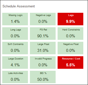

The Schedule Assessment section of the Schedule Health page helps you assess if the underlying schedule has been planned right. These metrics are built based on the the 14 point industry best-practices, DCMA health check. Metrics that do not comply with the thresholds set by your organization in the administration application CIC display in red.
Select the non-compliant metric, such as Lags in the above example, to further investigate the associated activities on the Schedule Assessment PageSchedule Assessment Page.
Note: Use the filters in the Filters pane to see how different parameters affect the schedule in the current page view. To apply these parameters as thresholds for all projects , contact your CIC administrator to make these changes in the CIC Administration application. To modify or change the thresholds, navigate to the Schedule Assessment PageSchedule Assessment Page.
