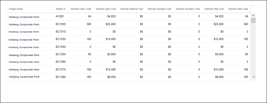

Project Metrics Table
The Project Metrics table on the Benchmarking Details page displays the metric information for your ongoing project, and the benchmark groups. The information in the table can also be customized if you choose to apply any filters in the Filters pane.
The following information is displayed in the table:
- Project Name: The name of project.
- Activity ID: The unique identifier of the activity.
- Planned Labor Units: The planned number of units for all labor resources assigned to the activity.
- Planned Labor Cost: The planned costs for all labor resources assigned to the activity.
- Planned Material Cost: The planned cost for all material resources assigned to the activity, project, or EPS.
- Planned Nonlabor Cost: The planned costs for all non labor resources associated with the project or EPS.
- Planned Nonlabor Units: The planned units for all non labor resources assigned to the activities in the project.
- Planned Total Cost: The planned cost for all expenses associated with the activity, project, or EPS.
- Planned Total Units: The planned number of units for all resources associated with the activity, project, or EPS.
