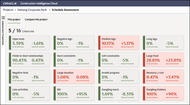

Assessment Criteria for Your Project
In This project tab, the quality of your project schedule is assessed against 16 DCMA criteria. The criteria are sorted in the descending order to display those criteria with the greatest deviation from their respective threshold values.
The following information displays for each criteria:
- the percentage of activities that contribute towards each criteria. For example, 10.17% of all activities contribute towards the Positive Lags metric.
- the extent of deviation from the set threshold level of each criteria. For example, +5.17% above the threshold of the Positive Lags metric.
- The tile color indicates compliance (green) or non-compliance (red) of each assessment criteria.
Note: You can change the threshold levels for the DCMA critera in the filter panel and click Apply to review the impact on the projects being compared in this tab. To permanently modify the threshold values for a criteria, contact your CIC Administrator.

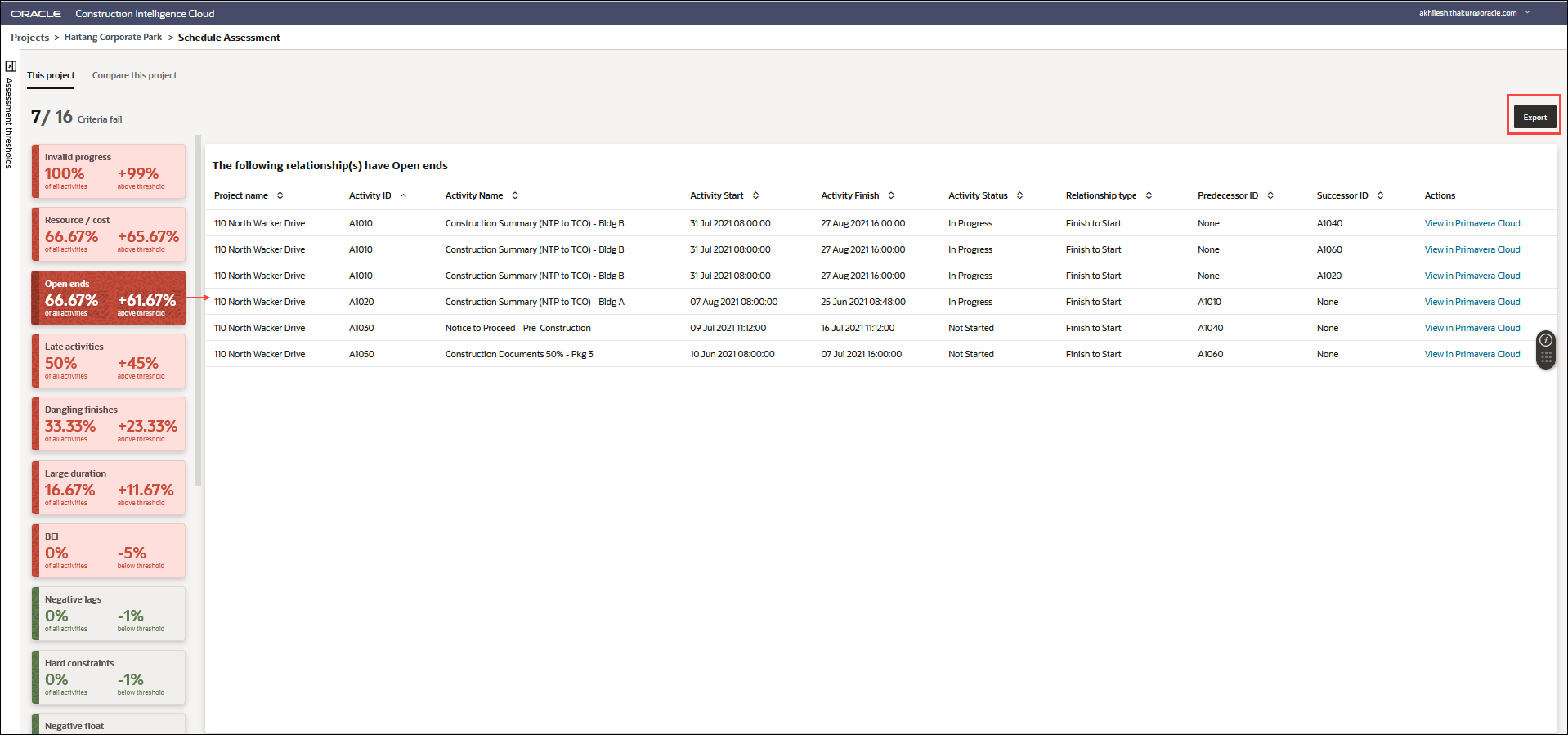

To further analyze your project schedule, you can perform any of the following actions:
- Click on a tile to generate a list of non-compliant activities that are contributing towards that specific assessment criteria
- Click Export to export the list of non-compliant activities to an Excel spreadsheet for offline processing.
Depending on the assessment criteria you select, the following details may display:

- Actions: Depending on where your project data resides, click the link to view the activity in P6 EPPM or Primavera Cloud.
Select the Export link to export data into the following file formats: PDF, Excel 2007+, Powerpoint 2007+, web Archive (.mht) Data (CSV format, Tab delimited Format, or XML format). Upon successful completion, the following confirmation message displays: The Export process is complete.
