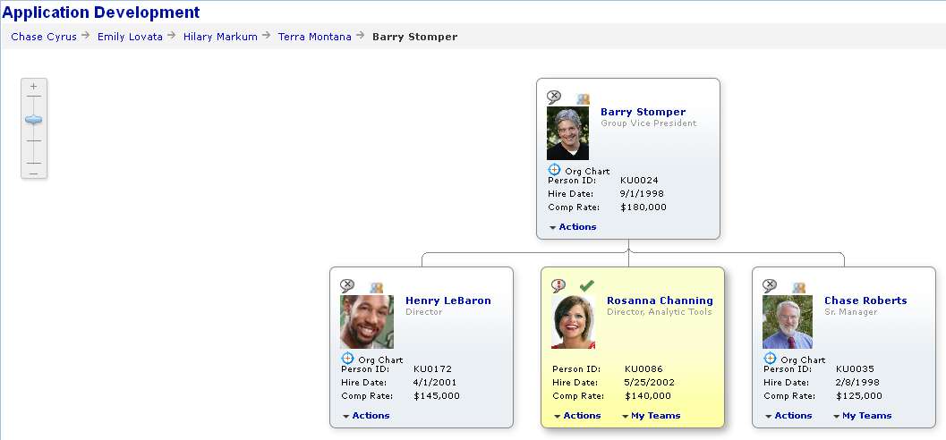

A PeopleSoft organization chart consists of two parts: the main hierarchical chart and pop-ups that enable the user to access additional related data for each node.
An organization chart can be oriented vertically or horizontally. Use the Direction to set the orientation of an organization chart.
Image: Vertically oriented organization chart
The following example shows a vertically oriented organization chart:
Image: Horizontally oriented organization chart
The following example shows a horizontally oriented organization chart:

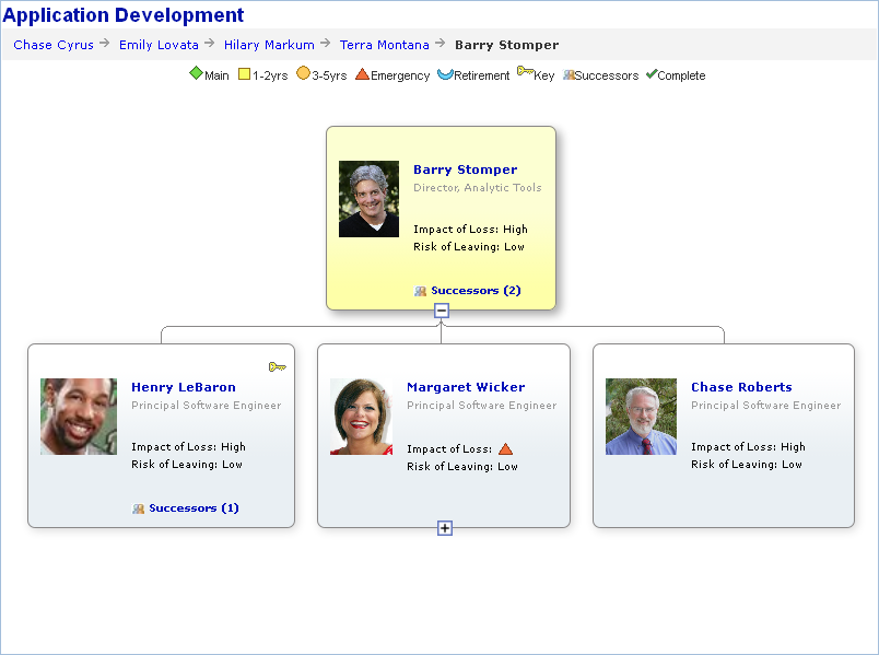

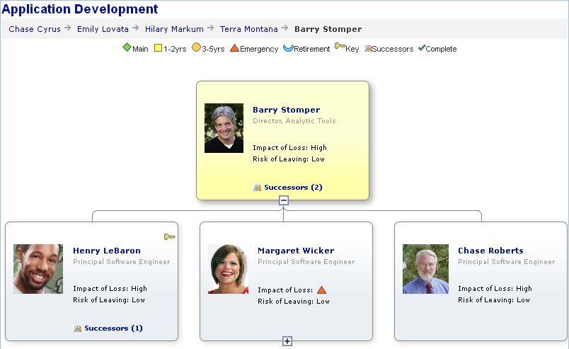

Main Chart
The main chart can have multiple levels. Each level consists of one or more nodes. Each node represents an individual entity, such as an employee, in the organization. A node has one parent node (except the top-level node, which does not have a parent node) and zero, one, or more child nodes. Each node in the main chart has up to 99 descriptors and each descriptor can be configured as a link or as a button associated with a drop-down list box. Application developers can associate FieldChange PeopleCode with each descriptor link or button associated with a linkable drop-down list box.

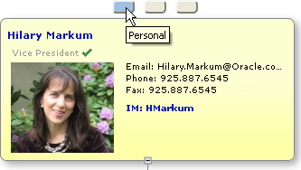

Pop-up Chart
A pop-up displays a pop-up chart with information specifically related to the node from which it was invoked. A connector line visually links the pop-up chart to the predecessor node, the node in the chart from which the pop-up was invoked.
If the pop-up contains more nodes than can be displayed (that is, if MaxPopupDisplayNode is set to a number that is less than the total number of nodes) then a scroll bar appears in the pop-up. In some circumstances when a pop-up has a scroll bar and has more than one level, when a user clicks a link on a level other than the top level the new pop-up may not appear in the display area. If this occurs, the user can scroll down using the scroll bar in the initial pop-up to view the new pop-up node.
Note: The amount of time it takes for a pop-up to appear is proportional to the number of nodes in the pop-up. A pop-up with hundreds of nodes may take a long time to appear. An hourglass appears to let the use know the system is working to retrieve the nodes.
A pop-up is invoked through PeopleCode associated with the FieldChange event for a descriptor link on a main chart node or another pop-up node.
A pop-up consists of a header and one or more nodes with each node having up to eight descriptors. Each descriptor can be configured as a link.
The user can drag-and-drop a pop-up node to reposition it but the new position will not be retained after any action that requires a server trip that reloads the chart.

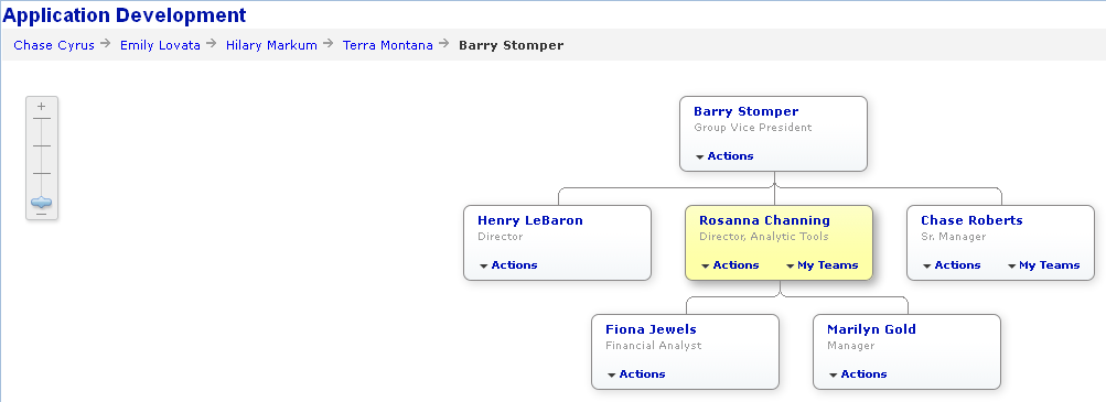

Implement zooming (optional).
Configure connector lines and borders.

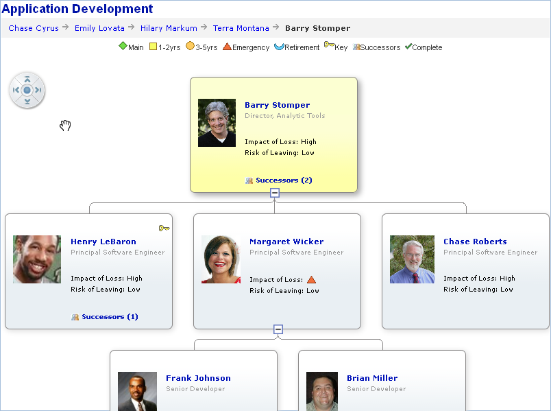

You can configure an organization chart to display breadcrumbs. Typically, breadcrumbs display the names of people in an organization hierarchy.
Image: Organization chart with breadcrumbs
The following example shows an organization chart with breadcrumbs:
An organization chart can have only one set of breadcrumbs. The breadcrumbs appear horizontally at the top of an organization chart, above the chart legend if the legend is set. The breadcrumbs string wraps automatically if it is wider than the organization chart. If a breadcrumb contains a space, the breadcrumb string may wrap at the space, causing the breadcrumb to appear on two lines.
Style classes control the formatting of breadcrumbs. The default style classes are PT_ORGCHART_BRDCRM and PT_ORGCHART_UNLINK_BRDCRM. You can specify your own style classes using the CrumbDescrStyle and UnlinkCrumbDescrStyle properties.
You can specify an image to separate breadcrumb entries. If an image is not specified, the breadcrumbs are separated by three spaces. Each breadcrumb entry can be configured to be linkable. This configuration is similar to linkable text on organization chart nodes.

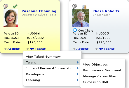

You can configure an organization chart to include menus and drop-down lists for any of the node descriptors.
Understanding Menus and Drop-Down Lists
This section discusses the following types of drop-downs:
Related action menu.
Drop-down menu.
Drop-down list box.
Related Action Menu
A related action menu is dynamically generated based on a related service configuration that has been defined in the PeopleSoft Related Content Framework. Related action links in the menu take the user directly to the target, using related values supplied by the node. Because the menu structure and links are defined by the related service configuration, the developer does not need to populate the drop-down rowset or to write PeopleCode for related action drop-down menus. You do need to verify that the related action services mapping page fields are included in the node record.
Image: Example of a related action drop-down menu
The following example shows a node configured with a related action menu.
Drop-Down Menu
A drop-down menu presents list items in a folder menu structure.
Drop-down menus can contain folders and menu items. Folders can be nested.
A drop-down menu can be linkable or read-only. If the drop-down menu is linkable, FieldChange PeopleCode associated with the descriptor field PTNDDESCnLINKABLE executes when a user clicks on a menu item. If the drop-down menu is read-only, FieldChange PeopleCode does not execute.
Image: Example of a linkable drop-down menu
The following example shows a node configured with a drop-down menu.

A drop-down list box presents a list of linkable items.
Image: Example of a linkable drop-down list box
The following example shows a node with a drop-down list box.
The width of a drop-down list box is the width of the widest list item that the box contains.
A related action menu is dynamically rendered based on related content configuration that is mapped to the level 1 chart node record field PTCHART_NODE on the chart page. The services that make up the related content configuration are rendered as links on the related actions menu. The related content layout defines the hierarchical structure of the related actions menu. A related content menu consists of folders and menu items. Folders can be nested.
Important! SmartNavigation has been deprecated. This information remains for backward compatibility only.
An Actions folder can also be configured to display in drop-down SmartNavigation menus (that is, the portal breadcrumb menu). The Actions folder displays depending on the configuration of related actions for SmartNavigation. If the related actions are attached at the chart component level, the Actions folder will not appear in the drown down menu. If the related actions are attached to the data source’s detail component, the Actions folder will appear in the drop down menu.
Related content services are defined using the Define Related Content Service component. Then, related actions are assigned using the Manage Related Content Service component. Both components are part of the PeopleSoft Related Content Framework.
See Creating and Managing Related Content Service Definitions and Configuring Related Content, Related Actions, and Menu and Frame Layouts.
To configure a descriptor as a related action menu, set the corresponding PTNDDESCnLINKABLE value to "A". Using the Manage Related Content Service component, associate the related actions as page level related content to the chart node record field PTCHART_NODE on the chart page at level 1.
For each drop-down, add the fields PTDESCRn_DD_ID and PTDESCRn_SI_ID to your node data record, where n represents the number of the descriptor. For example, to configure PTNODE_DESCR7 as a drop-down, add the fields PTDESCR7_DD_ID and PTDESCR7_SI_ID. Add one set of PTDESCRn_DD_ID and PTDESCRn_SI_ID for each descriptor you configure as a drop-down (PTNDDESCnLINKABLE="D", "R", or "L").
You will populate PTDESCRn_DD_ID with a unique identifier for the drop-down.
When the user clicks on a list item in the drop-down, the system sets the PTDESCRn_SI_ID field to the value of the list item ID, making it available for use by FieldChange PeopleCode.
Configuring the Node Record Without a Display Template
Oracle recommends using a display template to configure your organization chart. Organization charts created with PeopleTools version 8.51 do not use display templates. If your organization chart does not use a display template, you need to configure the node record differently.
Add the fields in the PTORGBOXFLD_SBR subrecord to your node record. The subrecord contains the fields PTDESCRn_DROPDOWN_ID and PTDESn_SLCT_ITM_ID, where n is an integer from 1 to 7, for example PTDESCR1_DROPDOWN_ID and PTDES1_SLCT_ITM_ID, and so on.
You will populate PTDESCRn_DROPDOWN_ID with a unique identifier for the drop-down.
See “PTORGBOXFLD_SBR” in Organization Chart Subrecord Definitions.
To configure a descriptor as a drop-down menu or drop-down list box:
Set the PTNDDESCnLINKABLE field to “D” for a linkable drop-down menu.
Set the field to “R” for a read-only (non-linkable) drop-down menu.
Set the field to “L” for a linkable drop-down list box.
Populate the PTDESCRn_DD_ID field (or the PTDESCRn_DROPDOWN_ID if your chart does not use a display template) with the drop-down ID.
Create a derived/work record that contains the fields in the subrecord PTORGBOXLST_SBR.
Add PeopleCode to set the drop-down data record and the drop-down rowset.
For example:
&ocPBOrg.SetDropDownRecord(Record.DropDown); &ocPBOrg.SetDropDownData(&rsDropDown);Populate the drop-down data rowset with the list information for each of the drop-down list IDs.
Place FieldChange PeopleCode on the PTNODE_DESCRn field to perform corresponding logic when a list item is selected in a linkable drop-down.
The drop-down rowset defines the content for drop-down list boxes and defines the menu structure as well as the content for drop-down menus.
Populate the drop-down ID field (PTDESCRn_DD_ID using a display template, or PTDESCRn_DROPDOWN_ID if not using a display template) on the node record with a unique identifier, such as EMPL.
Populate the drop-down data rowset according to these rules:
Each list item in the menu is either a folder or a menu item.
Assign a unique value in PTORGDRPLSTITM_ID for each item.
Populate PTNODE LISTDESCR with a label for each item.
Folders have children.
Menu items have no children.
Determine the parent for each item. This is the group ID.
Set PTORGDRPLS_ GRP_ID to the parent ID, PTORG DRPLSTITM_ID.
Top-level list items have no parent. Set the group ID to blank.
Drop-down list box items have no parent. Set the group ID to blank.
Determine the display order of each list item within its group.

Node View Controller
The node view controller appears in the top part of the chart above the nodes but below any chart breadcrumbs or legend. The node view controller is made up of push buttons without text where each button represents a view. A data hint is used to provide the text description of the view.
Image: Node view controller with a data hint
The node view controller in this example displays the “Personal” node view data hint:

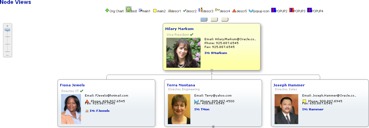

Creating Node Views
To set up the node view controller to enable node views, use the following two organization chart methods:
&oOrgChart.SetNodeViewEntries(&NodeViewArray);
&oOrgChart.SetNodeViewText(&NodeViewText);
NodeViewArray represents an array of node view IDs. NodeViewText is an array of data hints for each corresponding node view ID.
Additionally, the organization chart property, InitialView, must be set to indicate which view is initially displayed in the chart. For example, the property might be set as follows to show the view that is labeled “Personal.”
&OrgChart.InitialView="VIEW1";
Image: Organization chart with three node views
The following example shows an organization chart with three node views defined:
Transitioning between node views will be done without a server trip. Therefore, it’s not possible to have a field change event when changing between views. Also, once the user navigates away from the chart or the chart is refreshed, the current view state is not saved. Therefore, the chart will always show the initial view set in the chart property whenever the chart is viewed again.

Image: Example of an organization chart displaying schema level 3
The following example shows an organization chart with a zoom control and four schemas defined. The chart in this example displays schema level 3.
Image: Example of an organization chart displaying schema level 1
The chart in the following example displays schema level 1, which displays less data on each node, allowing the chart to display more nodes in the same area.

If an organization chart is larger than the viewable area, the user needs to scroll to view other areas of the chart. You can specify whether the organization chart will use scroll bars or alternative scrolling.
Image: Example of an organization chart using alternative scrolling
If you specify alternative scrolling, a scroll navigator and a hand cursor appear instead of vertical and horizontal scroll bars.
Note: On an Apple iPad a user navigates using two fingers on a touch screen, so scroll bars, the scroll navigator, and mouse hand features are not displayed on an Apple iPad.
The arrows on the scroll navigator enable the user to quickly position the right, left, top, or bottom of the chart in the viewable area.
If the user scrolls the chart, the center button of the scroll navigator returns the chart to its initial display position. If the user changes focus by selecting a different node, the chart centers on that node. The center button then returns the chart to display centered on the focus node.
If alternative scrolling is implemented, the user can dismiss a drop-down menu only by clicking within the node areas in the chart unless no scrolling is needed, in which case the user can click on the background or on a node to dismiss the menu.
Note: If the breadcrumbs and chart legend are so large that there is not sufficient room to display the scroll navigator in the upper left portion of the chart, it will appear in the lower left corner.
The hand cursor enables the user to grab the background of the chart and move it within the viewable area.
Note: When using the hand cursor to scroll, you must position the hand cursor in the chart area outside the chart nodes and popup nodes. Scrolling does not work if the hand cursor is positioned within a chart node or pop-up node.
