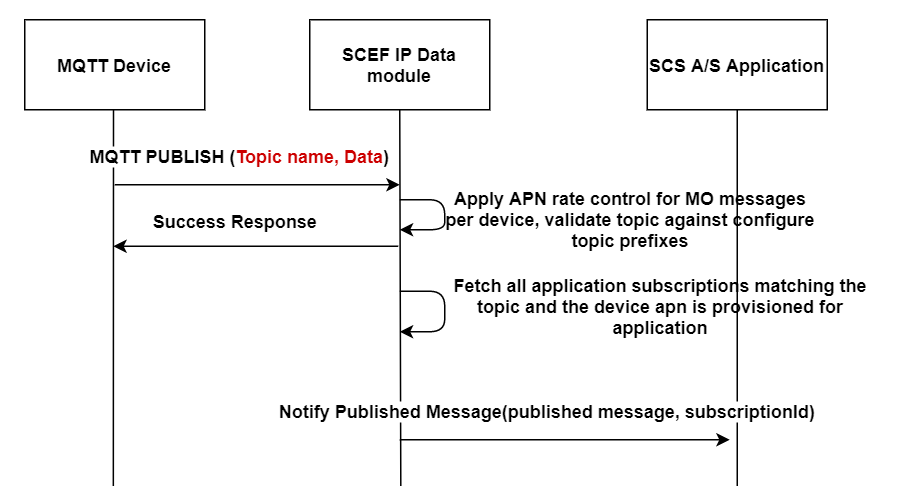

Notifications
The following call flow explains the procedure followed in message notification.
Figure 2-29 Notifications Call Flow

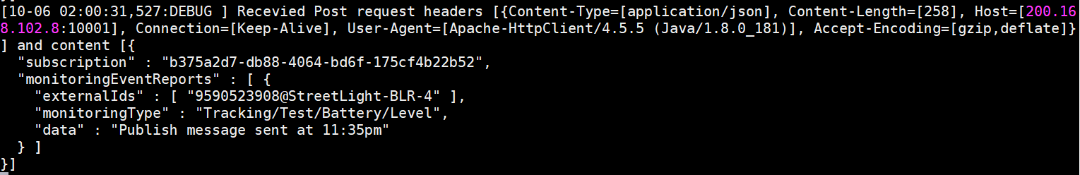

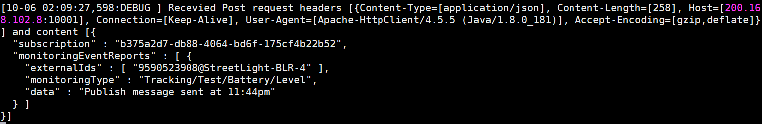

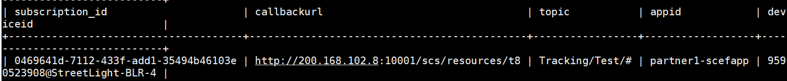

Subscription with device have more priority than the subscription without device, if it is for the same topic. For information, refer to Figure 2-37Example 1
Two subscriptions have been created for the same SCSAS for the same External ID. The first subscription is created for the Tracking/Test/# topic and the second subscription is created for the Tracking/Test/Battery/# topic. Then, Device Published data to Tracking/Test/Battery/Level.
Figure 2-30 Tracking/Test/# for the Same SCSAS
Figure 2-31 Tracking/Test/Battery/# for the Same SCSAS
Figure 2-32 Tracking/Test/Battery/Level Topic for the Same SCSAS

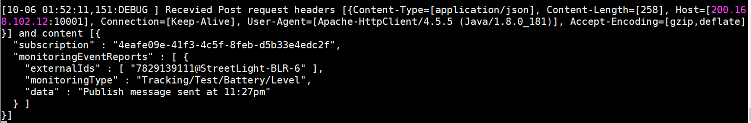

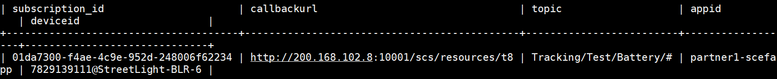

Example 2
Two subscriptions have been created for two different SCSAS for the same External ID and same topic. Then, Device published data to the topic.
The following image displays the entry from table for a subscription created on the Tracking/Test/Battery/# topic:
Figure 2-33 Tracking/Test/Battery/# Topic

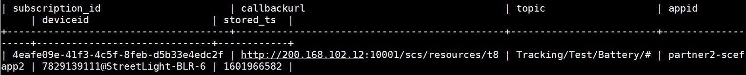

The following image displays the entry from table for a subscription created on the Tracking/Test/Battery/# topic for different SCSAS:
Figure 2-34 Tracking/Test/Battery/# Topic for the Different SCSAS
Figure 2-35 Subscription 1
Figure 2-36 Subscription 2

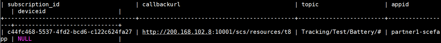

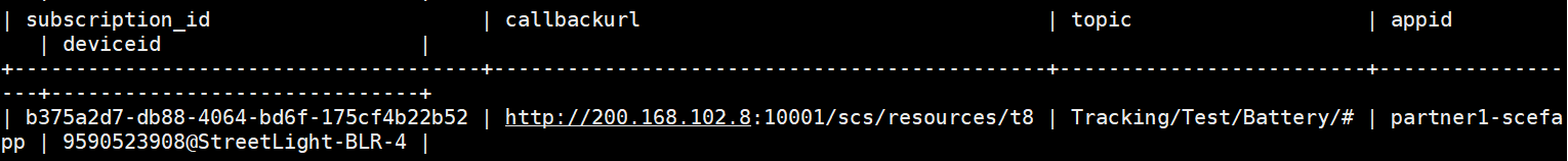

Example 3
Two subscriptions are created. One subscription is with topic for a device, and the other subscription is only for topic.
Figure 2-37 Tracking/Test/Battery Topic with Device
The following image displays the entry from table for a subscription created on the Tracking/Test/Battery/# topic without a device. Ensure that the deviceid is null.
Figure 2-38 Tracking/Test/Battery Topic without Device
The device publishes data to the topic. Notification is sent for the subscription with the device.
