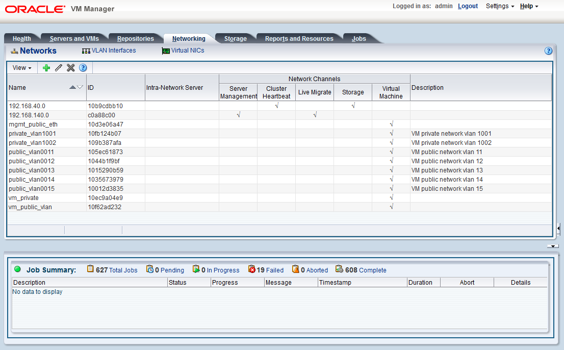

The Networking tab is used to manage networks within the Oracle VM environment running on the Oracle PCA.
By default, a number of networks are defined during factory installation. These must not be altered as they are required for the correct operation of the Oracle PCA software layer.
The default networks are set up as follows:
192.168.140.0: the management networkThis is a private network used exclusively for Oracle VM management traffic. Both management nodes and all compute nodes are connected to this network through their
bond0interface.192.168.40.0: the storage networkThis is a private IPoIB network used exclusively for traffic to and from the ZFS storage appliance. Both management nodes and both storage controllers are connected to this network through their
bond1interface.
Additionally, three networks are listed with the VM Network role:
vm_public_vlanThis default network is the standard choice for virtual machines requiring external network connectivity. It supports both tagged and untagged traffic. For untagged traffic it uses the Oracle VM standard VLAN 1, meaning no additional configuration is required.

mgmt_public_ethThis network is automatically created during the initial configuration of the appliance. It uses the public network that you configured in the Oracle PCA Dashboard. The primary function of this network is to provide access to the management nodes from the data center network, and enable the management nodes to run a number of system services. As long as you have not configured this network with a VLAN tag, it may also be used to provide external untagged network access to virtual machines. The subnet associated with this network is the same as your data center network.
CautionAlways use the
vm_public_vlannetwork as your first VM network option. Themgmt_public_ethis unavailable for VM networking when configured with a management VLAN. When no management VLAN is configured, it is restricted to untagged VM traffic, and should only be considered if the circumstances require it.
For more information about Oracle PCA network configuration, see Section 1.2.4, “Network Infrastructure”.
