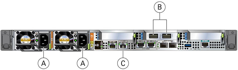

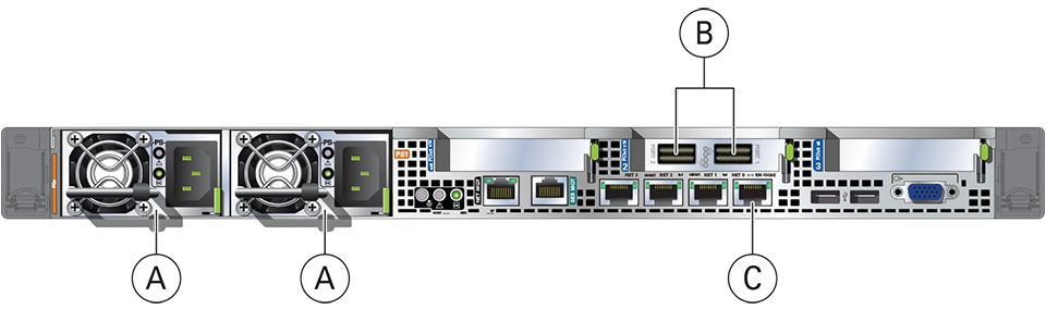

As of Release 2.3.2 the Oracle Private Cloud Appliance Controller Software provides support for Oracle Server X7-2 compute nodes. Their function is identical to that of the Oracle Server X6-2, and you should manipulate them in exactly the same way. However, the front and back panel layout of the new hardware is slightly different.
After installing an Oracle Server X7-2 into the appliance rack, it should be connected using the same pre-installed cables and the equivalent ports on the back of the server. The following two images illustrate the subtle differences between both server models. The letters indicate where the required cables must be connected, and the figure legend below identifies the ports and their purpose.
Table 5.1 Figure Legend
Item | Description |
A | Power supplies |
B | InfiniBand connectors |
C |
