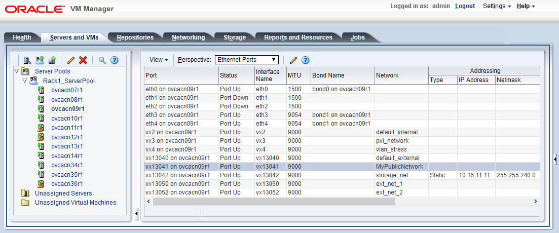

Figure 2.7 shows a custom network named MyPublicNetwork, which is VLAN-capable and uses the compute node's
vx13041interface.To disconnect servers from the custom network use the remove network command.

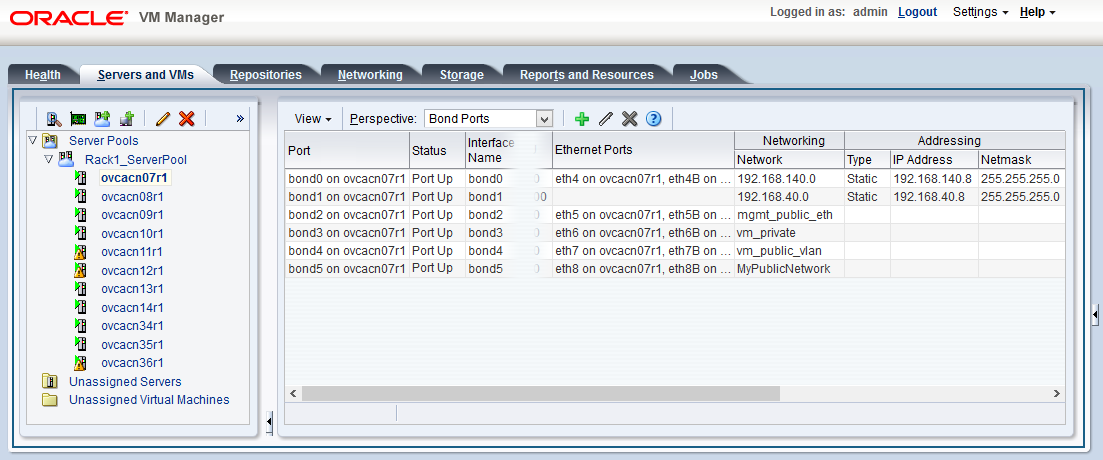

Figure 2.8 shows a custom network named MyPublicNetwork, which is VLAN-enabled and uses the compute node's
bond5interface consisting of Ethernet ports (vNICs)eth8andeth8B.To disconnect servers from the custom network use the remove network command.
