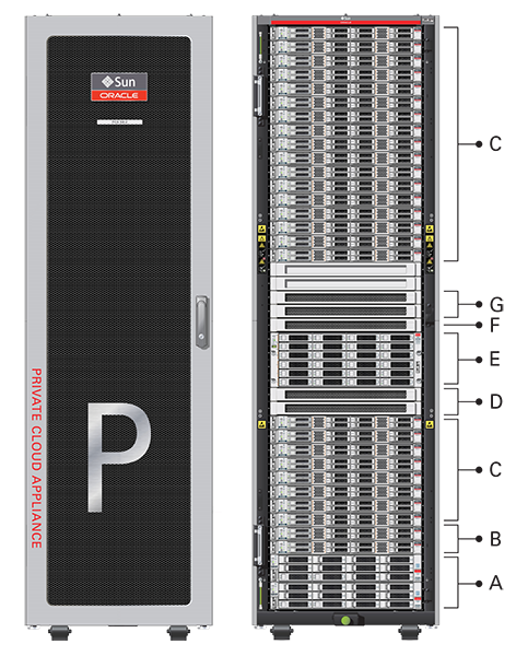

The current Oracle Private Cloud Appliance hardware platform, with factory-installed Controller Software Release 2.4.x, consists of an Oracle Rack Cabinet 1242 base, populated with the hardware components identified in Figure 1.1. Previous generations of hardware components continue to be supported by the latest Controller Software, as described below.
Table 1.1 Figure Legend
Item | Quantity | Description |
A | 2 | Oracle ZFS Storage Appliance ZS7-2 controller server |
B | 2 | Oracle Server X8-2, used as management nodes |
C | 2-25 | Oracle Server X8-2, used as virtualization compute nodes (Due to the power requirements of the Oracle Server X8-2, if the appliance is equipped with 22kVA PDUs, the maximum number of compute nodes is 22. With 15KVA PDUs the maximum is 13 compute nodes.) |
D | 2 | Cisco Nexus 9336C-FX2 Switch, used as leaf/data switches |
E | 1 | Oracle ZFS Storage Appliance ZS7-2 disk shelf |
F | 1 | Cisco Nexus 9348GC-FXP Switch |
G | 2 | Cisco Nexus 9336C-FX2 Switch, used as spine switches |
