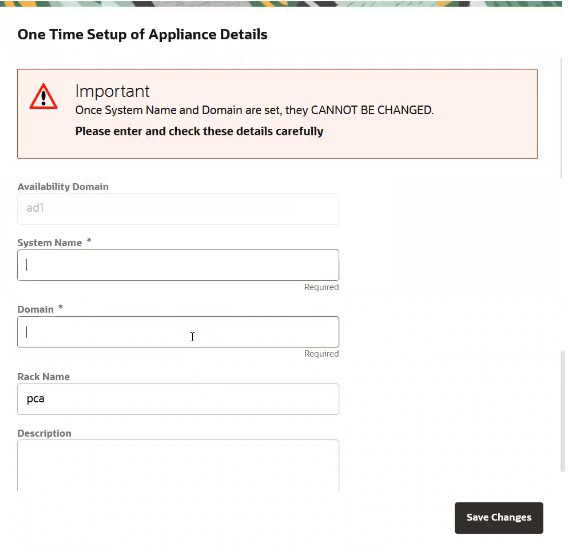

                        Provide the following appliance details. Required entries are marked with an asterisk. -
                              System Name*
                              Domain*
                              Rack Name
                              Description
                        Confirm the parameters you just entered are correct. Once System Name and Domain are set, they cannot be changed. Click Save Changes when you are ready to proceed.

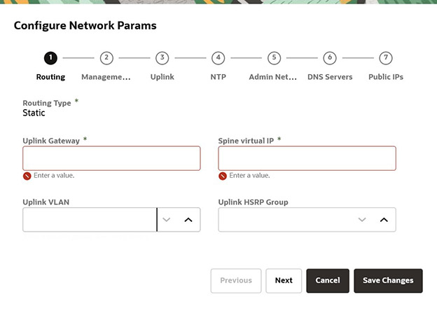

                        Select either static or dynamic routing. For static routing configurations Enter the following data center information, then click Next. -
                              Routing Type: Static*
                              Uplink gateway IP Address*
                              Spine virtual IP* (comma-separated values if using the 4 port dynamic mesh topology)
                              Uplink VLAN
                              Uplink HSRP Group

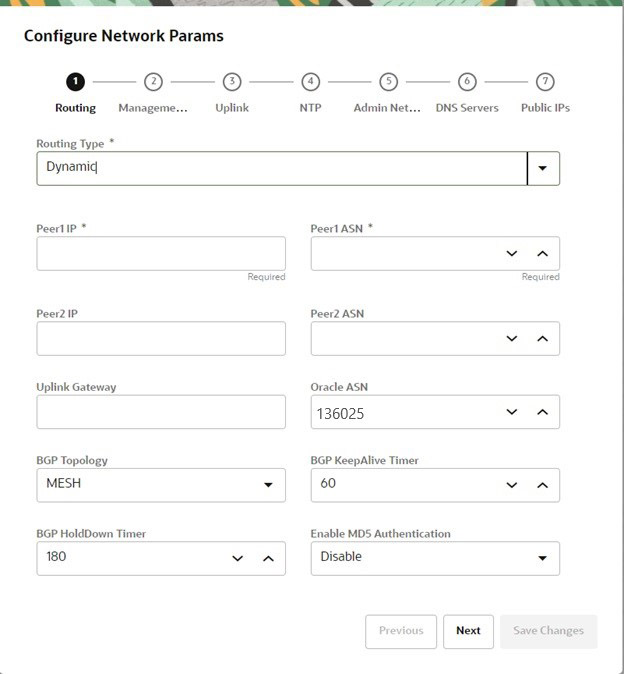

  For dynamic configurations Enter the following data center information, then click Next. -
                              Routing Type: Dynamic*
                              Peer1 IP and ASN*
                              Peer2 IP and ASN
                              Uplink Gateway
                              Oracle ASN
                              BGP Topology (square, mesh, triangle), KeepAlive Timer and HoldDown Timer
                              MD5 Authentication: enable or disable

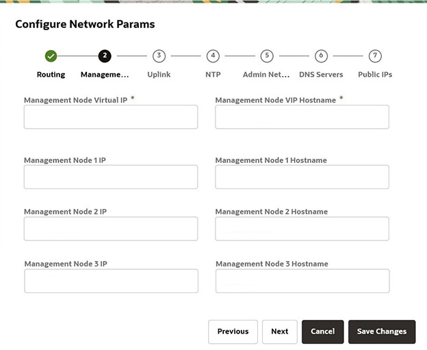

                        Enter a shared virtual IP and associated host name for the management node cluster; add an IP address and host name for each of the three individual management nodes; and then click Next.

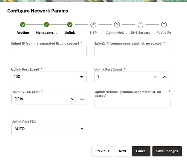

                        Enter the following data center uplink information and then click Next. -
                              IP Address for Spine Switch 1 and 2*
                              Uplink Port Speed and Port Count*
                              Uplink VLAN MTU and Netmask*
                              Uplink Port FEC

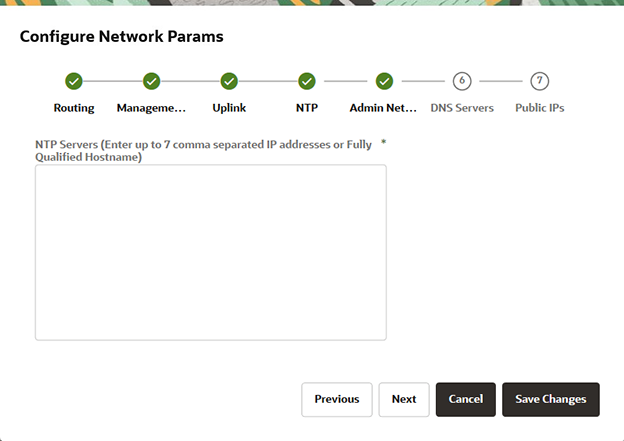

                        Enter the NTP configuration details and then click Next. To specify multiple NTP servers, enter a comma separated list of IP addresses or fully qualified host names.

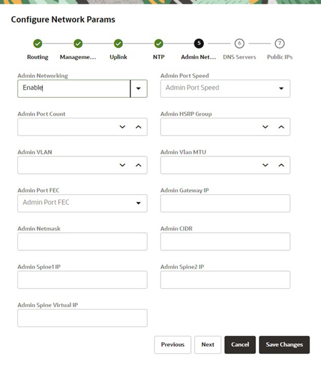

                        If you elected to segregate administrative appliance access from the data traffic, configure the administration network by entering the following information and then click Next. -
                              Enable Admin Networking
                              Admin Port Speed, Port Count, and HSRP Group
                              Admin VLAN, MTU, Port FEC, and Gateway IP
                              Admin Netmask and CIDR
                              Admin IP Address for Spine Switch 1 and 2, and a shared Virtual IP

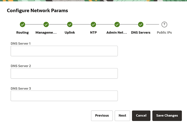

                        Enter up to three DNS servers in the respective fields and then click Next.
