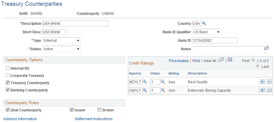

Use the Treasury Counterparties page (BANK_PNL_TR) to establish counterparties.
Navigation:
This example illustrates the fields and controls on the Treasury Counterparties page. You can find definitions for the fields and controls later on this page.
Most of the fields on this page are the same as the fields on the Bank Information page. See the Bank Information Page for more information.

Counterparty Options
Field or Control |
Description |
Corporate Treasury |
Select if a bank is a regional or corporate treasury. This option applies only to internal bank types. Corporate treasury entities have special rights within PeopleSoft Treasury, such as servicing internal accounts. You can designate multiple internal counterparties as a corporate treasury. If you select this check box, you should also specify the general ledger unit with which it is associated. When you select this check box, the system automatically selects the Internal BU check box. |
Counterparty Roles
Select the check boxes that reflect the activities in which this counterparty is involved. Options are: Deal Counterparty, Issuer, or Broker.
