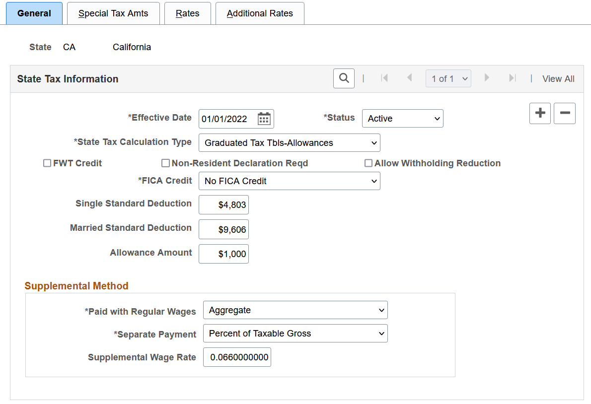

STATE_TAX_TABLE1 |
View standard deductions, allowance amounts, and supplemental rates. |

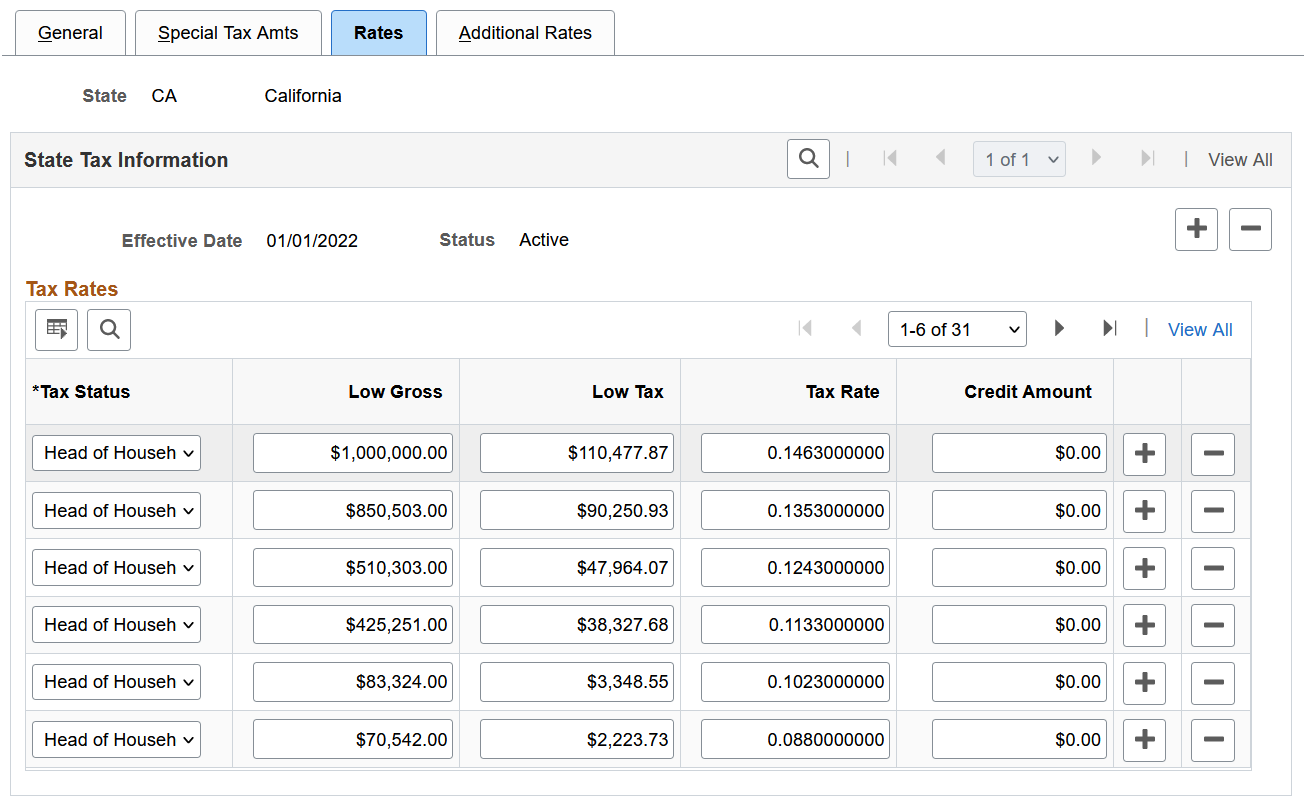

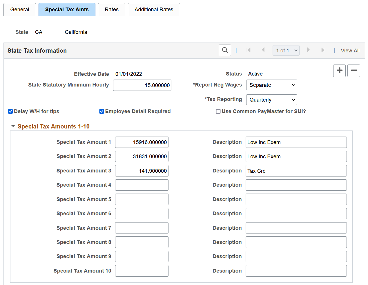

STATE_TAX_TABLE2 |
View information needed for tax calculations. The page for the Federal Tax Table differs from the one for specific states. |

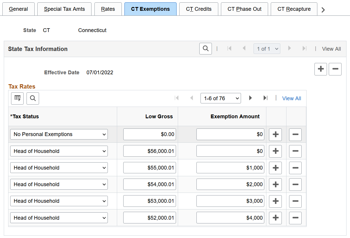

STATE_TAX_TABLE3 |
View wage bracket information. Contains data from Connecticut Table B - Withholding Tax. |
STATE_TAX_TABLE3_A |
(Available only when the state entered is CT.) View the tax status, low gross, and exemption amount, from Connecticut Table A - Exemptions, that are used for calculating Connecticut state tax exemptions. |
CT Credits Page |
STATE_TAX_TABLE3_B |
(Available only when the state entered is CT.) View the tax status, low gross, and credit percent, from Connecticut Table E - Personal Tax Credits, that are used for calculating Connecticut state tax credits. |
CT Phase Out Page |
STATE_TAX_TABLE3_D |
(Available only when the state entered is CT.) View the tax status, low gross, and low tax amount, from Connecticut Table C - 3% Phase-Out, that are used for calculating the phase out of the Connecticut 3% state tax rate. |
CT Recapture Page |
STATE_TAX_TABLE3_E |
(Available only when the state entered is CT.) View the tax status, low gross, and recapture tax amount, from Connecticut Table D - Tax Recapture, that are used for calculating the recapture of Connecticut state taxes from taxpayers over certain income brackets. |

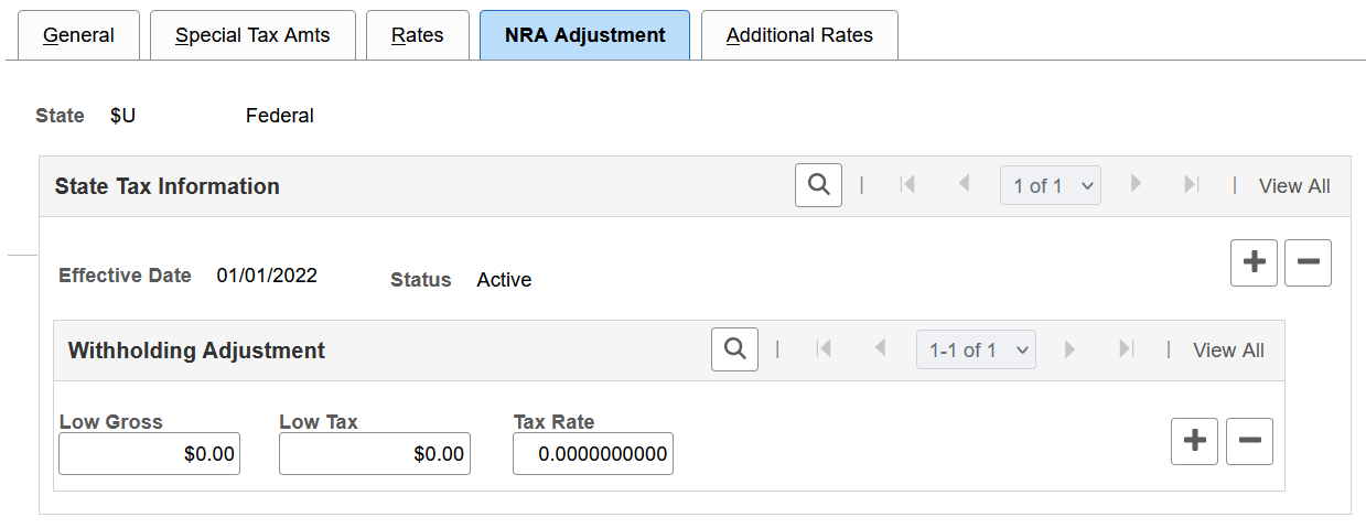

STATE_TAX_TABLE3A |
(Available only when the state entered is Federal, $U.) View the withholding adjustment rate to use for nonresident alien wages. |

Use the Federal/State Tax Table pages to view the tax data that PeopleSoft Payroll for North America uses to calculate U.S. federal, state, and certain local taxes. These pages supply the following information:
Identify the general type of withholding tax calculation employed by each jurisdiction and provide all the constants needed by the calculation routines for income tax withholding and unemployment and disability taxes.
Contain the wage bracket tax rate data used by the taxing authorities for implementing graduated taxes.

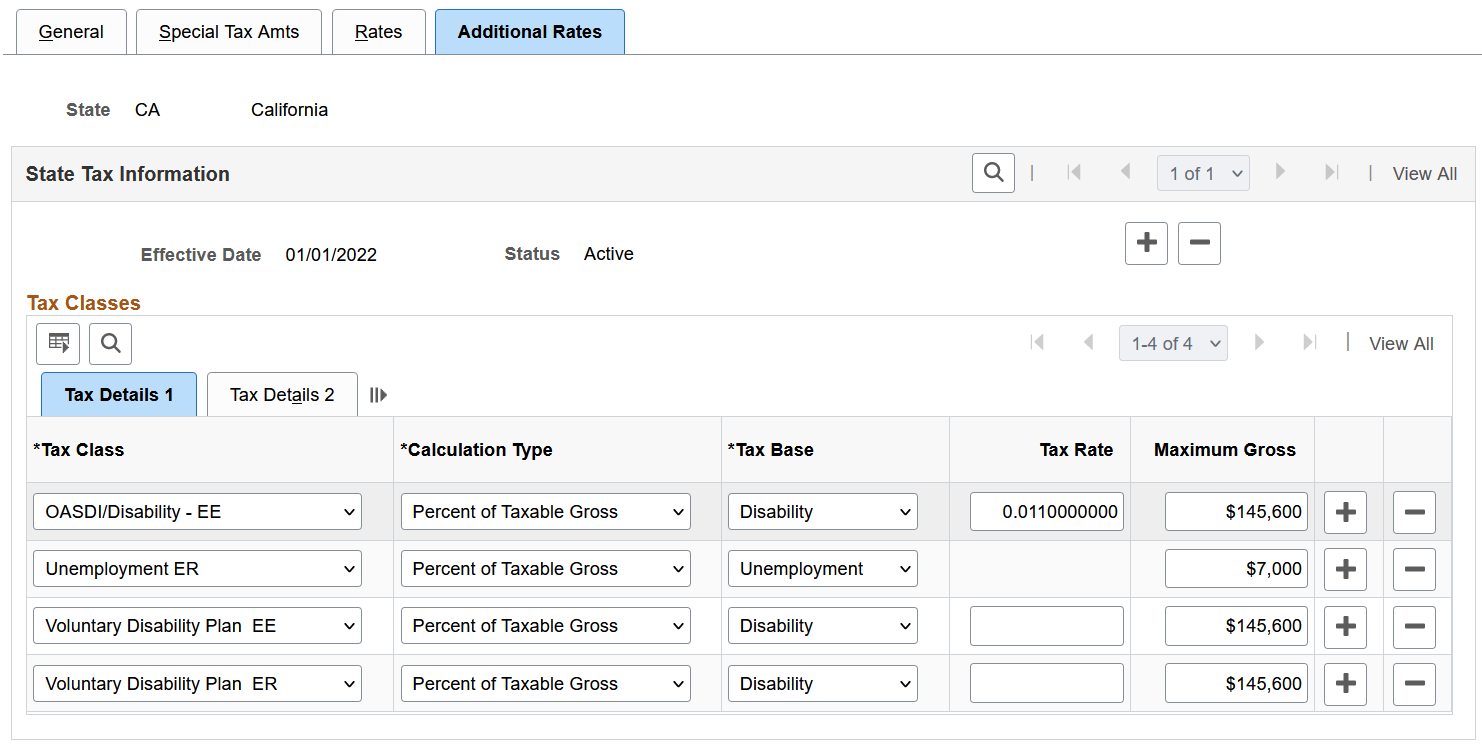

(Federal/State Taxes) Tax Table - Additional Rates Page |
Added new table entry to the State Tax Table for the state, which includes tax classes and the state program rates. |
Added new table entry to calculate the taxable grosses for the tax classes as required by the state regulations. |
Added new table entry to establish a Paid Family Medical Leave program using the tax classes for the state. |
Define Calculation Rule - Description Page and Define Calculation Rule - Calculation Formula Page |
Added calculation rules for use with tax classes for the state. |
Added new table entry to define tax classes, ACTIVITY translate values and GL Tax Classes to support the state program. |

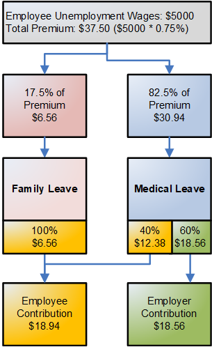

Premium Calculation Example
This example illustrates the calculation of premium payments for Massachusetts Paid Family and Medical Leave. The employer in this scenario has more than 25 covered employees, which means that the employer is responsible for the employer share of the medical leave premium.
The rate used in this example is effective as of October 1, 2019, and is subject to change.
For an employee who earned $5,000 in unemployment wages, the total premium payment is $37.5 ($5,000 * 0.75%). The Family Leave portion of the premium is $6.56 ($37.5 * 17.5%), which is contributed entirely by the employee. The Medical Leave portion of the premium is $30.94 ($37.5 * 82.5%), which is split between the employee ($30.94 * 40%) and the employer ($30.94 * 60%).
This diagram illustrates the example of a premium calculation for Massachusetts Paid Family and Medical Leave.

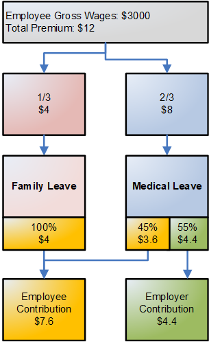

Washington Paid Family and Medical Leave is a state program that is funded by premium payments consisting of both employee payroll deductions and employer contributions.
To calculate the paid family and medical leave taxes for Washington, the system delivers a row for the WA state on the Tax Table - Additional Rates Page that includes these tax classes:
Family Leave Insurance - EE
Family Leave Insurance - ER
Voluntary Family Leave Ins EE
Voluntary Family Leave Ins ER
Medical Leave Ins - EE
Medical Leave Ins - ER
Voluntary Med Leave Ins EE
Voluntary Med Leave Ins ER
The total premium rate and allocation ratios for the Washington Paid Family and Medical Leave are stored in the state tax table.
The employer is required to pay 36.67% (.3667) of the total premium, and may deduct up to the remaining 63.333% (.6333) of the total premium from an employee’s wages. Between the Family Leave portion and Medical Leave portion of the total premium, the employer:
May deduct up to 100% of the Family Leave premium from employee wages.
Must pay a minimum of 55% of the Medical Leave, and may deduct up to a maximum of 45% of the Medical Leave premium from employee wages.
This example illustrates the calculation of premium payments for Washington Paid Family and Medical Leave. The rate used in this example is effective as of January 2, 2019, and is subject to change.
For an employee who earned $3,000 in gross wages, the total premium is $12 ($3,000 * 0.04%). This equates to a maximum employee deduction of $7.6 and a minimum employer contribution of $4.4.
This diagram illustrates the example of a premium calculation for Washington Paid Family and Medical Leave.

Use the Tax Table - General page (STATE_TAX_TABLE1) to view standard deductions, allowance amounts, and supplemental rates.
Navigation:
This example illustrates the fields and controls on the Tax Table - General page.
Note: You shouldn't need to modify this table, but if you must, you can make changes if you have the appropriate security authorization. This applies to all pages in this component.
Field or Control |
Description |
State Tax Calculation Type |
Indicates the type of withholding tax calculation required by the state. |
FWT Credit |
This check box indicates whether credit is given for FWT during calculation of state income tax withholding. |
Non-Resident Declaration Required |
This check box indicates whether the state requires a Non-Resident Declaration for non-resident employees. |
Allow Withholding Reduction |
This check box indicates whether the state allows a reduction amount to be computed in the state withholding calculation. Currently, this only applies to Connecticut. |
FICA Credit |
This check box indicates whether credit is given for FICA during calculation of state income tax withholding. |
Supplemental Method
Details of the values available for selection in this group box and examples of calculations are provided in this product documentation.
See Supplemental Tax Calculations.
Field or Control |
Description |
Paid With Regular Wages |
PeopleSoft delivers the required selection: Aggregate − No Annualize, Aggregate, Aggregate-No Tax else Percent, Non-Resident Supplemental, Not Applicable, Percent of Taxable Gross, Special Table with Exemptions, and Special Table. |
Separate Payment |
Use the Special Tax Amts page (STATE_TAX_TABLE2) to view information needed for tax calculations.
Navigation:
This example illustrates the fields and controls on the Special Tax Amts page.
Note: The page for the Federal Tax Table differs from the one for specific states.
Field or Control |
Description |
State Statutory Minimum Hourly |
The system uses this field to calculate tip credit to pay overtime for tipped employees. The minimum hourly rate required by that state appears here. The system also uses this field to retrieve the state minimum wage that is required when the state hourly minimum wage is required for garnishment as set on the Calculation Formula Page. |
State Tips W/H Threshold (state tips withholding threshold) |
This field appears if the value in the State field is $U. This field is used in conjunction with state regulations for delaying the withholding of taxes on tips until the employee reports monthly tips in the amount equal to the threshold amount. This field displays the monthly threshold amount from the federal regulations and as of now all states use that threshold amount. For states that allow you to delay withholding on tips, you can specify by Pay Group whether you delay withholding on tips. |
Report Neg Wages |
Options are include or separate. |
Tax Reporting |
Options include Annual, Monthly, or Quarterly. |
Delay W/H for tips |
On this page, this check box refers to state income tax. For each state, PeopleSoft selects or deselects this check box, depending on whether the state allows employers to delay withholding on tip income until the monthly threshold amount is reached. For states that allow you to delay withholding on tips, you can specify by Pay Group whether you'll delay withholding on tips. |
Employee Detail Required |
This field is informational only and indicates whether a state requires the quarterly reporting of individual employee wage data. All states currently require such reporting. |
Use Common PayMaster for SUI? |
This check box is selected if the state recognizes common paymaster status between companies for purposes of state unemployment insurance taxes. |
Special Tax Amount 1 |
This field is used to store parameters or values used in withholding tax calculations for the selected state or federal jurisdiction. |
Special Tax Amount 2 |
When the selected state is Federal ($U), the amount displayed in Special Tax Amount 2 is the YTD wage threshold that triggers withholding of the federally required Additional Medicare Tax. Once the YTD maximum threshold income is reached, additional medicare will be calculated. There is no limit on the amount of wages subject to the Additional Medicare Tax during the remainder of the tax year. |
Special Tax Amount 5 |
When the selected state is Federal ($U), the amount displayed is the amount that the system adds to the annualized wages of the nonresident alien (NRA) solely for purposes of NRA tax withholding calculation. This amount does not add to the employee's federal taxable gross balance. |
Use the Tax Table - Rates page (STATE_TAX_TABLE3) to view wage bracket information.
Navigation:
This example illustrates the fields and controls on the Tax Table - Rates page.
(CT) This page contains data from Connecticut Table B - Withholding Tax.
Field or Control |
Description |
Tax Status |
The appropriate Federal/State tax status (Married, Single, and so on). Note: Puerto Rico: Head of Household is not a valid tax status for wages paid on or after January 1, 2012. See Employer’s Guide to Withholding of Income Tax at Source on Wages paid after Dec 31, 2011 but before Jan 1, 2013 published by Departamento de Hacienda. |
Low Gross |
The minimum taxable gross for the bracket. |
Low Tax |
The tax to be withheld on the corresponding minimum taxable gross. |
Tax Rate |
The rate to be applied until the next bracket is reached. |
Credit Amount |
Displays the credit amount for the bracket, which varies depending on the corresponding tax status and minimum taxable gross. |
Use the CT Exemptions page (STATE_TAX_TABLE3_A) to view the tax status, low gross, and exemption amount, from Connecticut Table A - Exemptions, that are used for calculating Connecticut state tax exemptions.
Navigation:
This example illustrates the fields and controls on the Connecticut Exemptions page.
Note: The CT Exemptions page is Available only when the state entered in the Tax Table search dialog is CT.
When you access the Federal/State Taxes, Tax Table component for the state of CT (Connecticut), CT-specific data and pages appear. The CT-specific pages store values used in the calculation of Connecticut state taxes.
The Rates page contains values from Connecticut Table B - Withholding Tax.
The CT Exemptions page contains values from Connecticut Table A - Exemptions.
The CT Credits page contains values from Connecticut Table E - Personal Tax Credits.
The CT Phase Out page contains values from Connecticut Table C - 3% Phase-Out.
The CT Recapture page contains values from Connecticut Table D - Tax Recapture.
Use the NRA Adjustment page (STATE_TAX_TABLE3A) to view the withholding adjustment rate to use for nonresident alien wages.
Navigation:
This example illustrates the fields and controls on the Nonresident Alien Adjustment page.
Note: The NRA Adjustment page is available only when the State = $U (Federal).
View the income, tax, and withholding rate to use to calculate the additional withholding adjustment amount required by IRS for nonresident alien wages.
Field or Control |
Description |
Low Gross |
The minimum taxable gross income for the bracket. |
Low Tax |
The tax to be withheld on the corresponding minimum gross. |
Tax Rate |
The rate to apply until the next bracket is reached. |
Use the Tax Table - Additional Rates page (STATE_TAX_TABLE4) to view wage limits for unemployment and disability taxes.
Navigation:
This example illustrates the fields and controls on the Tax Table - Additional Rates page.
Note: (For Program Funding Configuration feature only) PeopleSoft delivers state tax table updates to support state programs using scripts.
Field or Control |
Description |
Tax Class |
Tax classes identify different taxes that share certain characteristics. For example, Local Services Tax represents Local Services Tax (LST) for Pennsylvania employees. |
Calculation Type |
Options are Not Applicable, Percent of Taxable Gross, and Use ER Wage for EE Tax. |
Tax Base |
Options are Disability, Paid Leave, Unemployment, and Withholding. |
Tax Rate |
The tax rate for employer unemployment, voluntary disability/paid leave contributions is blank on this page. The rate used during payroll calculations comes from the Company State Tax table. Note: (For Program Funding Configuration feature only) When you add a new row on this page for a tax class that is also referenced on the Program ID Association Page for the same state and effective date, the Tax Rate field becomes editable if the Display Tax Rate option on the association page is selected. |
Maximum Gross |
If a tax applies only to a portion of an employee's annual wages up to a specified limit, such as employer unemployment taxes, that limit amount appears in this field. An entry of all 9s, as with Medicare taxes, indicates a tax without limit. |
Maximum Tax |
If there is an annual limit on a particular type of tax, such as Pennsylvania's Local Services Tax, enter that limit amount here. |
Taxability |
Select Employee Tax Only, Employer Tax Only, Empl and Emplr Tax, or Memo Tax Only to indicate whether a tax is paid by the employee, paid by the employer, or paid in equal matching amounts by both. |
Ratio |
(MA and WA) This value represents the ratio of the total premium to be allocated to the corresponding tax. Note: (For Program Funding Configuration feature only) When you add a new row on this page for a tax class that is also referenced on the Program ID Association Page for the same state and effective date, the Ratio field becomes editable if the Display Ratio option on the association page is selected. The sum of ratio values for all tax classes with the same ratio ID must be 1. |
Period Maximum |
If selected, this option indicates that the tax is calculated for a period other than annual. Two examples of this are SDI in New York and Hawaii, both of which have weekly maximums. |
Self Adjust (self-adjusting) |
This check box is for information only and does not affect processing. |
Delay W/H for Tips (delay withholding for tips) |
On this page, this check box is selected or deselected for each additional tax the state may impose. For each state, PeopleSoft selects or deselects this check box, depending on whether the state allows employers to delay withholding on tip income until the monthly threshold amount is reached. For states that allow you to delay withholding on tips, you can specify by Pay Group whether you'll delay withholding on tips. |
Voluntary Disability Plans
Of the states that provide disability insurance plans (currently California, Hawaii, New Jersey, New York, Rhode Island, plus Puerto Rico), all but Rhode Island allow employers to provide voluntary disability plans in place of the state plan. PeopleSoft maintains the Tax Class rows on the Federal/State Tax Table - Additional Rates page for the Employer and Employee paid tax for voluntary disability plans for each of these states.
Note: If you implement a voluntary disability plan for California, Hawaii, New Jersey, New York, or Puerto Rico, you must set up the appropriate tax rates on the Company State Tax table and the VDI/FLI Administrator table.
State Unemployment Insurance (SUI) Tax
You must make sure that the unemployment insurance taxable gross and tax balances transferred during the conversion process are consistent with the unemployment tax rates that have been entered for each quarter on the Company State Tax Table page.
Warning! If these amounts are not consistent and in balance, the system will either charge or refund additional unemployment tax amounts to account for the difference in the quarterly unemployment insurance tax balances.
