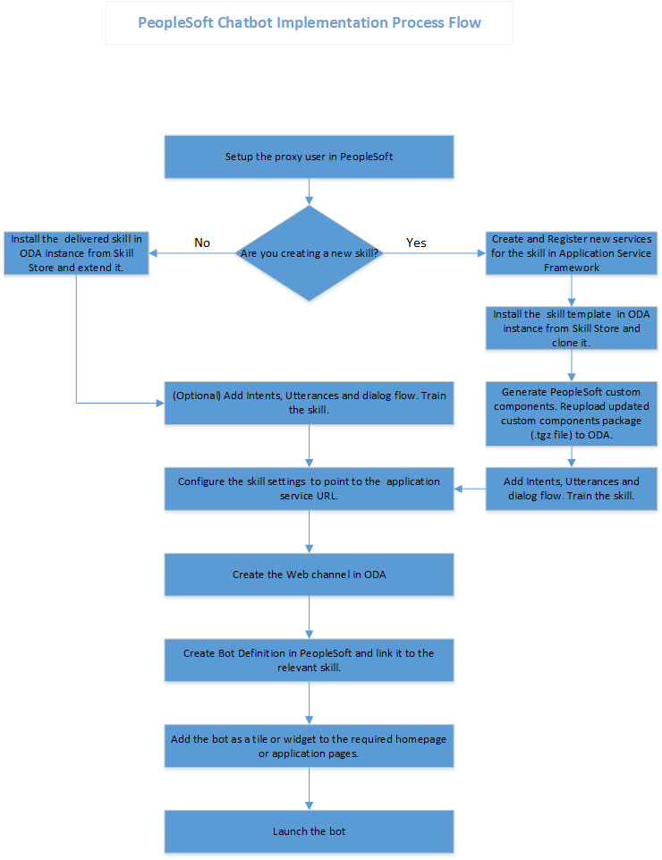

Here's an overview of the digital assistant deployment process.
