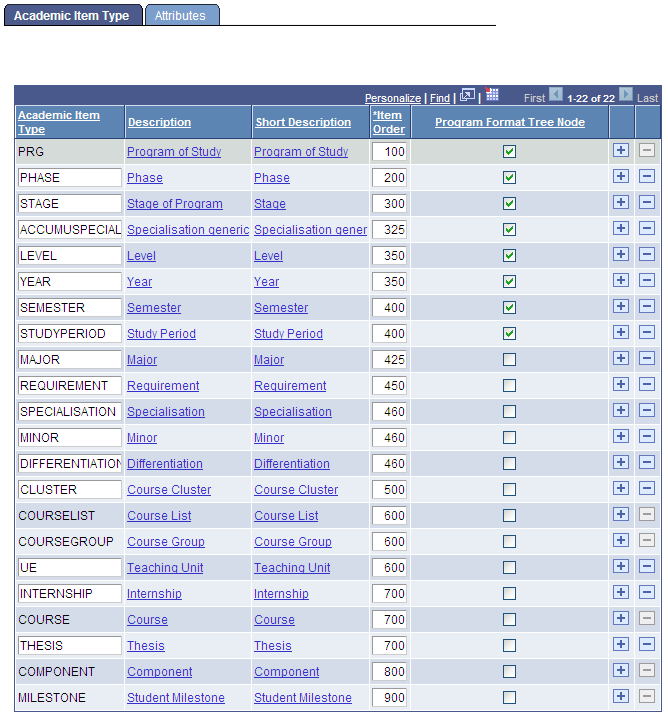

This example illustrates the fields and controls on the Academic Item Type page. You can find definitions for the fields and controls later on this page.
Define academic item types (by installation) on the Academic Item Type page by inserting new rows in a grid. When you insert a new row, you are taken to the Attributes page to define the detail for the item type. The Academic Item Type page also provides a summary view of all academic items. You can also update Item Order and Program Format Tree Node values on this page. The default sort order for the grid is by Item Order so that you can quickly scan items to verify logical order.
Note: You cannot delete an academic item type row here if an academic item of this type has been created in the Academic Item Registry.
See Setting Up Academic Item Registry Entries, Item Details, and Item Security
Field or Control |
Description |
Description and Short Description |
Click the Description or Short Description links to access the Attributes page and further define the item type. |
Item Order |
Enter a number to define the hierarchy and sort order of the items in the user interface. The lowest number represents the highest node – for example, the number that you enter for YEAR is lower than the number you enter for COURSE. The potential children of an academic item type must have an item order greater than that of the item type itself. You define child item types for an academic item type in the Item Type Matrix component. See Identifying Child Item Types and Syncing Entities We advise you to increment child item orders by ranges of 50 or 100, ensuring that you have space between two levels so that you can insert additional items in your structure if needed in the future. If two academic items are at the same level in your program hierarchy, they can bear the same Item Order number. PRG item type is delivered with an item order of 100 but you can change the item order. The system ensures that the item order for PRG is always the lowest. For more information about delivered item types, |
Program Format Tree Node |
Select to identify an academic type as one that can be used to construct a Program Format definition. The Program Format Tree Node field also appears on the Attributes page. For more information about this field, |

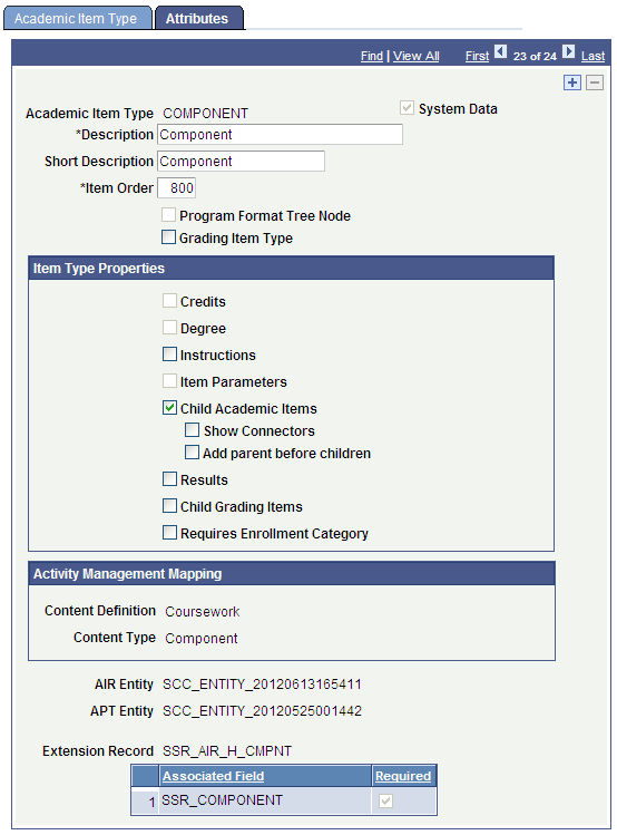

Access the Attributes page ().
This example illustrates the fields and controls on the Attributes page. You can find definitions for the fields and controls later on this page.
Use the Attributes page to define the types of attributes that are available for an item in the AIR, and, through the Extension Record, what type of external (to AIR) objects can be referenced by the item (such as courses or milestones).
See Defining Academic Item Type Attributes
The setup options that you select on the Attributes page impact the Academic Item Registry component (AIR).

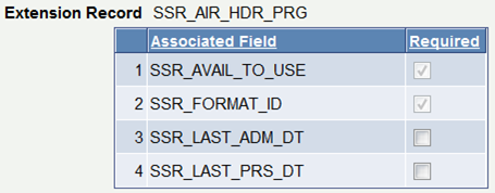

SSR_AIR_HDR_PRG: Program Extension: Used by the delivered Academic Item Type PRG. Used to store Program (item type) specific fields.
This example illustrates a SSR_AIR_HDR_PRG extension record.

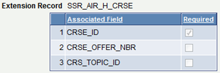

SSR_AIR_H_CRSE: Course Catalog extension: Used by the delivered Academic Item Type COURSE and references a Course defined in the Course Catalog. As delivered, you can create academic items that point to a course ID or a course offering or to a course ID/offering with a specific Course Topic ID.
Note: Course ID is always required (Required check box is selected and not available for edit).
This example illustrates a SSR_AIR_H_CRSE extension record.

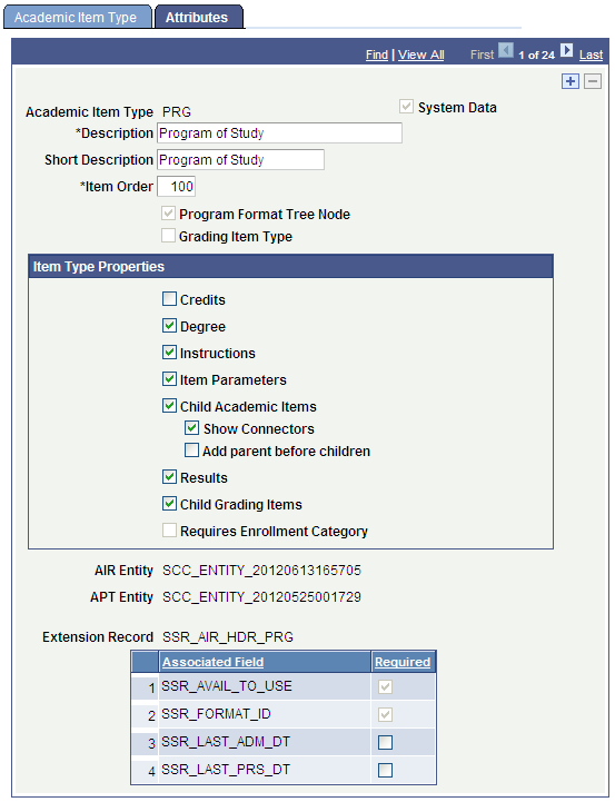

PRG: Program of Study:
PRG is used for all academic items that represent an overall educational objective and that comprise all of the child items necessary to achieve the objective.
Note: You must define an academic item with an Academic Item Type of PRG for every Program of Study that you want to build in AIR.
This example illustrates an academic item type of PRG.
PRG is the root item for all AIR based programs. All other academic item types must have an item order greater than the PRG item order value.
Attribute Restrictions: All attributes are available except for Requires Enrollment Category.

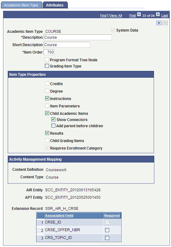

COURSE: Course
COURSE points to a predefined Course Catalog offering (can be defined down to the Course Topic ID).
Note: All Courses that are used in an AIR program definition must be defined as academic items in AIR.
This example illustrates an academic item type of COURSE.
The main purpose of the COURSE academic item is to serve as a pointer to an established Course ID, Course offering (CRSE_OFFER) or Course topic. Because a course has predefined unit/credit value (at the CRSE_CATALOG level) the credits and so on for a COURSE item are always inherited directly from there—the item has no credit value itself.
Cannot have Credits or Item Parameters, because these define a credit value that could contradict the Course Catalog definition. The Credits check box and the Item Parameters check box are not available for selection.
Child Items are allowed, because AIR can be used to support a model where components could be graded, (themselves defined as academic items) rolling up to a parent course.
Cannot have Grading Items.
The Requires Enrollment Category check box is selected and cannot be edited.
COMPONENT: Component
COMPONENT is used to build Course components in AIR, such as Lectures and Labs. When a COMPONENT item type is built in AIR, the component field is visible and prompts against the XLATTABLE for the field SSR_COMPONENT
This example illustrates an academic item type of COMPONENT.
Use the Component item type if you want to represent course component structures in AIR program structure for possibly grading students at the component level in the Academic Progress Tracker (APT).
Attribute Restriction: The Component item type is delivered with the check boxes for all attributes cleared, but you can select the check boxes.

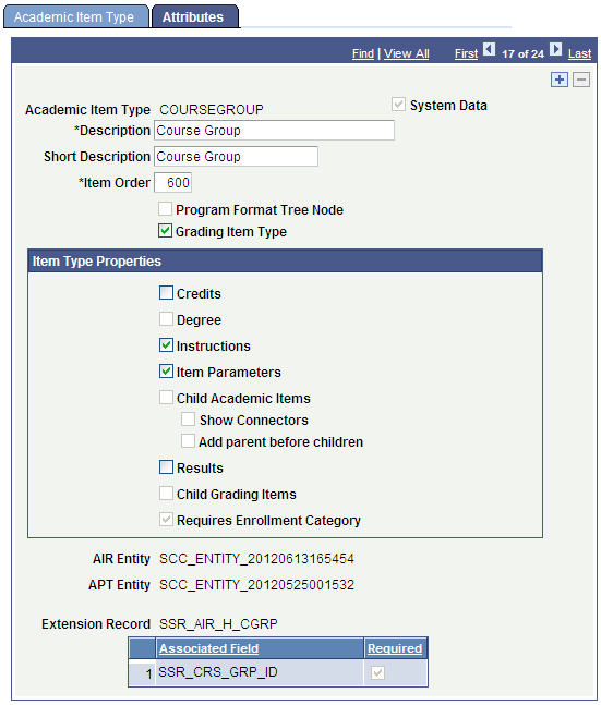

COURSEGROUP: Course Group
COURSEGROUP is used to point to a Course Group ID that allows you to define a ‘wild card’ course listing.
This example illustrates an academic item type of COURSEGROUP.
The main purpose of the COURSEGROUP item type is to serve as a placeholder (or pointer) to a loosely defined list of courses defined using wildcard indicators. Some attributes are therefore restricted.
Cannot have Child Academic Items or Grading Items.

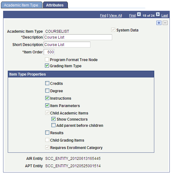

COURSELIST: Course List
COURSELIST is used to define a list of courses that can be attached to another academic item.
This example illustrates an academic item type of COURSELIST.
The COURSELIST academic item type is provided for defining academic items that represent lists of courses. While user defined items can be used for this same purpose, various system edits are triggered by using the delivered COURSELIST item.
Only COURSE items can be assigned as child items.
The Child Academic Items check box is selected and cannot be edited.

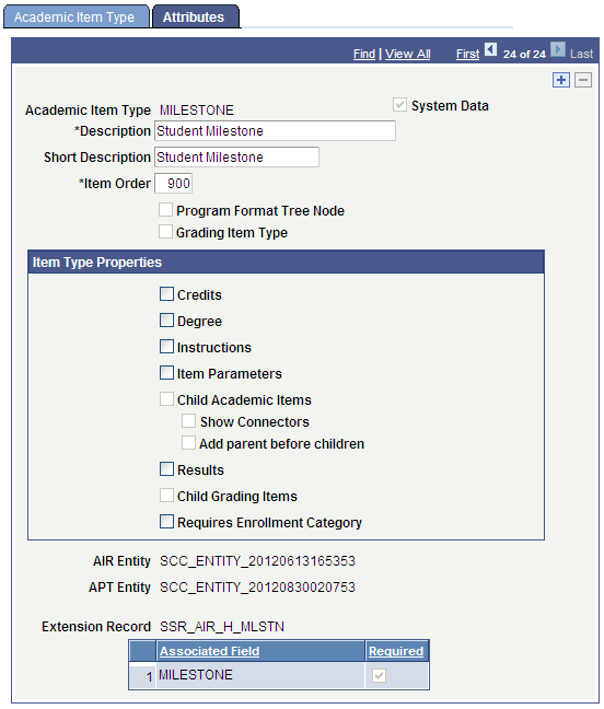

MILESTONE: Student Milestone
MILESTONE points to a predefined Milestone definition.
This example illustrates an academic item type of MILESTONE.
The main purpose of the MILESTONE academic item is to serve as a pointer to an established Milestone table entry, where the rules for the completion of the milestone are defined.
Attribute Restrictions: Cannot have Child Academic Items or Grading Items.
