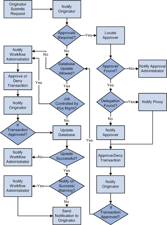

The following diagram illustrates the process flow that begins when a self-service user submits a request. The diagram shows both the basic process flow and the alternate flows for approvals, database updates, and notifications:
Process flow for self-service transactions with optional approvals, database updates, and notifications
There are four main sections to this process flow:
  • A request is submitted.
  • The request uses an approval process.
  • The request allows automatic updates to the database.
  • The request doesn't allow automatic updates to the database.

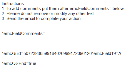

The approver can act upon an email request by selecting the appropriate action link that appears at the bottom of the email request.
Upon selecting an action, a response email will open. The email includes instructional text to let the user know where to enter comments, if any.
Example of an approval response email
The approver can enter comments after the emcFieldComments text, but this is not a requirement. Note that any other identifiers should not be removed or modified.

    See Workflow Configurations Page.
  5. Define if a transaction automatically updates the database.
    Use the self service Workflow Configurations page to define whether the transaction will update the database without an administrator's intervention.
  6. Link the self-service transaction to the approval process ID in the Approve Workflow Engine (AWE) and Transaction section on the Workflow Transactions page.
    PeopleSoft delivers the PromoteEmployee, ReportingChgEmployee, and TransferEmployee approval processes already linked to their appropriate self-service transaction.
    See Understanding Approvals.
  7. Define rules for workflow notifications.
    Workflow can be set up to notify the administrator when a transaction successfully updates the database and when the system detects a warning with the update.
    See Admin Notification Setup Page.
  8. Configure and manage HTML email approvals.
    The Enterprise Components AWE framework supports the HTML email approvals as delivered. However, you will need to enable HTML email approvals for your transactions and review email templates to ensure they meet your organization’s requirements.
    See Triggering Email Collaboration
