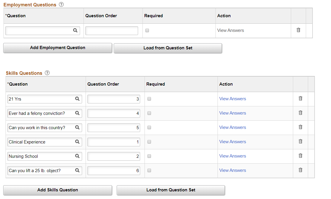

Use the Screening Questions section on the Job Opening page (HRS_JOB_OPENING) to configure screening questions for the job opening.
Note: The template for the job opening controls whether this section appears and, if so, where it appears.

Screening Questions
Field or Control |
Description |
Question |
Select a screening question. Screening questions are defined on the Question Definition page. Questions that you enter here are available to be used by any of the screening levels that you run for this job opening (except that you can't use open-ended questions for prescreening or online screening). Applicant's answers are collected during the online application process in Candidate Gateway. |
Question Order |
Enter numbers to control the order that the questions appear in the online application. If you load questions from a question set that specified order numbers, then those order numbers are the default values in the job opening. Review any default values carefully. Default values might not be unique, depending on the order numbers that were assigned in the question set definitions, and it is up to you to specify an unambiguous question order. Because this field accepts only integers, consider using non-consecutive numbers to make it easier to insert additional questions between existing questions. Note: If the Randomize Screening Questions field on the Recruiting Installation - Jobs page has a Yes value, then the system disregards the question order and presents questions to applicants in random order. |
Action |
For multiple-choice questions, a View Answers link appears. Click this link to access the Answers to Screening Questions page, where you can review the answer choices and their default point values. When you set up screening criteria for the job opening, you can override the default values. For open-ended questions, an Enter Evaluators link appears. Click this link to access the Assign Evaluators page, where you identify the users who will evaluate and award points to applicants' answers. An evaluator can be any person in the PeopleSoft Human Resources system who has appropriate security access. It is possible to assign yourself as an evaluator. When evaluating open-ended questions, evaluators see only the question and the answer; no applicant information is visible. Note: Always assign evaluators to open-ended questions. Only the assigned evaluators can award an applicant points for the question, so questions without evaluators are never awarded any points during screening |
Add Screening Questions |
Click to add another row to the Screening Questions grid. |
Load from Question Sets |
Click to access the Select Question Sets page, where you can select one or more question sets whose questions will all be added to the list of screening questions. |

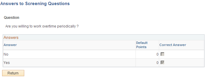

Use the Answers to Screening Questions page (HRS_JO_ANSWER_SEC) to review the answers to a multiple-choice screening question and to review the default points associated with each answer.
Navigation:
Click the View Answers link for a multiple-choice screening question on the Job Opening Page: Screening Questions Section
This example illustrates the Answers to Screening Questions page.
Use this page to review answer information, including default point values for each answer.
To change the list of answers, the default points for an answer, or whether an answer is considered correct, use the Question Definition page.
To change the point values for answers for a particular job opening, use the Define Screening Points Page (Rating Scale Points) in the job opening.

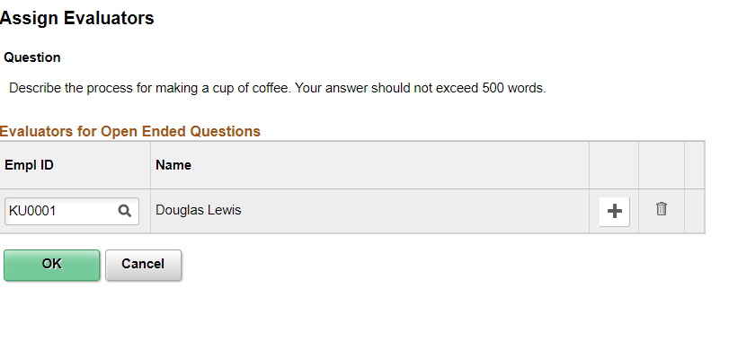

Use the Assign Evaluators page (HRS_OE_EVAL_SEC) to review the full text of an open-ended question and to assign evaluators who will give scores to applicants' answers.
Navigation:
Click the Enter Evaluators link for an open-ended screening question on the Job Opening Page: Screening Questions Section.
This example illustrates the Assign Evaluators page.
Field or Control |
Description |
Empl ID |
Enter the Employee ID of the users who are assigned to evaluate applicants' responses to this open-ended question. If you remove an evaluator from this page, the evaluator's completed evaluations are not affected. Only pending evaluations (which appear in the Recruiter Alerts pagelet) are removed. |

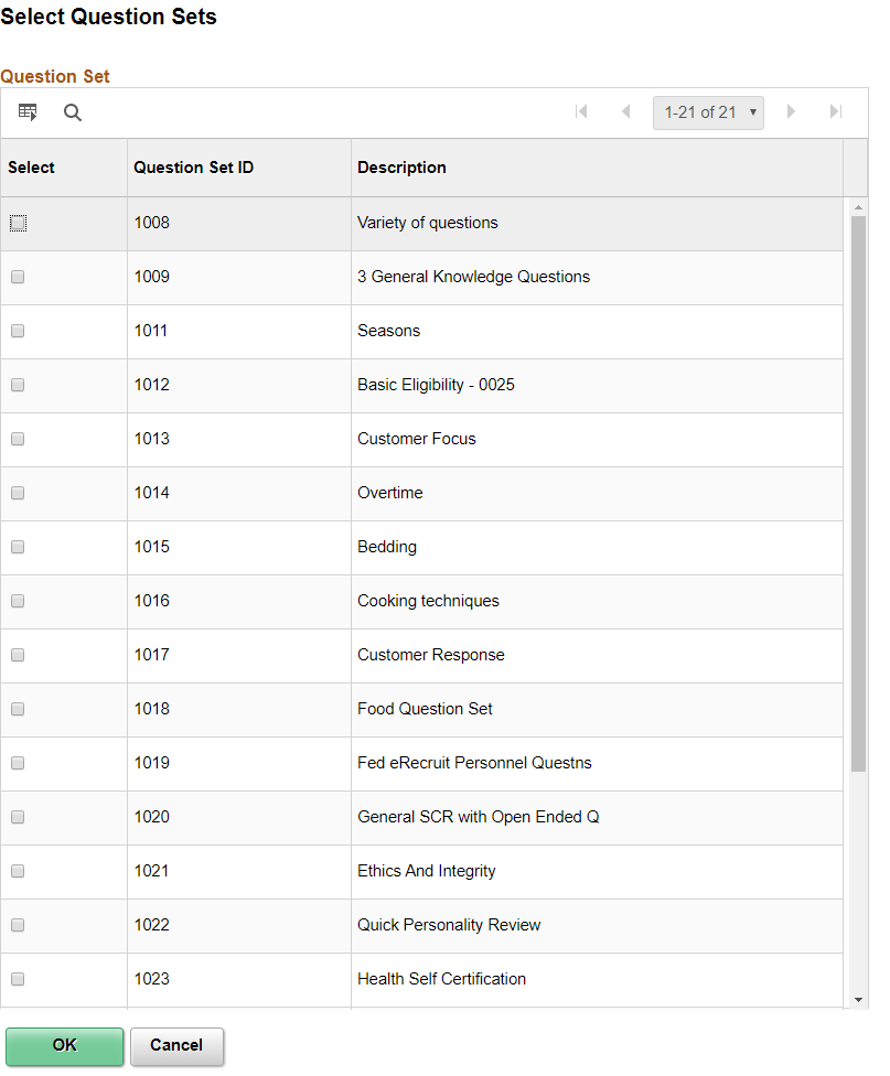

Use the Select Question Sets page (HRS_QSET_ADD_SEC) to choose a question set so that the system can add all included questions to the job opening.
Navigation:
Click the Load from Question Sets link on the Job Opening Page: Screening Questions Section.
This example illustrates the Select Question Sets page.
The Question Set grid lists all questions sets in the system. Select one or more whose questions you want to add to the job opening, then click the OK button.
