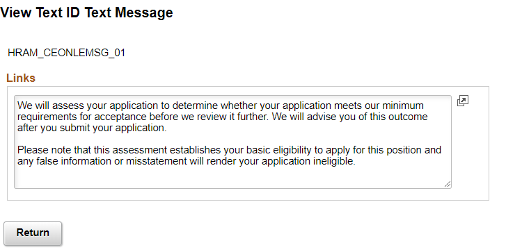

View the complete text of the explanatory message, pass message, or fail message that you selected for prescreening or online screening. |

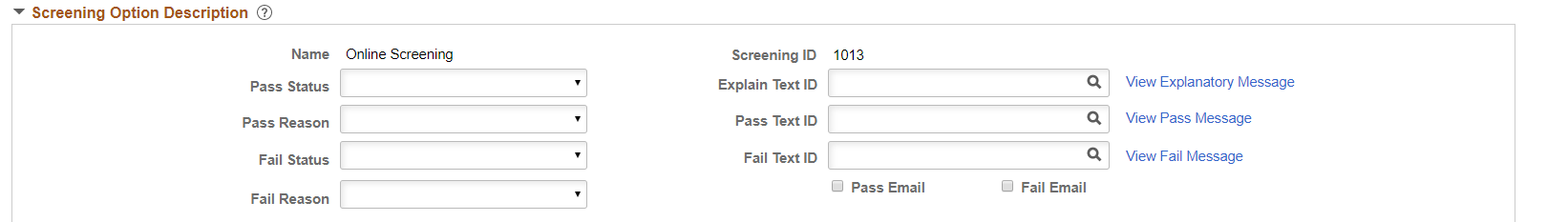

Screening is the process used by recruiters to evaluate a list of potential candidates and narrow the list to a few qualified applicants that can be interviewed or hired. A job opening can have multiple screening processes, or screening levels, and each screening level can evaluate different criteria and use different processing rules.
Screening Level Selection
The Screening Options section on the Job Opening page includes a grid containing an ordered list of screening levels for the job. This section also includes a check box that you use to indicate whether applicants must pass the previous screening level before being included in subsequent screening levels.
If you include a screening level for prescreening, it is always the first screening level. If you include a screening level for online screening, it always goes before any other screening levels except the prescreening screening level.

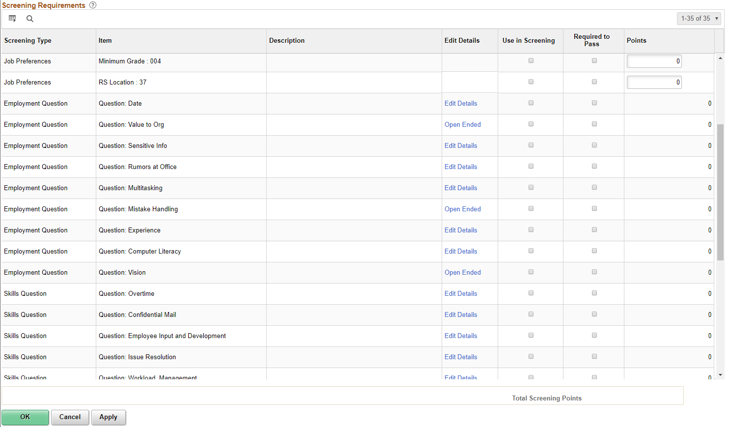

The screening level definitions that you reference from the job opening include default processing rules, but they do not include any actual screening criteria. Use the Job Opening - Screening Criteria page to select job opening-specific criteria for each level.
When you access the Job Opening - Screening Criteria page for a screening level, the grid where you select screening criteria is automatically populated with certain attributes of the job opening. You then select which of the available items to use in the screening level that you are configuring.

When you define the job-specific criteria for a screening level, you must also provide a point value for each item that you select. The criteria grid includes a points field that displays the maximum point value for each item. Points can be positive or negative.
You assign point values differently depending on the type of criteria:
For criteria that is either met or not met, the points field is editable so you can directly enter a point value.
Use this method of assigning point values for all general requirements, all education and experience requirements, and certain content types such as licenses that an applicant either has or does not have.
For example, if there is a general requirement that the applicant be at least 18 years old, the applicant either does or doesn't meet the requirement. Therefore, you can enter the point value for this requirement directly on the Job Opening - Screening Criteria page.

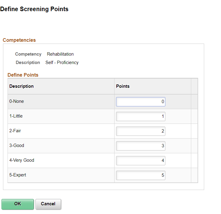

For content types that are associated with rating scales (such as competencies), click a link to access a page that lists the possible ratings, and enter the point value for each rating.
Default point values come from the content type definition, but you can override these defaults.
Applicant receive the points that correspond to their rating (as long as the rating type for the applicant's rating matches the required rating type). Unrated applicants receive no points, so it is important that applicants be rated before you run a screening level that evaluates a competency or other qualification with a rating scale.

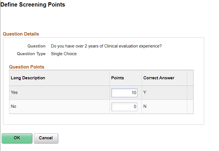

For single choice, multiple-choice, Date type and Numeric questions, click a link to access a page that lists the possible answers, and enter the point value for each answer.
Default point values come from the question definition. You can assign point values to both correct and incorrect questions. If there multiple correct answers, the total value of the question is the sum of the point values of all correct answers.
Applicants receive the points that correspond to the answer or answers that they provided. They receive no points for unanswered questions.

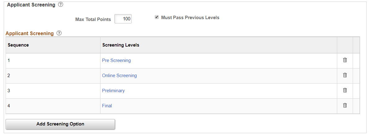

Use the Applicant Screening section on the Job Opening page (HRS_JOB_OPENING) to enter screening options for a job opening.
Note: The template for the job opening controls whether this section appears and, if so, where it appears.
Navigation:
Click the Continue button on the Primary Job Opening page and, if necessary, on the Combined Profile Information page.
Click the link for a job opening in the search results, then click the Job Details tab, then click the link for the type of job opening data you want to access.
This example illustrates the Job Opening page: Applicant Screening section.
The following illustration shows how the screening section looks in a federal implementation:
This example illustrates the Applicant Screening section in a U.S. federal implementation.
Note: In the screening section on the Job Opening page, all fields except for the Transmutation USF check box (visible only in U.S. federal implementations) have default values that come from the screening template.

Applicant Screening
This grid lists the screening levels for the job opening.
Field or Control |
Description |
Sequence |
The sequence determines the order in which you run the listed screening levels. The screening template that provides the default list of screening levels also sets their default sequence. You cannot change the sequence directly. However, screening levels that you add to the list are automatically put at the end of the sequence. So to change the order of the default screening levels, you can remove screening levels from the list and re-add them in the desired order. Regardless of how screening levels are added to the list, the sequences starts with the prescreening level (if any), followed by the online screening level (if any), followed by all other screening levels. |
Screening Levels |
Displays the name of the screening level. Standard screening levels can appear in the list multiple times. However, the list can include a maximum of one prescreening level and one online screening level. Click the link to access the Job Opening - Screening Criteria page so that you can choose screening criteria and, if necessary, override default processing rules. Note: After you click a screening level, the system saves the job opening before displaying the Job Opening - Screening Criteria page. |

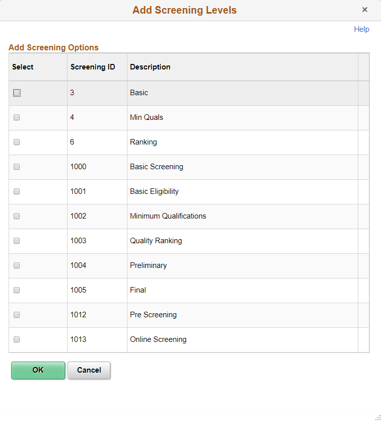

Use the Add Screening Levels page (HRS_SCR_ADD_SEC) to add screening levels to the job opening.
Navigation:
Click the Add Screening Options link on the Job Opening Page: Applicant Screening Section.

The page lists the screening levels that your organization has defined. Select the check box next to the screening levels that you want to add, then click the OK button.
Note: A job opening can have only one prescreening level and only one online screening level.

Screening Option Description: Page Elements for Prescreening and Online Screening
These page elements appear only for screening levels for prescreening and online screening.
This example illustrates the Screening Option Description section for online screening and prescreening.
Field or Control |
Description |
Explain Text ID |
Select the ID for the message that Candidate Gateway presents to applicants when they reach the point where this screening level is to be processed. Use this message to give the applicant instructions or other relevant information. For prescreening, explanatory text is required. The text appears under the Prequalification Terms heading on the application process Start step. Applicants must agree to these terms before continuing. For online screening, explanatory text is optional. The texts appears on the application process Review and Submit step so that applicants can be informed that screening will occur when the application is submitted. The screening level definition does not include a field for a default explanatory message, so you must enter this information on each job opening that requires an explanatory message. |
Pass Text ID and Fail Text ID |
Select the IDs for the messages that Candidate Gateway presents to applicants who pass and who fail this screening level. Messages are required for prescreening and optional for online screening. Default values come from the screening level definition. Important! In Fluid Candidate Gateway, applicants who pass prescreening for all jobs in an application do not see any prescreening messages. Therefore, organizations that use Fluid Candidate Gateway should not use the pass message for any critical information. Applicants do see the pass message if the prescreening results are a mix of pass and fail, and the message is still sent to the applicant if you select the Pass Email check box. |
View Explanatory Message, View Pass Message, and View Fail Message |
Click these links to access the View Text ID Text Message page, where you can review the complete test of the selected message. |
Pass Email and Fail Email |
Select these check boxes to make the system send screened applicants an email containing the pass message or fail message, depending on the screening results. The system sends the email in addition to displaying the message online. |

Screening Requirements
This grid displays all available screening criteria so that you can select which items to use in the screening level.
See Understanding Screening Settings in the Job OpeningMaking Content Types Available for Screening.
Field or Control |
Description |
Description (first column) |
Displays the type of screening criteria. General Requirements items appear first, then Education & Experience items, then Screening Question items. The remaining items in the grid are job opening attributes based on profile content types. This includes job qualifications such as Competencies, Degrees, and Language Skills. The content type definition provides the descriptive text that appears in this column. |
Item and Description |
Displays the specific job requirement that is available for screening. For general requirements, screening questions, and education & experience requirements, text in the Item column concatenates the name of the requirement (for example, Full/Part Time) and the value to be matched (for example, Full-Time). The adjacent Description column is blank. For content type items, the text in the Item column is simply the name of the content item as defined in the Manage Profiles content catalog. For example, if the content type is Memberships, the Item column identifies the membership. The next column displays the specific property, such as Membership, that is evaluated during screening. Note: Settings on the Content Section Configuration page control the profile data that is available for screening. See Making Content Types Available for Screening. If the content types uses instance qualifiers to organize content items, the instance qualifier also appears in the Description column. In particular, competencies use the evaluation type (Self, Supervisor/Manager, Peer, and so forth) as instance qualifiers, and therefore the evaluation type appears next to the property name (Proficiency) in the Description column. When setting up screening criteria, you might need rows for more than one evaluation type. For example, external applicants can be screened based on their self-determined proficiency ratings, while internal applicants might be screened based on official competency ratings. |
Edit Details |
Displays a link that varies depending on context: The link text is Edit Details for multiple choice questions and for content types such as competencies that provide a rating scale. Click the link to access the Define Screening Points page, where you can assign different scores to different ratings or question answers. The link text is Open Ended for open-ended questions. Clicking this link also opens the Define Screening Points page, but in this mode, the page displays the text of the open-ended question and enables you to override the default maximum point value for the question. This column is blank for other types of qualifications. |
Use in Screening |
Select this check box if you want the screening process to evaluate whether applicants meet the criteria for this item. |
Required |
Select this check box if the applicant must have this criteria to pass the screening level. If the system determines that the applicant does not have this criteria (or incorrectly answers this question), the applicant fails the screening level even if the overall point total meets the passing threshold. Online screening, including prescreening, applies this requirement instantly; there is no opportunity for a human to review screening results before applying them. For these screening levels, then, selecting this check box for a question makes it into an immediate disqualification question. |
(USF) Augment |
Select this check box if the points for this criteria are considered augmentation points. The points associated with the screening requirement are shown in the Augmentation Points category on the Screening Details page For example, if you award 10 points for full time, 10 points for regular, and you mark the Augment check box for the full time, an applicant who meets both the full time and regular criteria is awarded 10 points for regular, no points for full time, and 10 augmentation points. |
(USF) Selective |
Select this check box if the points for this criteria are considered selective factors. The points associated with the screening requirement are shown in the Selective Factor Points category on the Screening Details page. |
Points |
Enter the number of points the applicant receives if they meet the requirement. For certain types of qualifications, this column is read-only and displays the maximum possible point value as shown on the Define Screening Points page. These qualifications include:
Note: All qualifications that you use during screening should be associated with points. The system ignores any selected items which do not have points, and if you leave the page and come back, you will see that the Use in Screening check box has been deselected for any criteria that does not have points. |
Total Screening Points |
Displays the maximum possible points for the screening level based on the entered scores, including points for all correct answers to questions, and the highest possible score for rated qualifications. |
Use the Define Screening Points page for a rating scale (HRS_JO_SCR_RTG_SEC) to review and override point values for each ratings on the scale.
Navigation:
In the Screening Requirements group box in the Job Opening - Screening Criteria page, click the Edit Details link for an item that is associated with a rating scale.
This example illustrates the Define Screening Points page for a rating scale.
For content types that use rating scales, review and optionally override the default points that are awarded for specific ratings.
Use the Define Screening Points page for questions (HRS_JO_SCR_QSN_SEC) to review and override point values for multiple-choice and open-ended questions.
Navigation:
In the Screening Requirements group box in the Job Opening - Screening Criteria page, click the Edit Details link for a multiple choice question or the Open Ended link for an open-ended question.
This example illustrates the Define Screening Points page for a single-choice question.
This example illustrates the Define Screening Points page for an open-ended question.
For open-ended questions, review and optionally override the maximum point value for the question.
For other questions, review and optionally override the default point value for both correct and incorrect answers.
Use the View Text ID Text Message page (HRS_JO_SCR_VW_SEC) to view the complete text of the explanatory message, pass message, or fail message that you selected for prescreening or online screening.
Navigation:
Click the View Explanatory Message, View Pass Message, or View Fail Message link on the Job Opening - Screening Criteria page.
This example illustrates the View Text ID Text Message Page.
The Text Catalog ID appears above a group box with the full text of the text catalog entry.
