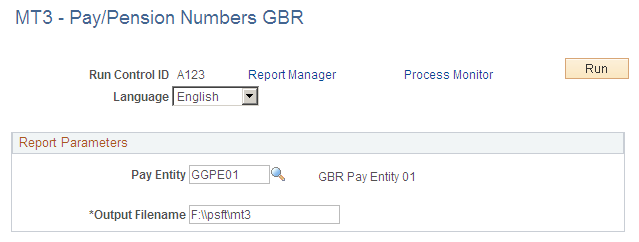

Use the MT3 - Pay/Pension Numbers GBR page (GPGB_PPIN_FL) to run the Pay/Pension Numbers process.
Navigation:
This example illustrates the fields and controls on the MT3 - Pay/Pension Numbers GBR page.
Field or Control |
Description |
Pay Entity |
Select the pay entity you want to process. Note: You must set up the tax district and HMRC reference numbers associated with this pay entity before you run this process. Use the Pay Entity Details page to define these tax details. |
Output Filename |
Enter the name for the output file. Refer to the HMRC guidelines for file naming conventions. |
See HM Revenue and Customs Submission Instructions and Technical Specifications "Updating of Pay/Pension Identity Numbers" – Reference MT3
