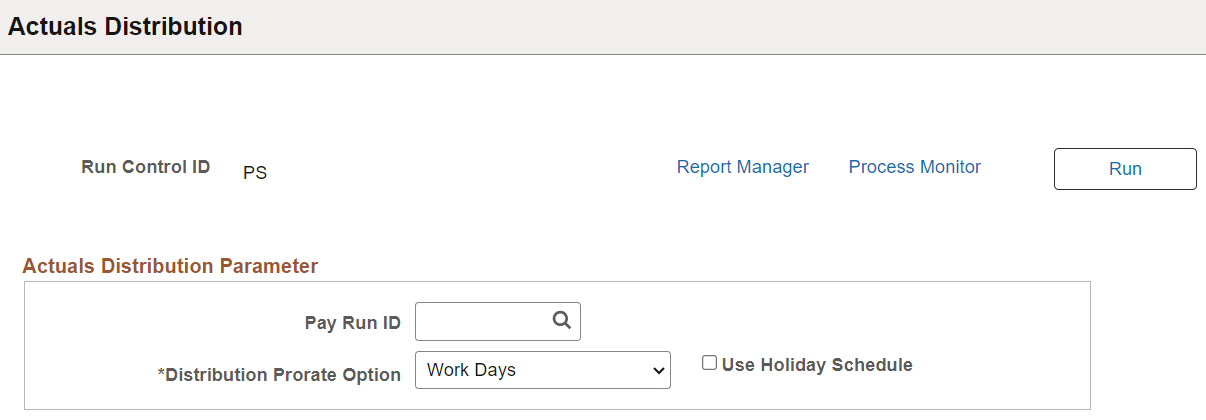

Use the Actuals Distribution page (RUNCTL_PPFUND) to run the Actuals Distribution process (PSPPFUND), which distributes actual earnings, employer deductions, and employer taxes across the funding sources and notifies you when you've exceeded any budget amounts.
Note: Before using this page, you must run a Pay Confirmation process.

This example illustrates the fields and controls on the Actuals Distribution page.
Actuals Distribution Parameter
Field or Control |
Description |
Pay Run ID |
Select the Pay Run ID. |
Distribute Prorate Option |
You must select either of the following options: Calendar Days: The system uses calendar days to calculate prorated amounts across accounting periods Work Days: If you select this and Use Holiday Schedule, the process prorates by work days, excluding holidays. If you select Work Days and do not select Use Holiday Schedule, the process prorates by working days, including holidays. |
Use Holiday Schedule |
Indicate if the process should exclude holidays (based on the holiday schedule) when using Work Days to prorate distribution. |

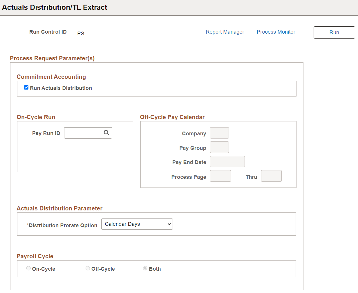

Use the Actuals Distribution/TL Extract page (PY_TL_XTRACT_COST) to run the Actuals Distribution process and extracts cost information from Time and Labor to distribute actual earnings, employer deductions, and employer taxes across the funding sources and notifies you when you've exceeded any budget amounts.
Before using this page, you must have run a Pay Confirmation process.

This example illustrates the fields and controls on the Actuals Distribution/TL Extract page.
Commitment Accounting
Field or Control |
Description |
Run Actuals Distribution |
Select to run the Actuals Distribution process. |
On-Cycle Run
If you are processing an on-cycle run, select the Pay Run ID.
Off-Cycle Pay Calendar
If you are processing an off-cycle run, select the Company, Pay Group, and Pay End Date. Enter the page range in the Page # and Thru fields.
Field or Control |
Description |
Distribution Prorate Option |
If you are prorating actuals across accounting periods, you can prorate using calendar or work days. Select one of the following options for the prorate option: Calendar Days: The system uses calendar days to calculate prorated amounts across accounting periods Work Days: If you select this and Use Holiday Schedule, the process prorates by work days, excluding holidays. If you select Work Days and do not select Use Holiday Schedule, the process prorates by working days, including holidays. |
