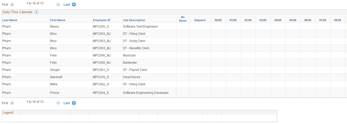

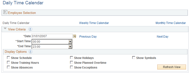

Use the Daily Time Calendar page (TL_WV_DAILY) to use the Daily Time Calendar page to view detailed information regarding time reporters' daily time related data for a specific date.
The page defaults to the current date.
Navigation:
This example illustrates the fields and controls on the Daily Time Calendar page (1 of 2). You can find definitions for the fields and controls later on this page.
This example illustrates the fields and controls on the Daily Time Calendar page (2 of 2). You can find definitions for the fields and controls later on this page.
This page provides an overview of a manager's time reporters' work time on a specified day. When accessing the page, all time reporters for the manager are listed and reported time for the current day (00:00 – 23:00) is displayed.
The Sum column displays the total time recorded for each time reporter for the selected viewing period. For punch time reporters, the sum represents the time between each in and out punch. If no out punch exists, the lesser of either current time or the selected period end time is used as the out time for the calculation.
On the daily calendar for example, if a time reporter records an in punch at 1:00 p.m. and the selected calendar view range runs from 8:00 am to 4:00 p.m., the sum would report four hours for this time reporter. For elapsed time reporters, the Sum column will display reported hours that are associated to TRCs that were found in the TRC List(s) designated on the View Options page.
On the daily calendars, punch time reporters recorded punch times display in the applicable time slot using the color/symbol for the Default Reported/Payable Time. If a symbol is specified for the time event, the punch time is preceded by the symbol and a dash. If a subsequent punch time event occurs within the same time slot, the time of this next event is appended with a dash separating the times. For time slots where no actual punches occur that are subsequent to a time-in punch and prior to a time-out punch, the color/symbol alone is displayed. For a time where a scheduled event such as training also occurs (the Show Training option must be selected) the color/symbol with the highest priority displays in the time slot.

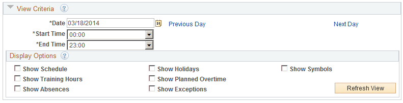

Field or Control |
Description |
Previous Day and Next Day |
Navigate forward and backward keeping the same view criteria and time period selection. |
Start Time and End Time |
Select the range of time you choose to view for the daily calendar. The time calendar displays the time data for the specified range incrementing in one-hour slots. Time displays in military time only. These fields do not appear on the weekly or monthly calendar views. The times you set will remain the default times when accessing the daily calendar view pages. |
Show Planned Overtime |
Select to display requested and approved overtime. If reported time overlaps with requested or approved overtime time, the reported time appears in the hour grid and the Elapsed time column reflects the additional overtime amount. |
Show Training Hours |
Select to display the requested and approved training hours. If training hours have been requested or approved for a time reporter, the grid displays the hours requested or approved will display, depending on the priority settings. Only reported hours calculate in the Sum column. Hours displayed but not reported (requested, approved, scheduled) are not included in the Sum calculation. |
Field or Control |
Description |
Show Absences |
Select to display requested and approved absences as well as "no show" information. If a time reporter is scheduled to work but has not punched in and the scheduled start time has elapsed, then "no show" appears in a separate No Show column. If reported time overlaps with requested or approved absence time, the reported time appears in the hour grid and the Elapsed time column reflects the additional absence time. If "Half" or "All" days were selected for an absence without hours being specified, the system uses the scheduled hours to determine how many hours to display if a schedule exists. If no schedule exists or if the day is an "Off" day, the system uses a default number of hours defined on the Calendar View Options Setup page. |

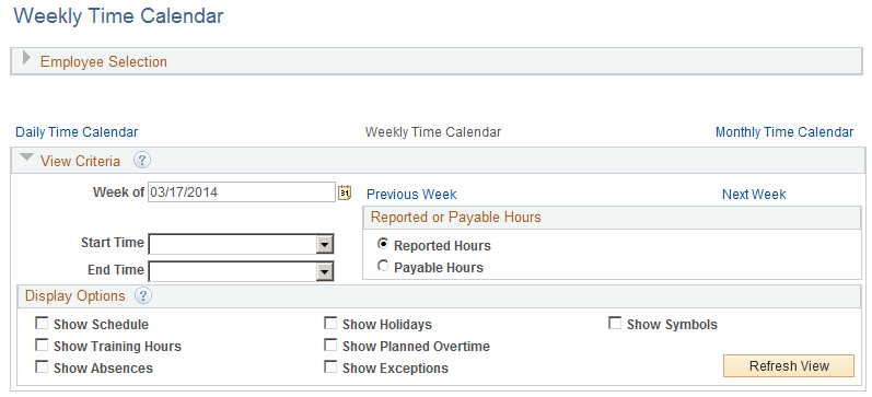

Use the Weekly or Monthly Time Calendar page (TL_WV_WEEKLY) to view detailed information regarding time reporters' weekly or monthly time related data for a specific time period.
Navigation:
Navigation:

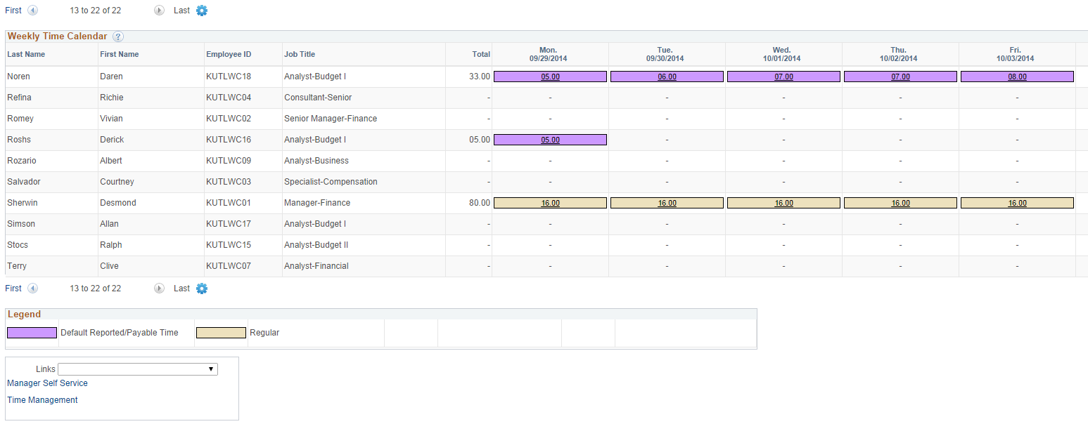

This example illustrates the fields and controls on the Weekly Time Calendar page (1 of 2). You can find definitions for the fields and controls later on this page.
This example illustrates the fields and controls on the Weekly Time Calendar page (2 of 2). You can find definitions for the fields and controls later on this page.
Note: The previous screenshot does not display the entire page. Scroll to the right on your system to view all of the fields on the page.
The Weekly and Monthly Time Calendar pages provide managers with an overview of their time reporters' reported time and other time related data for a specific week or month.
If reported or payable time exists for a time reporter, the hours quantity displayed in the cell is associated to that reported or payable time. The time displays as a link in the cell. If multiple TRCs are reported by a time reporter for a specific date, the reported or payable hours appear for that date with the color and symbol for the TRC with the highest priority appearing as the link. Click this link to view details on the reported or payable time.
If no reported or payable time exists but another time event item does, the quantity and symbol (if Show Symbolsis selected) of the next highest priority item will the cell displays.
The Sum column displays the total time for the selected viewing period. For punch time reporters, the sum represents the time between each in and out punch.
If no out punch exists, the system uses the end of the day (24:00); if no in punch exists, the system uses the beginning of the day (00:00).
Field or Control |
Description |
Previous Week and Next Week, Previous Month and Next Month |
Reported Hours / Payable Hours |
Use these options to select either reported or payable hours for viewing. These options appear only on the weekly and monthly time calendar views. |
Select to display requested and approved overtime. |
Select to display the requested and approved training hours. If training hours have been requested or approved for a time reporter, the hours requested or approved will display, depending on the priority settings. Only reported hours calculate in the Sum column. Hours displayed but not reported (requested, approved, scheduled) will not be included in the Sum calculation. |
Show Absences |
Select to display requested and approved absences. If "Half" or "All" days were selected for an absence without hours being specified, the system uses the scheduled hours to determine how many hours to display if a schedule exists. If no schedule exists or if the day is an "Off" day, the system uses a default number of hours defined on the Calendar Options Setup page. |
