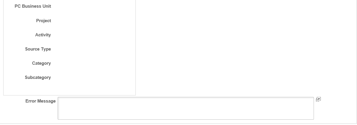

Error Message |
Displays a detailed error message when a pre-interface transaction error occurs. |

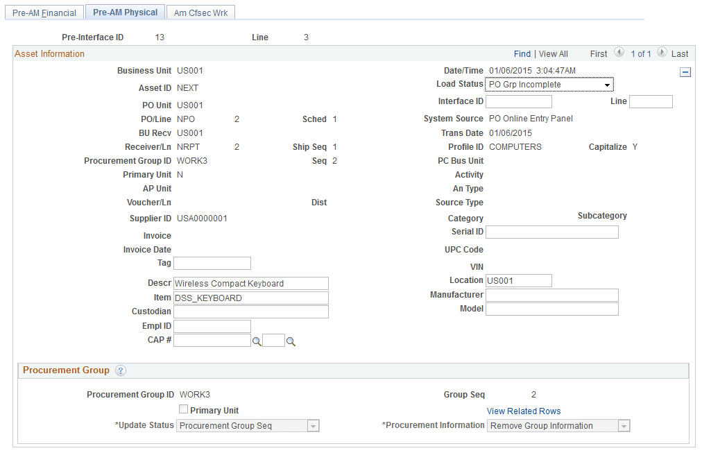

Use the Pre-AM Physical page (INTFC_PRE_AM_01) to review the physical asset data loaded in the pre-interface (Pre-AM 1) table.
Navigation:
This example illustrates the fields and controls on the Pre-AM Physical Page. You can find definitions for the fields and controls later on this page.
Field or Control |
Description |
Procurement Group ID |
Displays the Procurement Group ID for the asset, if applicable. A procurement group ID is an identifier that is used to associate multiple related purchased items for an asset. The Procurement Group ID can be assigned to a group of procurement transaction lines on a single purchase order or across multiple purchase orders. See Consolidating Requisition and Purchase Order Lines for Asset Components |
Seq (sequence) |
Displays the Procurement Group Sequence number. Each transaction within a procurement group ID is assigned a procurement group sequence number. |
Primary Unit |
Displays the item that is the designated primary unit for the asset. The primary unit for the procurement group ID is assigned on the Procurement Group page. When an item is flagged as a primary item, a separate transaction is inserted into INTFC_PRE_AM in increments of the unit allocation quantity or amount and has its own sequence number. |
Asset Management enables you to add assets from existing POs and receipts, r from existing accounts payable vouchers.
Note: If the fields on this page are changed, the voucher data may not match the PeopleSoft Asset Management data. In this case, the load status of the inconsistent rows should be set to Errored. You should then correct the voucher and resend it to PeopleSoft Asset Management. Physical information can be changed here because it does not affect capitalization or depreciation. In case AMPS1000 sets the status to Errored, you need to check the message log on the process monitor for the error message. Care should be taken to keep these changes in sync with purchasing and receiving data.

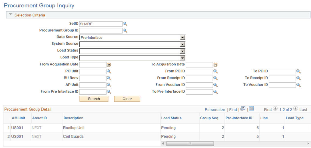

Use the Procurement Group Inquiry page (AM_PO_GROUP_INQ) to review procurement group details and statuses.
Navigation:
This example illustrates the fields and controls on the Procurement Group Inquiry Page. You can find definitions for the fields and controls later on this page.
Selection Criteria
Enter any criteria for the procurement group for which you want to review details.
Field or Control |
Description |
Select to limit your search results to a specific procurement group ID. A procurement group ID is an identifier used to associate multiple related purchased items. The Procurement Group ID can be assigned to a group of procurement transaction lines on a single purchase order or across multiple purchase orders. See Consolidating Requisition and Purchase Order Lines for Asset Components. |
Data Source |
Select one of the following data sources if you want to further limit your search results:
Procurement Group Detail
Field or Control |
Description |
Group Seq (group sequence) |
Displays the Procurement Group Sequence number. |
Unit |
Displays the Asset Management Business Unit. |
PO |
Click this link to drill into the PO_LINE_INQ page. See Purchase Order Inquiry Page |
Voucher |
Drill to AP_VOUCHER_INQUIRY. See Voucher Inquiry Page |
