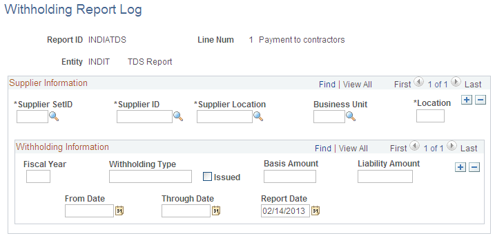

The Withholding Report Log page displays the relevant information for each of the respective types of payment summaries issued during the financial year. Payments summaries which you have issued to your Payees, and which should be included in the Payment Summary Statement, must have the Issued check box selected. For all payment summary printouts that are duplicated, deselect the Issued check box to exclude them from the Payment Summary Statement.
After you choose all the withholding report history on the Withholding Report Log page by selecting or deselecting the check boxes, you can execute the PAYG Payment Summary Statement process from the Withholding Summary page. For form printing using impact printers, deselect the Draft Flag check box. For draft print mode, select the Draft Flag check box. To freeze the fiscal year so that no one can modify the data once you have reported it to the ATO, select the Close Fiscal Year check box.

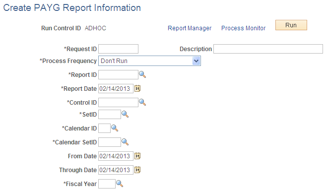

Use the Create PAYG Report Information page (WTHD_POST_BY_DATE) to post withholding data to the Withholding Report table.
Navigation:
This example illustrates the fields and controls on the Create PAYG Report Information page. You can find definitions for the fields and controls later on this page.
Field or Control |
Description |
Control ID |
Select a business unit in the first field then select the control ID. These fields determine which business units and suppliers to include. |
Calendar ID |
Select the SetID of the calendar you want to use in the first field. In the second field, select the ID of the calendar you want to use. |
From Date |
Select the first date from which you want to generate data. |
Through Date |
Select the last date from which you want to generate data. |
Fiscal Year |
Select the fiscal year for which you want to generate data. |

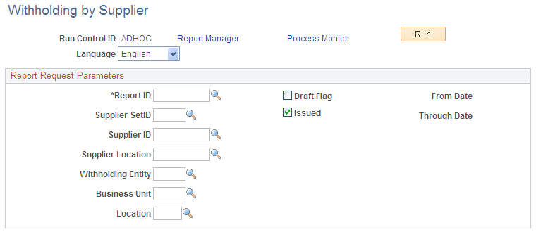

Use the Withholding by Supplier page (WTHD_RPT_RUN2) to run the PAYG Voluntary Agreement, PAYG Labour Hire, and PAYG No ABN Quoted reports.
Navigation:
This example illustrates the fields and controls on the Withholding by Supplier page. You can find definitions for the fields and controls later on this page.
Field or Control |
Description |
Issued |
Select this check box to flag the payment to be included in the Payment Summary Statement process. Deselecting the Issued check box represents a duplicate print to be excluded from the process. |

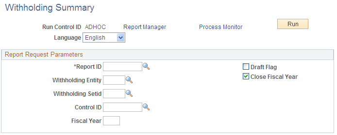

Use the Withholding Summary page (WTHD_RPT_RUN3) to run the PAYG Payment Summary Statement and PAYG No ABN Quoted Summary Statement reports.
Navigation:
This example illustrates the fields and controls on the Withholding Summary page. You can find definitions for the fields and controls later on this page.
Field or Control |
Description |
Withholding SetID |
Select the SetID associated with the withholding entity for which you want to run the summary reports, |
Control ID |
Select the control ID. This field determines which business units and suppliers to include. |
Fiscal Year |
Enter the fiscal year that you want to display on the report. |
Close Fiscal Year |
Select this check box to freeze the fiscal year so that no one can modify the data once you have reported it to the ATO. |
Use the Withholding Report Log page (WTHD_RPT_LOG_LC) to adjust or enter payment summary data manually.
Navigation:
This example illustrates the fields and controls on the Withholding Report Log page. You can find definitions for the fields and controls later on this page.
Field or Control |
Description |
Fiscal Year |
Enter the fiscal year for which you are making entries or adjustments. The entry in this field determines whether it appears on the PAYG Payment Summary Statement for a given year. It is your responsibility to ensure that the fiscal year matches the from and through dates that you indicate and also the contents of your Payment Summaries. The system does not validate according to the Australian fiscal year calendar. |
Withholding Type |
Enter the type of withholding for which you are making an entry or an adjustment. Make sure the withholding type is correct for the supplier type. It should be either VOLAG, LABHR, or NOABN in capital letters. The system expects all suppliers to be of the same withholding type. The APY8044 process only selects the VOLAG and LABHR withholding types. |
Issued |
Select this check box to indicate that you have issued a payment summaries to the supplier. |
Basis Amount |
Enter the amount upon which the withholding was calculated. Make sure the amounts you enter on this page agree with the payment summaries you issued. |
Liability Amount |
Enter the amount of the withholding liability. |
