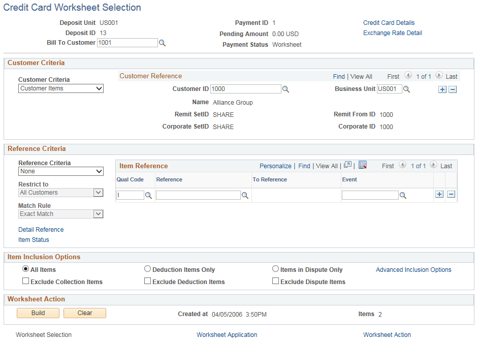

Use the Credit Card Worksheet Selection page (PAYMENT_IDENT_IC) to create a new worksheet, modify an existing one, and select items to include in the worksheet.
Navigation:
This example illustrates the fields and controls on the Credit Card Worksheet Selection page. You can find definitions for the fields and controls later on this page.

Customer Criteria and Reference Criteria
The information that you enter about customers and items determines the information that appears on the worksheet. The more information you provide, the more focused your worksheet will be. For example:
If you enter only customer information, the worksheet will list all open items for the customer.
If you enter only item information, the worksheet will list all open items that match your item criteria for all customers.
If you enter both customer and item information, the worksheet will list all the open items that match the customer and item criteria that you select.
Note: If you enter no customer or item information, the system will create a blank worksheet.

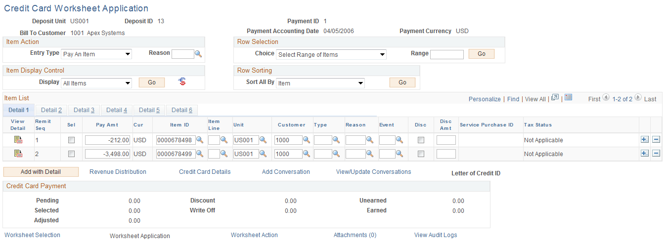

Use the Credit Card Worksheet Application page (PAYMENT_WS_IC) to select items for payment by credit card.
Navigation:
This example illustrates the fields and controls on the Credit Card Worksheet Application page. You can find definitions for the fields and controls later on this page.
To use the credit card worksheet, follow these high-level steps:
Use the item display or sort controls to adjust the view.
Select the items to pay.
Manage underpayments and discounts.
Overpayments are not allowed on credit card worksheets that have not been authorized and settled.
Check the information in the Credit Card Paymentgroup box to verify the amount of the credit card payment based on the selected items.

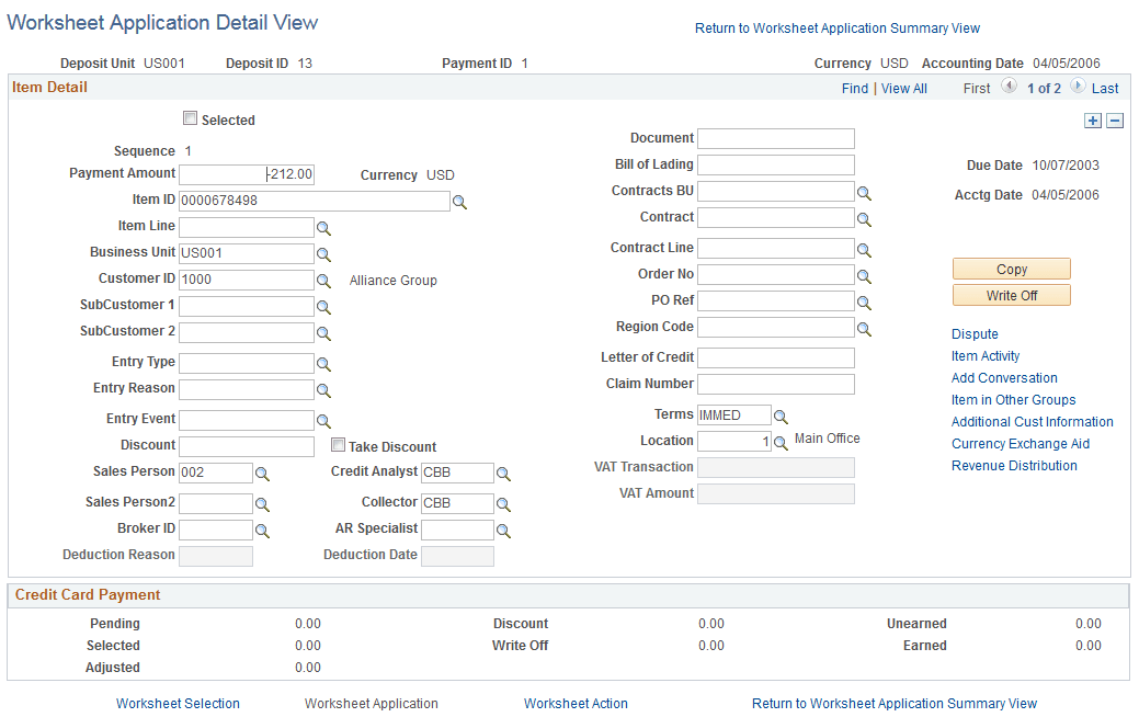

Use the Worksheet Application Detail View page (PAYMENT_WS_IC_DTL) to view or update details about a selected item on a worksheet or copy, write off, or edit items.
Navigation:
Click the View Detail button on the Credit Card Worksheet Application page.
This example illustrates the fields and controls on the Worksheet Application Detail View page. You can find definitions for the fields and controls later on this page.
View item details to identify an item or change the details.
Field or Control |
Description |
Deduction Reason |
If you are creating a new deduction, enter the reason why the customer took the deduction. You define reason codes on the Deduction Reason page. |
AR Specialist (accounts receivable specialist) |
The system populates the AR Specialist field for deduction items based on the default specialist that you assigned to the business unit. If you overrode the default specialist for the deduction reason or customer, the system uses that value. |
Document |
If you enter a value that matches an existing item ID, the system automatically populates the Bill of Lading, Order No (order number), PO Ref (purchase order reference), Contract # (contract number), Letter of Credit ID, and Due Date fields with the value for the existing item when you save or refresh the page. If you receive different information for these fields with the payment, override those values. If you are creating a payment for a vendor rebate claim item or claimback item that you interfaced from PeopleSoft Purchasing or PeopleSoft Order Management, you must enter a reference ID. When you run the Rebate Notification process, it sends the reference ID to PeopleSoft Purchasing and PeopleSoft Order Management for use in reconciling the claims on the claims management workbench. This field is available for entering existing items only if you enter entry reasons on the AR Integration page. |
Location |
Enter the address sequence number for new items. You must enter a value in this field to include the item in correspondence if you selected the Item Address option for the correspondence customer on the Correspondence Options page. |
Copy |
Click to copy the item and add a new row to the worksheet. You must add the amount and entry type to the new row. |
Write Off |
For a new item, click to write off an underpayment amount. |
Dispute |
Click to access the Dispute Status Tracking page and view dispute status information for an item. This link appears only when dispute tracking data exists for the item. |
Note: To save your changes on this page, return to the Worksheet Application page.

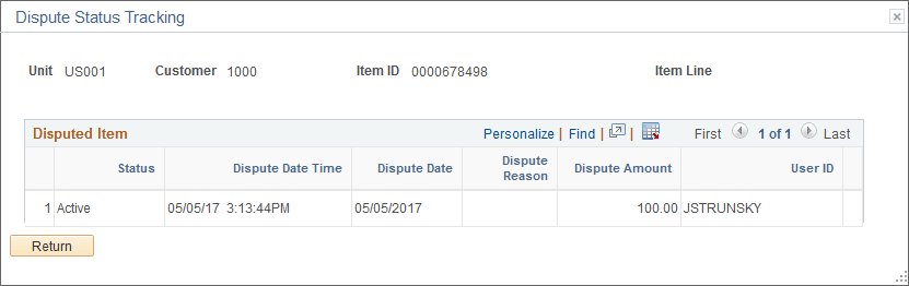

Dispute Status Tracking Page
Use the Dispute Status Tracking page (ITEM_DISP_T) to view dispute status information for an item.
This example illustrates the fields and controls on the Dispute Status Tracking page.
Use the Credit Card Worksheet Action page (PAYMENT_ACTION_IC) to select posting options for the payment applied on the credit card worksheet, including entry events.
Navigation:
Click the Worksheet Action link on the Credit Card Worksheet Selection page or the Worksheet Application page.
Field or Control |
Description |
Delete Worksheet |
Click to delete the entire worksheet, plus any accounting entries created for the worksheet. If the associated credit card transaction has not been settled, the entire payment is deleted, releasing any items selected on the worksheet. If the associated credit card transaction has been settled, the payment is not deleted, but items selected on the worksheet are released. The settled payment must be unposted before the Delete Worksheet button becomes available. |
Delete Payment Group |
Click to delete the accounting entries that you create but leave the worksheet intact. |
Pay by Credit Card |
Click to access the Credit Card Details page to begin credit card processing. |
Action |
Select a posting action for the group and click OK to execute the action. Note: The posting options that are available depend on the options that you select for the user on the Define User Preferences - Process Group page. Use the Post Now and Post Now to GL options only for small groups or when the transaction must be posted immediately. The system issues a message if another user or scheduled process is posting transactions for the same business unit and customer combination at the same time. |
Create/Review Entries |
Click to create or review accounting entries. Use this option only if you need to review or modify the accounting entries. Otherwise, use one of the posting actions to create the accounting entries. |
Note: If the worksheet does not have a zero balance but you need to stop working with the worksheet, save your work and select Do Not Post for the posting action.
