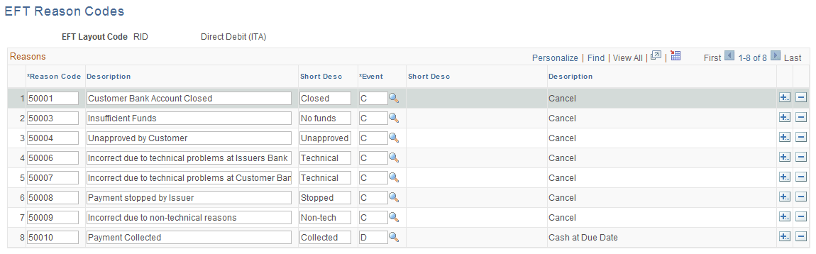

Use the EFT Reason Codes page (EFT_BANK_REASON) to set up reason codes for draft processing.
Navigation:
This example illustrates the fields and controls on the EFT Reason Codes page. You can find definitions for the fields and controls later on this page.
Field or Control |
Description |
Reason Code |
Enter a user-defined reason code and description. |
Event |
Enter the appropriate draft business event, such as 10 (Void Draft) or F1 (Draft at Due Date) that the system should use to set the status for payment records returned with this reason. |
Post Action |
Indicate whether the system should use the actual or dishonored rules that you defined for the business event. Values are Actual or Dishonor. |
