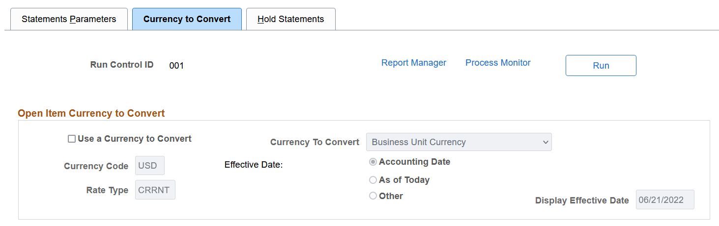

Use the Currency to Convert page (RUN_AR32001_CUR) to select the type of currency to appear on Open Item statements, and select the effective date.
Navigation:
This example illustrates the fields and controls on the Currency to Convert page. You can find definitions for the fields and controls later on this page.
The default values for the fields depend on the values that you enter on the Receivables Options - Currency Display Options page for the business unit. Override the values if you want to use a different display currency on the statements.
Field or Control |
Description |
Use a Currency to Convert |
Select to print statements by using the default display currency that you specify in the Currency to Convert field. |
Select the type of currency for the statements: Business Unit Currency: Select to use the default currency that is defined for the business unit. Customer Default Currency: Select to use the preferred currency that is defined for the customer on the General Info page. Other: Select to use the currency that you enter in the Currency Code field. Then, enter the exchange rate type and specify whether to use today's date, the accounting date, or another date that you specify as the effective date. |

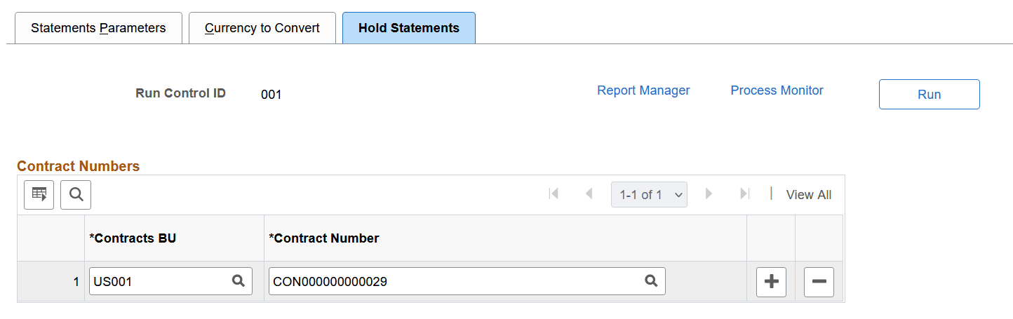

Use the Hold Statements page (RUN_AR32001_CNTR) to exclude invoices from the statement document based on correspondence customers associated with a contract.
Note: This page is only visible if you have installed PeopleSoft Contracts.
Navigation:
This example illustrates the fields and controls on the Hold Statements page. You can find definitions for the fields and controls later on this page.
Field or Control |
Description |
Contracts BU (Contracts Business Unit) |
Enter the business unit associated with the contract. |
Contract Number |
Enter the contract number. When you select the Run button, any invoices associated with the correspondence customer of the contract are excluded from the Statement document. Note: The contract you enter must be an active contract. |

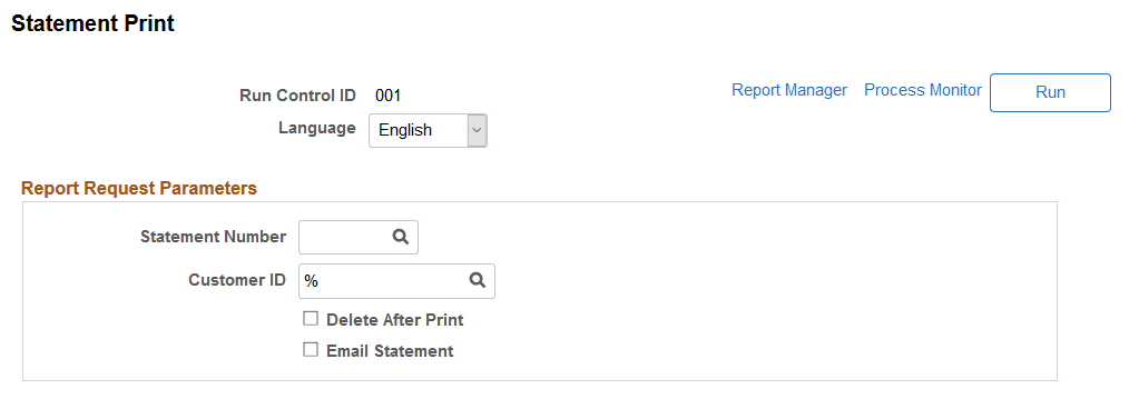

Use the Statement Print page (RUN_AR32000) to print statements.
Navigation:
This example illustrates the fields and controls on the Statement Print page.
Field or Control |
Description |
Language |
Select the language for the statements. |
Statement Number |
Displays the most recent number for the run control ID that is not printed. Select a different number to print a different request. Note: Each time that you run the Statements multiprocess job (ARSTMT), each AR_STMT# child process generates a statement number and applies it to all statements that the run for that child process generates. For example, the AR_STMT1 child process retrieves data for 37 statements and assigns statement number 64. When you print statement number 64, you get 37 statements. You do not have to run the report 37 times. |
Email Statement |
Select this option to have individual customer statements emailed to all correspondence customers that have the preferred communication method of Email Only or Email and Print, defined on the Contact Information - Maintain Contacts Page. Filenames are automatically provided for the PDF statements using this method: Correspondence Customer SetID + Correspondence Customer ID. For example, SHARE1000.pdf. Note: The email is sent to the correspondence customer’s primary contact. A valid email address must be defined for primary contact on the Contact Information - Maintain Contacts Page. In addition, select the Primary Bill To option for primary contact using the Contact Information – Contact Customers Page. This option only applies to these reports: ARX32000 (Customer Balance Statement), ARX32001 (Balance Forward Statement), and ARX32002 (Customer Balance with Draft). For each email processed, a statement email log information is created. For more information, see Statement Email Log Page. |

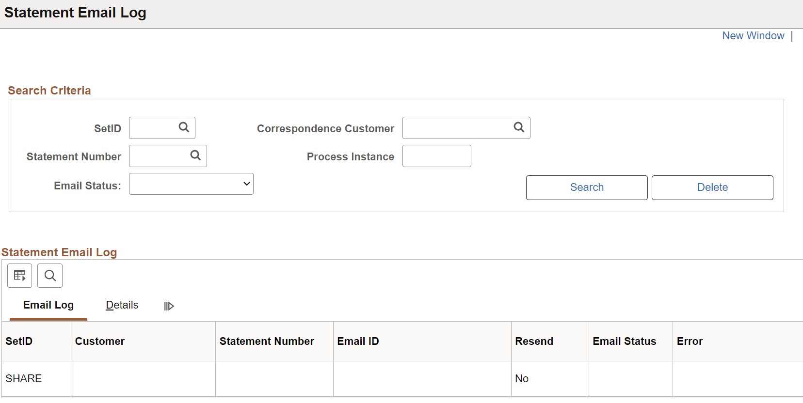

Use the Statement Email Log page (STMT_EMAIL_LOG) to review the Statement email log. You can delete the Statement email log entries using the Delete button. The email log entries will be deleted based on the search criteria.
Navigation:
This example illustrates the fields and controls on the Statement Email Log page
