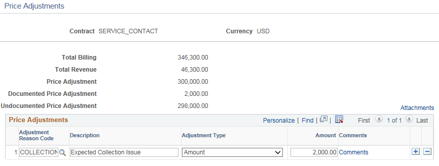

CA_PRC_ADJ_PNL |
Document the reasons for any differences between total billing and total revenue on the contract. |

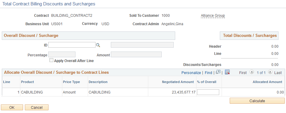

CA_HDR_REDUC_PNL |
Apply a header level discount or surcharge for billing. |

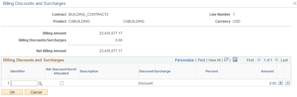

CA_LN_REDUC_PNL |
Apply specific line level discounts and surcharges for billing. |

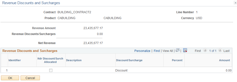

CA_LN_RED_REV_PNL |
Apply specific line level discounts and surcharges for revenue. |
CA_LN_DISC_PG |

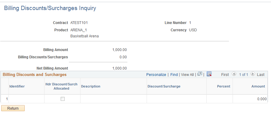

View discounts and surcharges for billing that are associated with an individual line. This page is not available for rate and recurring contract lines. |

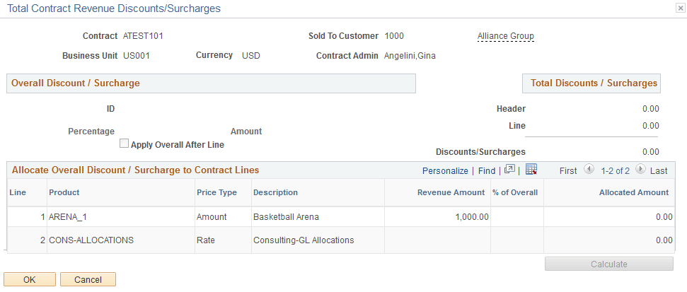

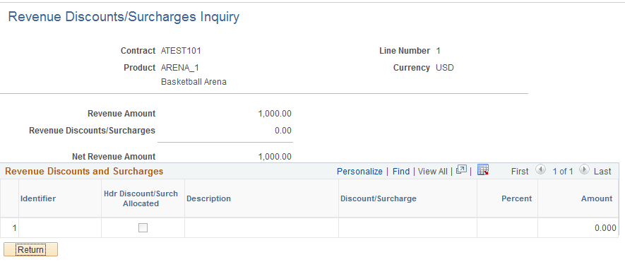

CA_LN_REV_DISC_PNL |
View discounts and surcharges for revenue that are associated with an individual line. |
Billing Discounts/Surcharges for Consolidated Target Line Page |
CA_RNW_CYC_RED_SEC |
Enter billing discounts and surcharges that will be copied onto the new contract line created upon the approval of the cycle. This page is available only if the Create Target Lines option is set to Consolidated. |
Revenue Discounts/Surcharges for Consolidated Target Line Page |
CA_RNWCYC_REVD_SEC |
Enter revenue discounts and surcharges that will be copied onto the new contract line created upon the approval of the cycle. This page is available only if the Create Target Lines option is set to Consolidated. |

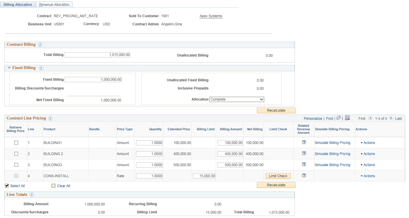

Use the Billing Allocation page (CA_PRICING_PNL) to identify the total billing amount on the contract as well as to allocate that amount across contract lines. Fixed Billing amounts are allocated to amount based contract lines. This includes header and line level discount and surcharge amounts for billing. Specify the basis for allocating amounts onto percent-based lines. Options for calculation include a percentage applied to amounts on other contract lines or a percentage applied to the total fixed billing amount on the contract. Billing limits are allocated to rate based contract lines and recurring amounts are assigned to recurring type contract lines.
Navigation:
This example illustrates the fields and controls on the Billing Allocation Page. You can find definitions for the fields and controls later on this page.
Note: When working in the Billing Allocation page, you can save your work at any time by clicking Save. When you click Save, any allocations that you make are reflected in the pricing fields across all PeopleSoft Contracts components using these values.
Discounts/Surcharges related fields are applicable to only Standard contracts and amount/percent based contract lines.

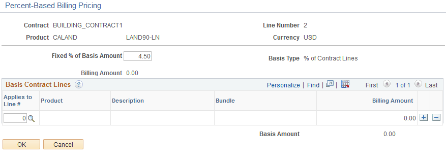

Applicable for percent based lines. If the percent based line is priced using % of Lines option then this value can be changed on Percent-Based Billing Pricing page. If the percent based line is priced using % of Total then its value is derived from the Order Management module. |
Basis Type |
Applicable for percent based lines, use this page to identify a basis for the calculation and the percentage. |

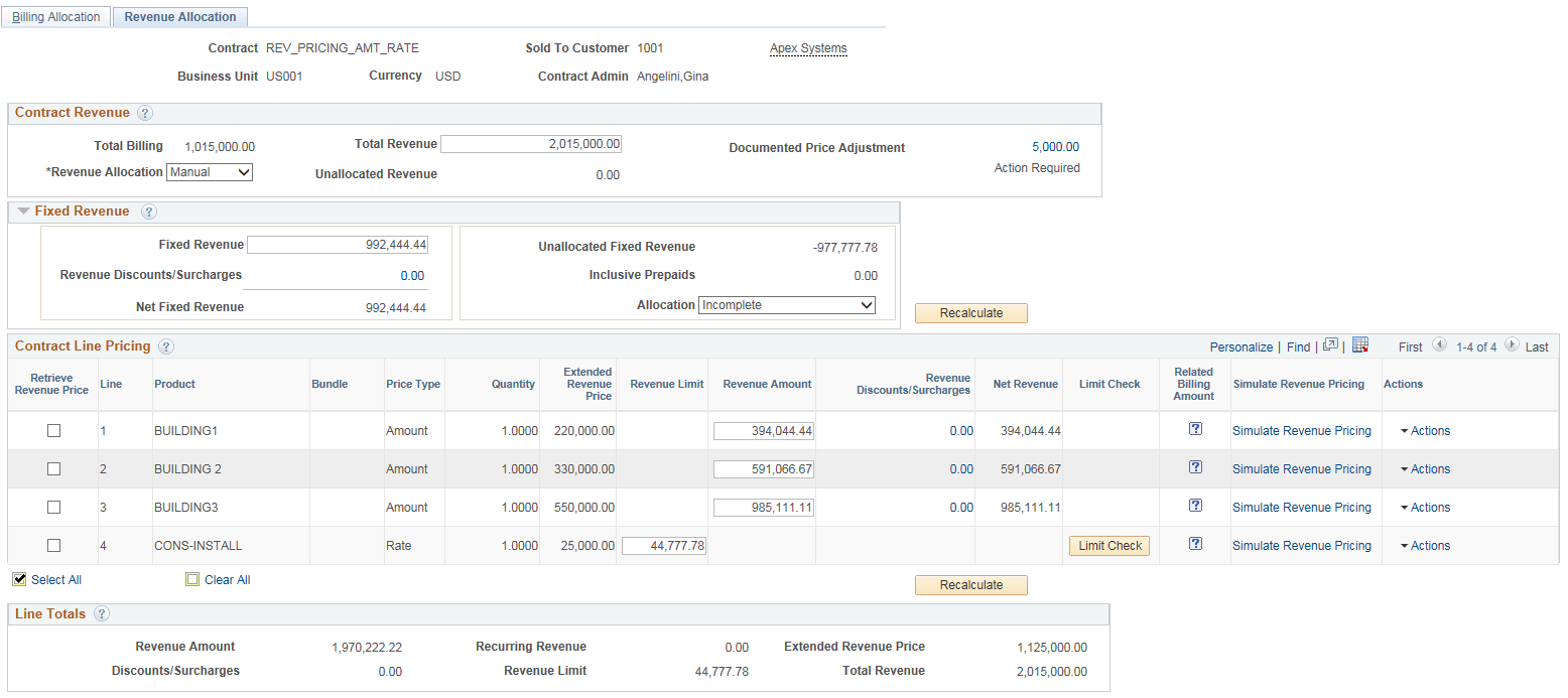

Use the Revenue Allocation page (CA_PRICING_REV_PNL) to identify the total revenue amount on the contract and to allocate that amount across contract lines. The Revenue Allocation page is editable if billing and revenue are separated on the contract. If billing and revenue are not separated on the contract then the Revenue Allocation page is read only and amounts are programmatically updated from the Billing Allocation page. The ability to edit data on the Revenue Allocation page is specific to the contract line type (amount or as incurred) and whether those line types separate billing and revenue on the contract. It is possible to separate billing and revenue on amount based lines and not to separate them on as incurred lines and vice versa. The line types identified as separate for billing and revenue while creating the contract are editable on the Revenue Allocation page. Recurring contract lines are never editable since revenue plans are not assigned to these lines and revenue is recognized equal to the amount billed.
See Defining General Contract Information
Navigation:

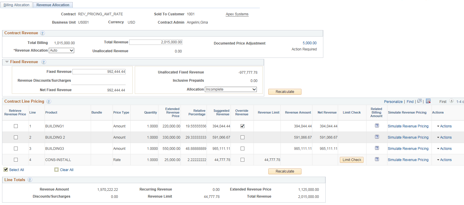

This example illustrates the fields and controls on the Revenue Allocation page - Manual option. You can find definitions for the fields and controls later on this page.
This example illustrates the fields and controls on the Revenue Allocation page - Auto option. You can find definitions for the fields and controls later on this page.
This page is used for pricing revenue on contracts in Pending status. For active contracts the pricing is tracked through the amendment process on the Amendment Revenue Allocation page.

Documented Price Adjustment |
Click the price link to access the Price Adjustments page. Use this page to document the reasons for any differences between Total Billing and Total Revenue. |

Revenue Discounts/Surcharges |
Use this to update header level discounts or surcharges for revenue before contract activation. Also, included in the display is the sum of all line level discounts and surcharges for revenue. The hyperlink will be display only and the value for this field is defaulted from the Billing Discounts/Surcharges field on the Billing Allocation page if the Separate Fixed Billing and Revenue check box is not selected on the contract. Note: This link appears only for Standard contracts. |
Net Fixed Revenue |
Displays the net revenue amount for amount and percentage based lines after discounts and surcharges. System calculates this by subtracting Revenue Discounts/Surcharges from Fixed Revenue. |
Applicable for amount and percent based lines on Standard contracts, click this link to identify contract line specific discounts. The value for this field will default from the billing discounts/surcharges field on the Billing Allocation page if the Separate Fixed Billing and Revenue check box is not selected on the contract. When you assign revenue discounts to a contract line, the system generates discount specific accounting distributions on the Accounting Distribution Discounts /Surcharges page and the revenue discount amount is used there. If the contract does not Separate Fixed Billing and Revenue then the billing discount is used to create the revenue discount. |
Net Revenue |
Applicable for amount and percent based lines on Standard contracts, displays the Net Revenue amount after subtracting discounts or surcharges from the Revenue Amount. |
Recurring Revenue |
Displays the recurring revenue amount for recurring contract lines. The value always matches recurring billing and can be modified on the Billing Allocation page only. Recurring contract lines cannot be added to contracts that opt to Separate Fixed Billing and Revenue since revenue plans are not assigned to these lines and revenue always equals the amount billed. Note: This field is visible only for standard and internal contracts. |
Awarded Cost |
Applicable for rate based contract lines on government contracts and always display only, the amount can be edited on the Billing Allocation page. |
Revenue Limit |
Applicable for rate based lines, the revenue limit works as follows:
Note: If the Revenue Allocation is set to Manual and the Retrieve Revenue Price check box is selected, then the Revenue Limit is updated with the latest extended revenue price in Order Management and the Enterprise Pricer overriding any existing value. Similarly, for revenue allocations set to Auto where the contract line is set to Override Revenue, any previously entered revenue limits would be updated with extended revenue price. Note: Revenue Limit cannot be less than the revenue already processed. If the suggested revenue limit does calculate to a lesser amount, then you should select Override Revenue and increase your revenue limit to the amount already processed. Note: Much of the automated allocation functionality assumes the use of contract line revenue limits. With new functionality, organizations who enter a revenue limit of zero to indicate no revenue limit (or unlimited revenue) may need to update a newly defaulted default revenue limit to zero. |
Related Billing Amount |
Hover over this field to view the billing amount for the contract line. Applicable for all contract line types including amount, percent, rate and recurring. |
Limit Check |
Applicable for rate based contract lines, click to perform limit check for the contract line. Limit Check is not applicable for internal contracts. |
Simulate Revenue Pricing |
Click to open the Pricing Simulator page in Order Management. All relevant contract attributes to identify a specific product price are populated. This includes the fields identified on the Transaction Price-by Key page in Order Management. The Enterprise Pricer Transaction Code used to support contract revenue is RP and this is pre-populated on the page. The Start Date associated with the contract line is used as Effective Date. If contract line Start Date is not available then contract Sign Date is used. Note: This link is available only for amount and rate based contract lines. |
Actions |
Select a related action to navigate to the relevant pages. The actions available depend on contract classification and contract line price type.. Available related actions are:
Recalculate |
When you click this button, the system recalculates the unallocated revenue amount and unallocated fixed revenue amount and also sets the value of the allocation to Complete or Incomplete based on the Unallocated Fixed Revenue value. It also recalculates header and line level discounts when there is change in the discount percentage or a change in the contract line revenue amount. It also recalculates the fields under Line Totals group box. |
Line Totals
Similar to the Billing Allocation page, the line totals portion of the Revenue Allocation page summarizes the numbers entered in the contract line pricing grid.
Field or Control |
Description |
Revenue Amount |
Displays the total revenue amount for all amount and percent based contract lines. |
Revenue Limit |
Displays the total revenue limit amount for all rate based contract lines. |
Recurring Revenue |
Displays the total recurring revenue amount for all recurring contract lines. |
Displays the total header and line level discounts or surcharges for all amount and percent based contract lines. |
Total Revenue |
Displays the total revenue amount, recurring revenue, and revenue limits for all contract lines less discounts/surcharges if applicable. |
Use the Price Adjustments page (CA_PRC_ADJ_PNL) to document the reasons for any differences between total billing and total revenue on the contract.
Navigation:
. Click the Documented Price Adjustment hyperlink.
. In the Go To drop-down list box select Price Adjustments.
This example illustrates the fields and controls on the Price Adjustments page. You can find definitions for the fields and controls later on this page.
Field or Control |
Description |
Adjustment Reason Code |
Click the prompt to select from a list of predefined Adjustment Reason Codes. |
Description |
Enter suitable description or retain the defaulted description. |
Adjustment Type |
Select one of the available adjustment types:
Percentage |
The percent adjustment is applied on Total Billing and allows both positive and negative values. Since the most common usage is to identify a discount or a reduction for revenue, these should be entered as positive numbers. Surcharges or increases to arrive at Total Revenue should be entered as a negative percentage. |
Amount |
Enter the price adjustment as an amount. |
Comments |
Click to open the Price Adjustment Code Comments modal window and enter a detailed description of the price adjustment. |
Attachments |
Click to attach any relevant pricing documents. Note: If the value of price adjustments documented on this page does not equal the difference between Total Billing and Total Revenue, then a warning message is displayed indicating to the user that they have undocumented price adjustments. |
Use the Percent-Based Billing Pricing page (CA_DETAIL_PRCNG) to select the contract lines to which a percent-based line applies for billing.
For example, if you are licensing two software products for fixed amounts and one year of technical support priced at 30 percent of the value of the product licenses, select the contract lines for those product licenses in the Applies to Line field.
Navigation:
Click the % of Lines link on the Contract Line Pricing grid on Billing Allocation page.
Click the % of Lines link on the Billing Amount Detail tab on the Contract - Lines page.
This example illustrates the fields and controls on the Percent-Based Billing Pricing Page. You can find definitions for the fields and controls later on this page.
Note: If you access this page from the Billing Amount Detail tab of the Contract - Lines page, the values on the page are display-only.
Field or Control |
Description |
Fixed % of Basis Amount |
Enter the percentage to be applied. |
Basis Type |
Displays the basis type. Values are: % of Lines: Indicates that the pricing for this contract line is calculated as a percentage of the sum of the billing amounts of one or more contract lines. If the basis type is % of Lines, then you must select the appropriate lines in the Applies to Line # (applies to line number) column. % of Total: Indicates that the pricing for this contract line is calculated as a percentage of the total contract billing amount on the contract. |
Billing Amount |
Displays the calculated billing amount for the percent based contract line. |
Basis Contract Lines
Field or Control |
Description |
Applies to Line # |
Select the contract lines to which this % of Lines percent-based contract line applies. The list of values contains any active amount-based lines within the contract. The product, description, Bundle and billing amount for the line selected appear. Subsequent adjustments made to the billing amount of the source line(s) are reflected in the percent based contract line pricing for this product before the contract is activated. |
Basis Amount |
Displays the basis amount, which equals the sum of the billing amounts of all the applies-to lines that you select. For contract lines for which the basis type is % of Total, the basis amount is equal to the total Fixed Billing amount of the contract. |
Note: Once the contract is activated, existing percent based contract lines are treated as amount based contract lines. Hence the Billing Amount displayed on this page is an absolute value, not calculated based on a percentage and adjustments to the billing amount must be made similar to other amount based lines.

Use the Total Contract Billing Discounts and Surcharges page (CA_HDR_REDUC_PNL) to apply a header level discount or surcharge for billing.
Navigation:
Click the value in the Billing Discounts/Surcharges field in the header section of the Billing Allocation page.
This example illustrates the fields and controls on the Total Contract Billing Discounts and Surcharges Page. You can find definitions for the fields and controls later on this page.
Overall Discount/Surcharge
Field or Control |
Description |
ID |
Select an ID to populate the Description and Percentage or Amount fields with the information that is defined for the discount or surcharge ID. |
Percentage |
If you define a percent for the selected discount or surcharge ID, that percent appears and you can edit it. If you did not define a percent for the discount or surcharge ID, you can enter one here. Note: Discounts and surcharges are defined by either amount or percent. You can edit this field if you choose to define the discount or surcharge by percent . |
Amount |
If you define an amount for the selected discount or surcharge ID, that amount appears and you can edit it. If no amount is defined for the discount or surcharge ID, you can enter one here. Note: You can edit this field if you choose to define the discount or surcharge by amount . |
Apply Overall After Line |
Select to have the system apply the billing header level discounts or surcharges for billing to contract lines after it applies any contract line specific discounts or surcharges that you specify on the Billing Line Discounts and Surcharges page. |
Total Discounts/Surcharges
Field or Control |
Description |
Header |
Displays the value of the header level discount or surcharges for billing. You can define only one header level discount or surcharge for a contract, and the amount must be completely allocated across applicable contract lines. |
Line |
Displays the sum of all discounts or surcharges for billing that you define for individual contract lines on the Line Discounts and Surcharges page. This amount does not include discounts or surcharges that are allocated to lines from the billing header discount or surcharge. |
Displays the total billing discounts and surcharges for this contract after adding the billing header discounts or surcharges to the total billing line discounts. |
Allocate Overall Discount/Surcharge to Contract Lines
Field or Control |
Description |
Product |
Displays the product name, price type, description and billing amount for contract lines with an active status. |
% of Overall |
Enter the percent of the total header discount or surcharge to apply to the contract line. You can apply discounts and surcharges only to contract lines with a price type of Amount or Percent. |
Allocated Amount |
When you click Calculate, the system calculates the line discount or surcharge amounts for each line based on the values entered in the % of Overall column. |
Click OK to save your work. Discounts and surcharges amounts for billing will be updated on the Billing Allocation page.
Use the Total Contract Revenue Discounts/Surcharges page (CA_HDR_RED_REV_PNL) to apply header level discounts or surcharges for revenue. Discounts for revenue may be different from discounts applied for billing if the contract separates fixed billing and revenue. If the Separate Fixed Billing and Revenue check box is not selected on the contract, then this page is read only and amounts will match those used for billing.
Navigation:
Click the value in the Revenue Discounts/Surcharges field in the header section of the Revenue Allocation page.
This example illustrates the fields and controls on the Total Contract Revenue Discounts/Surcharges Page. You can find definitions for the fields and controls later on this page.
Field or Control |
Description |
Select to have the system apply the header level discounts or surcharges for revenue to contract lines after it applies any contract line specific discounts or surcharges that you specify on the Revenue Line Discounts and Surcharges page. |
Click OK to save your work. Discounts and surcharges for revenue will be updated on the Revenue Allocation page.
Use the Billing Discounts and Surcharges page (CA_LN_REDUC_PNL) to apply line level discounts and surcharges for billing.
Navigation:
Click the Billing Discounts/Surcharges link in the Contract Line Pricing section of the Billing Allocation page.
This example illustrates the fields and controls on the Billing Discounts and Surcharges Page. You can find definitions for the fields and controls later on this page.
Field or Control |
Description |
Billing Amount |
Displays the billing amount defined on the Billing Allocation page. |
Billing Discounts/Surcharges |
Displays the sum of the discounts and surcharges for billing that are listed in the group box. This amount includes the discounts and surcharges that are attached directly to the contract line, as well as the discounts and surcharges that are allocated from the contract header (Total Contract Billing Discounts and Surcharges page). |
Net Billing Amount |
Displays the net billing amount of this contract line after subtracting the sum of all discounts and surcharges from the line's billing amount. |
Identifier |
Select a discount or surcharges identifier for the contract line. The system populates the fields with the values that you define for the identifier (discount or surcharge). |
Hdr Discount/Surch Allocated |
The system selects this check box if the discount and surcharge was allocated from the header level discount or surcharge to this contract line on the Total Contract Billing Discounts and Surcharges page. This box is informational only. |
Discount/Surcharge |
Indicates whether this line is a discount or surcharge. |
Percent |
If you defined a percent for the discount or surcharge, that percent appears and you can edit it. If you did not define a percent for the discount or surcharge, you can enter one here. The system multiplies the percent by the billing amount to obtain the line discount amount. Note: Discounts and surcharges are defined by either amount or percent. You can edit this field if you choose to define the discount or surcharge by percent. |
Amount |
If an amount is defined for discount or surcharge, that amount appears and you can edit it. If you did not define an amount for the discount or surcharge, you can enter one here. Note: You can edit this field if you choose to define the discount or surcharge by amount. |
Apply At Renewal |
Select to make this discount or surcharge applicable for future renewals. This field appears for renewable contract lines only. This option does not apply if the contract line has already been renewed. This field is not available for contracts with an Active status unless you are in Amendment mode. Note: You cannot select this check box if the contract line to which the discounts or surcharges are applicable is already assigned to a renewal cycle with the Create Target Lines option set to Consolidated. Note: If you select the Apply at Renewal option for at least one discount on a contract line, you can only assign the contract line to a renewal cycle that has the Create Target Lines option set to Individual. |
Use the Revenue Discounts and Surcharges page (CA_LN_RED_REV_PNL) to apply line level discounts and surcharges for revenue. Discounts for revenue may different from discounts applied for billing if the contract separates fixed billing and revenue. If the Separate Fixed Billing and Revenue check box is not selected on the contract, then this page is read only and amounts will match those used for billing.
Navigation:
Click the Revenue Discounts/Surcharges link in the Contract Line Pricing section of the Revenue Allocation page.
This example illustrates the fields and controls on the Revenue Discounts and Surcharges Page. You can find definitions for the fields and controls later on this page.
Field or Control |
Description |
Revenue Amount |
Displays the revenue amount defined on the Revenue Allocation page. |
Displays the sum of the discounts and surcharges for revenue that are listed in the group box. This amount includes the discounts and surcharges that are attached directly to the contract line, as well as the discounts and surcharges that are allocated from the contract header (Total Contract Revenue Discounts and Surcharges page). |
Net Revenue |
Displays the net revenue amount of this contract line after subtracting the sum of all discounts and surcharges for revenue from the line's revenue amount. |
Identifier |
The system selects this check box if the discount and surcharge was allocated from the header level discount or surcharge to this contract line on the Total Contract Revenue Discounts and Surcharges page. This box is informational only. |
Percent |
If you defined a percent for the discount or surcharge, that percent appears and you can edit it. If you did not define a percent for the discount or surcharge, you can enter one here. The system multiplies the percent by the revenue amount to obtain the line discount amount. Note: Discounts and surcharges are defined by either amount or percent. You can edit this field if you choose to define the discount or surcharge by percent. |
Amount |
If an amount is defined for discount or surcharge, that amount appears and you can edit it. If you did not define an amount for the discount or surcharge, you can enter one here. Note: Discounts and surcharges are defined by either amount or percent. You can edit this field if you choose to define the discount or surcharge by amount. |
Apply At Renewal |
Select to make this discount or surcharge applicable for future renewals. This field appears for renewable contract lines only. Contracts lines with discounts or surcharges assigned to consolidated renewal cycle cannot select this check box. Note: You cannot select this check box if the contract line to which the discounts or surcharges are applicable is already assigned to a renewal cycle with the Create Target Lines option set to Consolidated. Note: If you select the Apply at Renewal option for at least one discount on a contract line, you can only assign the contract line to a renewal cycle that has the Create Target Lines option set to Individual. |
Use the Billing Discounts/Surcharges Inquiry page (CA_LN_DISC_PG) to view discounts and surcharges that are associated with an individual line.
This page is available for amount based contract lines.
Navigation:
Click the Discounts/Surcharges Summary link on the Billing Amount Details tab of the Contract - Lines page.
This example illustrates the fields and controls on the Billing Discounts/Surcharges Inquiry Page. You can find definitions for the fields and controls later on this page.
This version of the Line Discounts and Surcharges page is view-only; the fields are the same.
Use the Revenue Discounts/Surcharges Inquiry page (CA_LN_REV_DISC_PNL) to view discounts and surcharges for revenue that are associated with an individual line. Discounts for revenue may different from discounts applied for billing if the contract separates fixed billing and revenue. If the Separate Fixed Billing and Revenue check box is not selected on the contract, then amounts will match those used for billing.
Navigation:
Click the Discounts/Surcharges Summary link on the Revenue Amount Details tab of the Contract - Lines page.
This example illustrates the fields and controls on the Revenue Discounts/Surcharges Inquiry Page. You can find definitions for the fields and controls later on this page.
