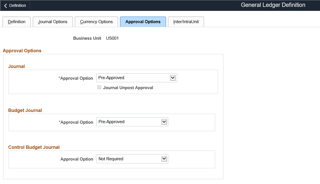

Use the General Ledger Definition - Approval Options page (BUS_UNIT_TBL_GL4) to specify journal entry approval options for a business unit.
Navigation:
This example illustrates the fields and controls on the Approval Options page. You can find definitions for the fields and controls later on this page.
You have the option to use either the Virtual Approver method or Approval Framework method for the journal approval process. You select the approval methodology for journal approval on the Installation Options - General Ledger Page. The selection choices on the Approval Options page depend upon which methodology that you select to use in Installation Options. When using the Virtual Approver method, the Business Process Name and Approval Rule Set fields appear on the page. When using the Approval Framework method, these fields are not visible since the Approval Framework provides its own Business Process and Approval Rule Set to communicate with PeopleTools.
Field or Control |
Description |
Journal |
Select an option for transaction journals. Values are:
Journal Unpost Approval |
Select check box for approving journal unposting. If Journal approval option is set to Pre-Approved for posting, then same is applicable for unposting. If approval is not required for posting then same is applicable for unposting also. If approval is required for posting then approval can be enabled for unposting by selecting this check box. |
Budget Journal |
Select a journal approval option for standard budget journals. Values are:
Control Budget Journal |
Select the Required approval option to enable Commitment Control budget journal approval (using Approval Framework) for the entire business unit. The default value is Not Required. See Approving Control Budget Journals Using Approval Framework. See also, PeopleSoft General Ledger Documentation Update: Commitment Control Budget Journal Approval. Visit My Oracle Support website - Article ID 1369486.1. |
