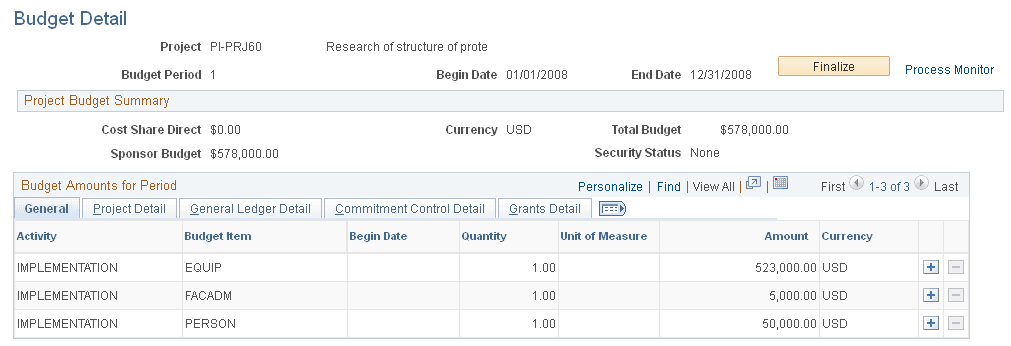

Use the Budget Detail page (PC_BUD_DETAIL2) to enter budget amounts that are associated with a particular budget plan.
Navigation:
This example illustrates the fields and controls on the Budget Detail page. You can find definitions for the fields and controls later on this page.
Note: The Award Generation process creates budget plans. PeopleSoft Grants users should not create budget plans using the PeopleSoft Project Costing menu structure. For Blue Birds awards, the system creates budget plans programmatically when users create budget periods on the Funding page in the Award Profile component.

General Tab
The system populates the General tab with budget details from the proposal, including amounts for the budget activities belonging to the project.
Project Detail Tab
Specify the values for the project-related fields for the PeopleSoft Grants budget rows that are displayed.
General Ledger Detail Tab
Specify the PeopleSoft General Ledger ChartField values for the PeopleSoft Grants budget rows that are displayed. When the system creates budget journals, it books the budget row amounts to the specified ChartFields.
Note: Budgetary ChartFields can be selected on the General Ledger Detail tab.
Commitment Control Detail Tab
Displays the ledger and ledger group that the system uses to book the budget journals.
If you need to specify the type of budget row that you are posting, use the Budget Line Code field to indicate whether the budget row is Original, Adjustment, Roll Forward, and so on. Original is the default value. If you have funding source control enabled in your commitment control setup, the system displays the appropriate value here.
Note: If any errors occur while posting to commitment control, the system stores the error rows on the Review Commitment Control page. You can find the commitment control posting error, fix the error, and resend the lines to commitment control.

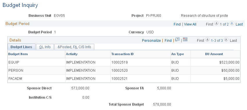

Use the Budget Inquiry page (GM_PRJ_BUD_INQ) to view budget information for specific projects.
Navigation:
This example illustrates the fields and controls on the Budget Inquiry page. You can find definitions for the fields and controls later on this page.
After you successfully post the budget journals, you can inquire on the budget. Select the GL Info and Posted, FA, and C/S Info tabs to view the budget journal IDs and the date that you posted the rows, as well as the budget header status, the ledger, and the ledger group to which you posted the journals.
