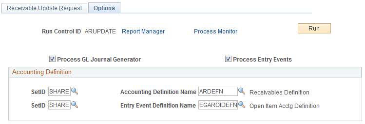

You can set up entry events to create transactions for items, payments, credit cards, drafts, direct debits and direct journals. You must set up the entry event codes with the predefined ARUPDATE and ARDIRJRNL processes and steps.
For all Receivables transactions except Direct Journals, the Entry Event process can be run as part of the AR posting job, Receivables Update (ARUPDATE). Navigate to . On the Receivables Update - Options page of the run control request, select the Process Entry Events check box to automatically run the Entry Event process after ARUPDATE runs. You can also use the Options page to automatically run Journal Generator to create GL journals. You must enter the accounting definition name for the standard entries (ARDEFN), and if you want to create GL journals for the supplemental (entry event) entries, enter EGAROIDEFN in the Entry Event Definition Name field.
This example illustrates the fields and controls on the Options page for running the Entry Event process as part of Receivables Update.
