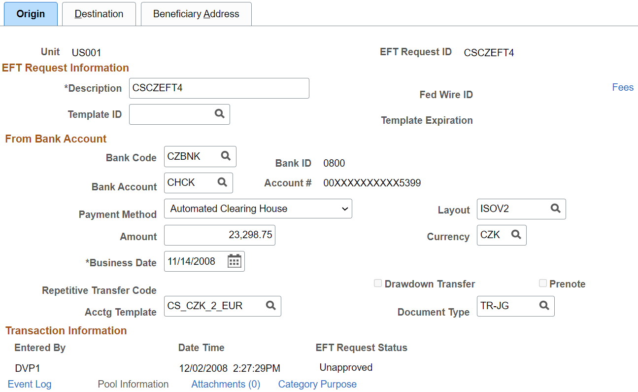

Use the EFT Request - Origin page (TR_WIRE_PNL) to enter transfer origin information.
Capture data on the account from which funds will be furnished for the transfer
Navigation:
This example illustrates the fields and controls on the EFT Request - Origin page. You can find definitions for the fields and controls later on this page.
Field or Control |
Description |
Description |
Enter a description. When you do not enter a description, the system populates the field with the description from the template assigned to the request. The system will not override a description that has been entered manually. |
Template ID |
Select the template, if you are executing the EFT requests from a template. Note: Expired templates are not available for selection. |
Prenotification |
This field is display-only and will appear selected for ACH prenotes. |
Fed Wire ID (federal wire ID) |
For EFT requests associated with federal fund transfers, the Federal Reserve agency assigns a Federal Wire ID code after receiving the request. Enter the code in this field for your reference. This field is automatically populated if the bank returns acknowledgements containing the Fed Wire ID. This field is used only as reference in Cash Management; it is not necessary for the accounting process. Note: The Federal Wire ID code is the only reference number that the Federal Reserve recognizes when handling issues or questions about the transfer. |
Fees |
Click to create fees for this EFT request. |
Payment Method |
Select an available payment method (methods are determined by the values that you defined in the Bank Code and Bank Accountfields). Values are Automated Clearing House, Direct Debit, Electronic Funds Transfer, or Wire Transfer. You cannot select a payment method for any type of repetitive transfer. |
Business Date |
Enter the business date on which the funds transfer is to occur. The date that you select carries over to the next business day, depending on:
Acct Template (accounting template) |
Select an accounting template if accounting is to be run for the transfer. Leave this field blank if the transfer is already accounted for in another PeopleSoft application (for example, Payables). Note: The Acct Template field is unavailable when the selected account in the Account # field is not enabled for cash clearing. |
IBAN |
Displays the international bank account number (IBAN) in addition to the local, domestic bank account number when the country has been set up to display the IBAN on the IBAN Formats Page. If you set up bank account encryption, IBAN is masked when you save the page. For more information about bank account number encryption and the National Automated Clearing House Association (NACHA) data security requirements, see Understanding Bank Account Encryption and Setting Up Bank Account Encryption. |
Transaction Information
Field or Control |
Description |
EFT Request Status |
Displays a value of Unapproved. This value changes as activity occurs later in the workflow—for example, when a supervisor approves the entered funds. |
Pool Information |
Click to access the Pool Information page. If this bank account is used for holding investment pool funds, enter the business unit and identifier of the pool. |
Category Purpose |
Click to access the Category Purpose page (CAT_PURP_EFT), where you can identify the high-level purpose of the payment instruction based on a set of predefined categories as per ISO 20022 external code list or a proprietary scheme name. Available only for SEPA transactions. |
Attachments |
Click to view/ add attachments. See Installation Options - Multiple Attachments Page to define the maximum attachment upload limit for various products. |
