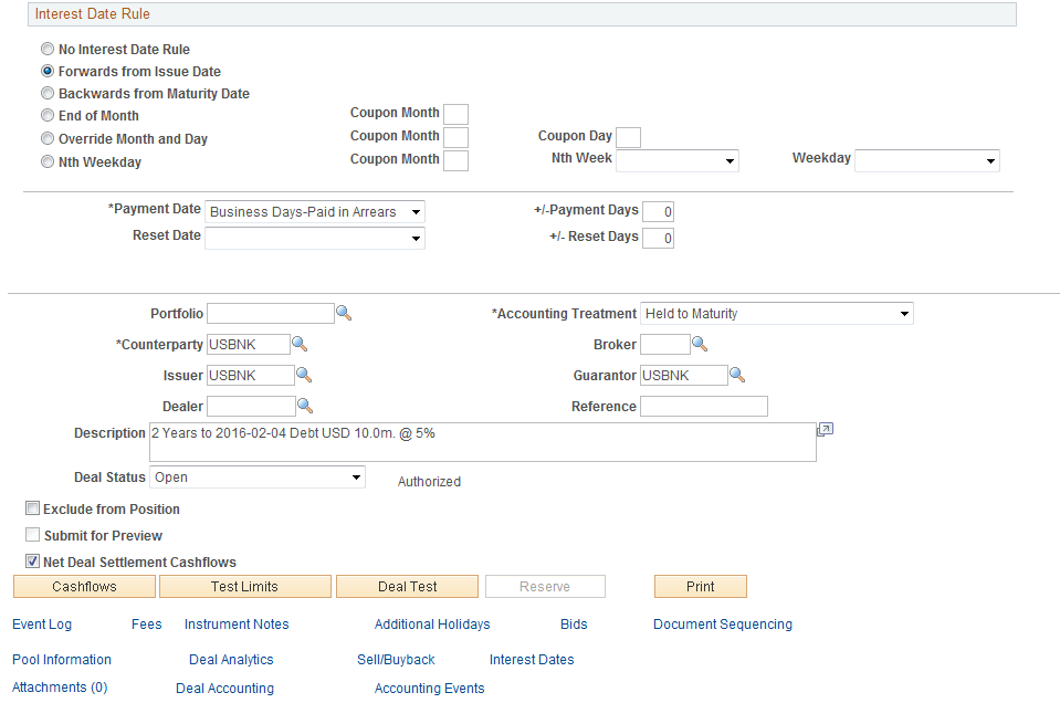

Interest Dates and Calculations |
Repeat Interest Dates |
Selected |
Interest Frequency |
Semi-Annual |
Reset Frequency |
Semi-Annual |
Reset Rate Index Tenor |
6 Month |
Business Day Convention |
Modified Following |
Next Interest Payment |
Traded Cum-Interest |
Interest Calculation |
Day Counted Interest Use Actual Interest Dates |
Interest Date Rule |
Backwards from Maturity Date |
Payment Date |
Business Days - Paid in Arrears |
+/- Payment Days |
0 |
Reset Date |
Set in Advance |
+/- Reset Days |
0 |
Accounting Treatment |
Held to Maturity |

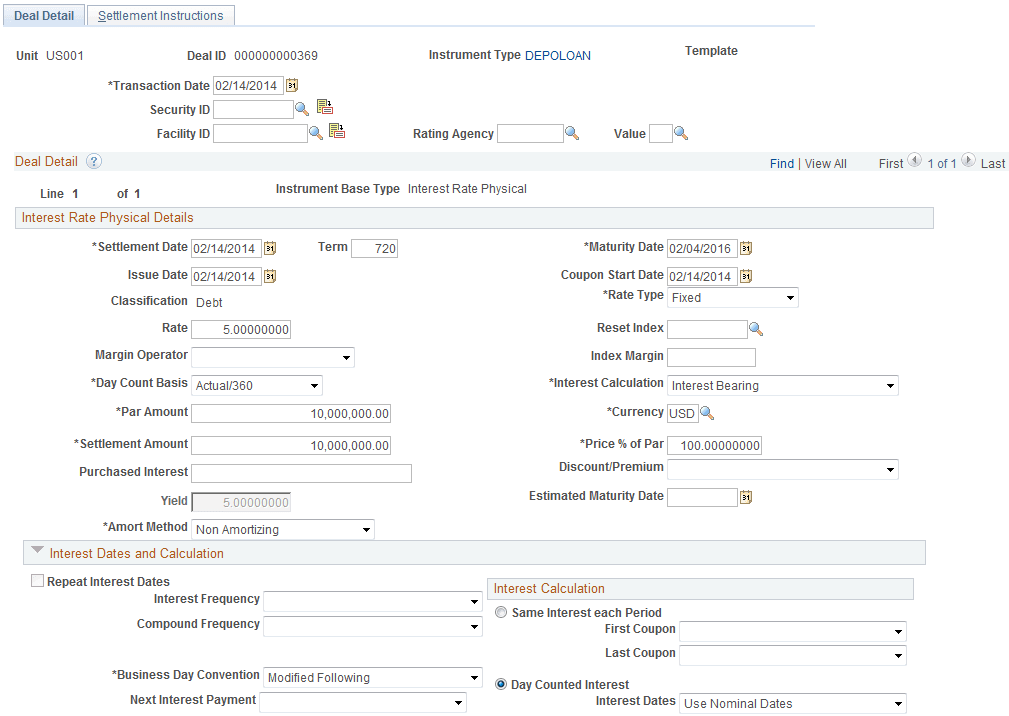

Deal Detail |
Unit |
US001 |
Deal ID |
358 |
Instrument Type |
BANKLOAN |
Transaction Date |
04/30/2003 |
Instrument Base Type |
Interest Rate Physical |
Interest Rate Physical Details |
Settlement Date |
05/02/2003 |
Term |
1096 |
Maturity Date |
05/02/2006 |
Issue Date |
05/02/2003 |
Interest Period Start Date |
05/02/2003 |
Classification |
Debt |
Rate Type |
Fixed |
Rate |
5.0 |
Day Count Basis |
Actual/360 |
Interest Bearing |
Par Amount |
450,000.00 |
Currency |
USD |
Settlement Amount |
450,000.00. |
Price % of Par |
100.0 (Automatically populated with the default value.) |
Discount/Premium |
Straightline Method |
Amortization Method |
Constant Payment |
End Principal |
0.00 |
Interest Dates and Calculation |
Selected |
Semi-Annual |
Same Interest each Period Normal First Coupon Period Normal Last Coupon Period |
Forwards from Issue Date |
Payment Date |
+/- Payment Days |
0 |
+/- Reset Days |
0 |
Held to Maturity |
Counterparty |
USBNK |
Issuer |
USBNK |
Guarantor |
USBNK |
Description |
3 Years to 2006–05–02 Debt USD 450K @5% |
Deal Status |
Open |

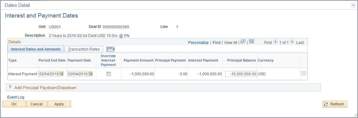

Interest and Payment Dates page |
Type Period End Date Payment Date Amount Principal Balance Interest Payment Principal Payment |
Interest 11/02/2003 11/03/2003 -81,697.49 -450,000.00 -11,250.00 -70,477.49 |
Interest 05/02/2004 05/03/2004 -81,697.49 -379,552.51 -9,488.81 -72,208.68 |
Interest 11/02/2004 11/03/2004 -81,697.49 -307,343.83 -7,683.60 -74,013.89 |
Interest 05/02/2005 05/02/2005 -81,697.49 -233,329.94 -5,833.25 -75,864.24 |
Interest 11/02/2005 11/03/2005 -81,697.49 -157,465.70 -3,936.64 -77,760.85 |
Interest 05/02/2006 05/02/2006 -81,697.47 -79,704.85 -1,992.62 -79,704.85 |

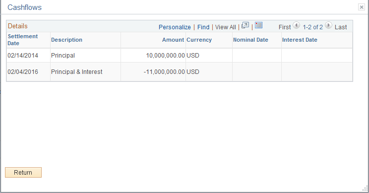

Cashflows |
Settlement Date Description Amount Currency |
05/02/2003 Principal 450,000.00 USD |
Settlement Date Description Amount Currency Nominal Date Interest Date |
11/03/2003 Interest -81,697.49 USD 11/02/2003 11/03/2003 |
05/03/2004 Interest -81,697.49 USD 05/02/2004 05/03/2004 |
11/02/2004 Interest -81,697.49 USD 11/02/2004 11/02/2004 |
05/02/2005 Interest -81,697.49 USD 05/02/2005 05/02/2005 |
11/02/2005 Interest -81,697.49 USD 11/02/2005 11/02/2005 |
05/02/2006 Principal & Interest -81,697.47 USD |

Cashflows page |
08/08/2000 Principal 452,000,000.00 USD |
08/08/2000 Principal -2,000,000.00 USD |
08/09/2000 Principal & Interest -452,067,486.11 USD |
08/09/2000 Principal 2,000,000.00 USD |

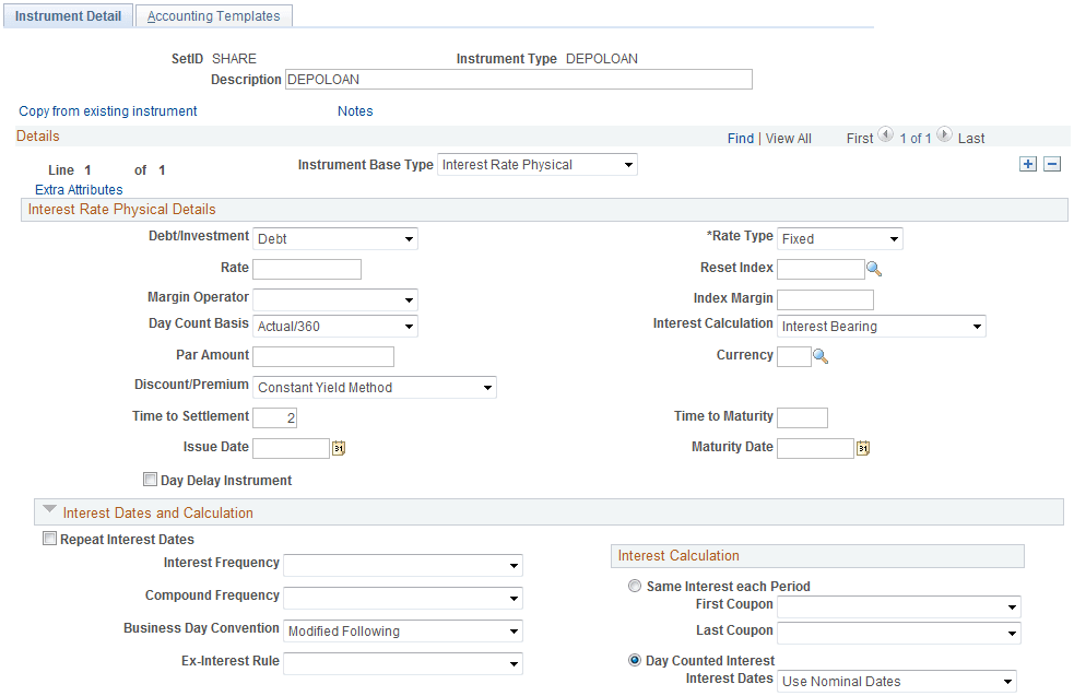

See Selecting Accounting Templates.
This example illustrates the fields and controls on the Instrument Detail page – for an interest rate physical instrument (1 of 2). You can find definitions for the fields and controls later on this page.
This example illustrates the fields and controls on the Instrument Detail page – for an interest rate physical instrument (2 of 2). You can find definitions for the fields and controls later on this page.
Note that the Repeat Interest Dates check box is deselected, and the Interest Frequency, Ex-Interest Rule, and Interest Date Rule fields are left blank.
Important! This setting is what enables the system to calculate and pay accrued interest at maturity (for deals created from this instrument).
Once you have defined and saved the IRP/1+YR/Interest at Maturity instrument, you can create IRP/1+YR/Interest at Maturity deals. The following two screenshots illustrate defining a IRP/1+YR/Interest at Maturity deal.
On the Deal Detail page, the option you select for Day Count Basis affects the total accrued interest. In this example, specifying Actual/360 for the Day Count Basis returns a total accrued interest amount of 1 million USD. However, if 30/360 is specified, the total accrued interest amount is slightly lower due to the decreased number of days for interest calculation.
As the Deal Detail page for the IRP/1+YR/Interest at Maturity deal derives information from the Instrument Detail page for the IRP/1+YR/Interest at Maturity instrument, the check box and fields left blank on the instrument are unavailable for entry on the deal.
This example illustrates the fields and controls on the Deal Detail page – entering deal detail information (1 of 2).
This example illustrates the fields and controls on the Deal Detail page – entering deal detail information (2 of 2).
When you complete entering information and save the deal, the Cashflows page and the Interest and Payment Dates page are populated as shown in the following two page views.
This example illustrates the fields and controls on the Cashflows page – with interest added to principal at maturity. You can find definitions for the fields and controls later on this page.
This example illustrates the fields and controls on the Interest and Payment Dates page - with interest added to principal at maturity.

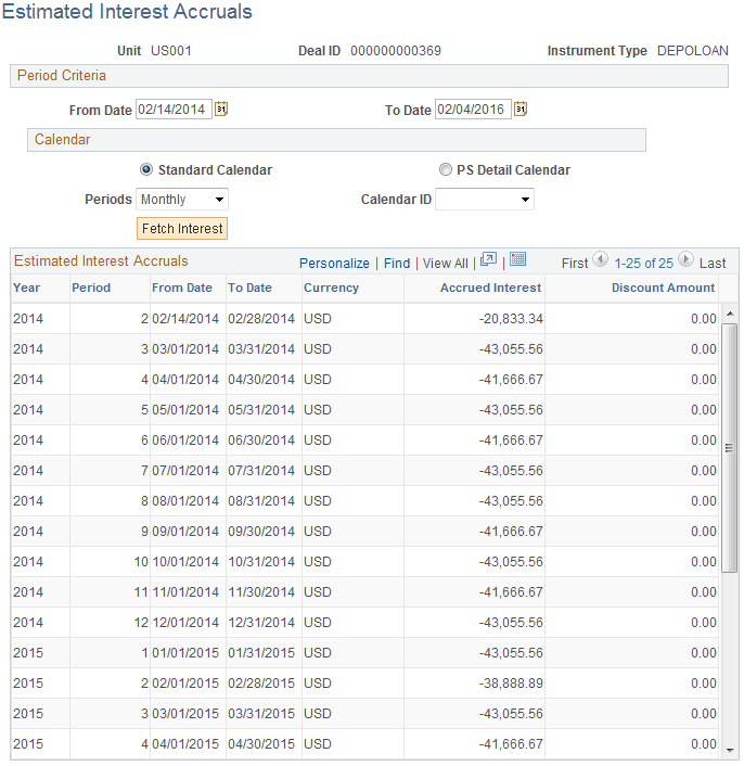

You can view periodic accrual amounts using the Estimated Interest Accruals page (TRX_ACCR_INT_PNL). The monthly interest accrual for this IRP/1+YR/Interest at Maturity deal example is shown in the following application page.
This example illustrates the fields and controls on the Estimated Interest Accruals page.
