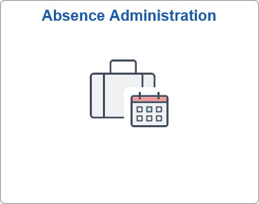

Administrators use the Absence Administration tile to access the Absence Administration dashboard for a collection of tiles to frequently-used Absence Management administrative components.
Navigation:
The Absence Administration tile is delivered as part of the Workforce Administrator homepage, but the location can change if you change the delivered home pages or if administrators personalize their home pages.
This example illustrates the Absence Administration tile.
Absence Administration Tile
Click the Absence Administration tile to access the tile collection landing page for Administrative tasks and Event Insights tiles.

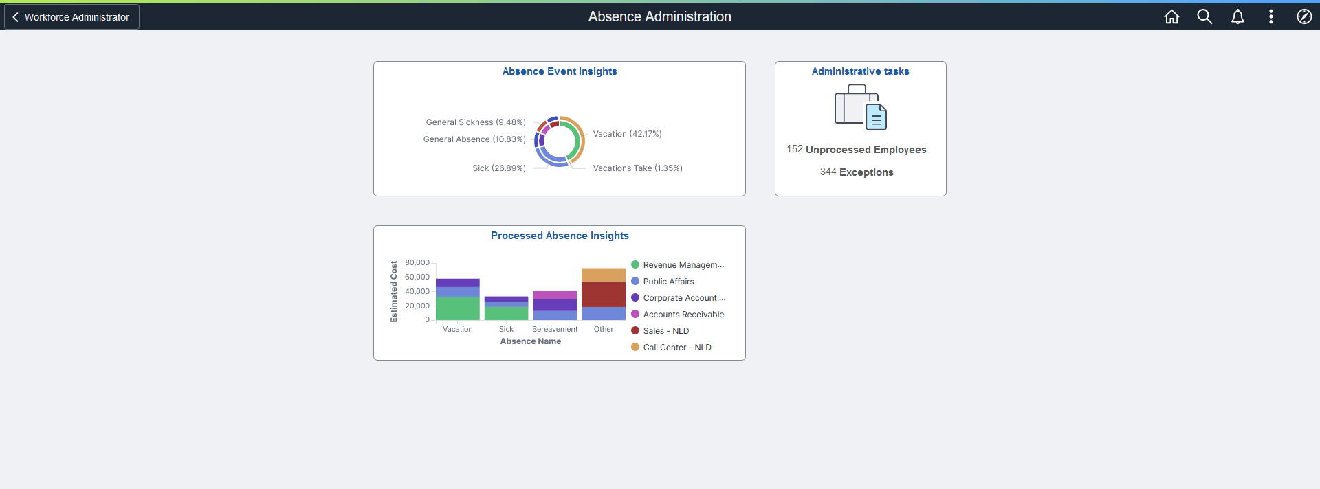

Administrators use the Absence Administration dashboard to access tiles for managing Administrative tasks, Processing Absences Insights, and Absence Event Insights.
Navigation:
Select the Absence Administration Tile.
This example illustrates the Absences Administration dashboard.
Absence Administration Home Page

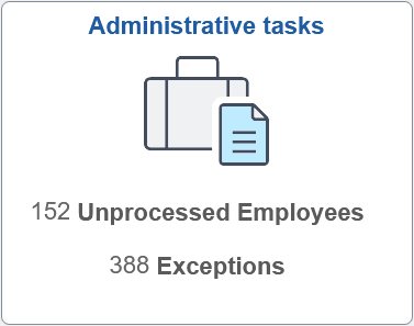

Use the Administrative tasks tile to access a collection of frequently-used Absence Management administrative components.
Navigation:
The Administrative tasks tile is part of the Absence Administration Dashboard landing page.
This example illustrates the fields and controls on the Administrative tasks tile.
Administrative tasks Tile
Select Administrative tasks tile to access Absence Administration application start page.
Field or Control
Description
Unprocessed Employees
Displays the number of employees for whom approved absence has not been processed.
Exceptions
Displays sum of the errors and warnings from absence and TL exceptions.
Note: Unprocessed Employee Count/Exceptions Count is displayed only if the Generate Absence Payable Time check box is selected on the Configurations Page.
Click the tile to access the Absence Administration application start page.

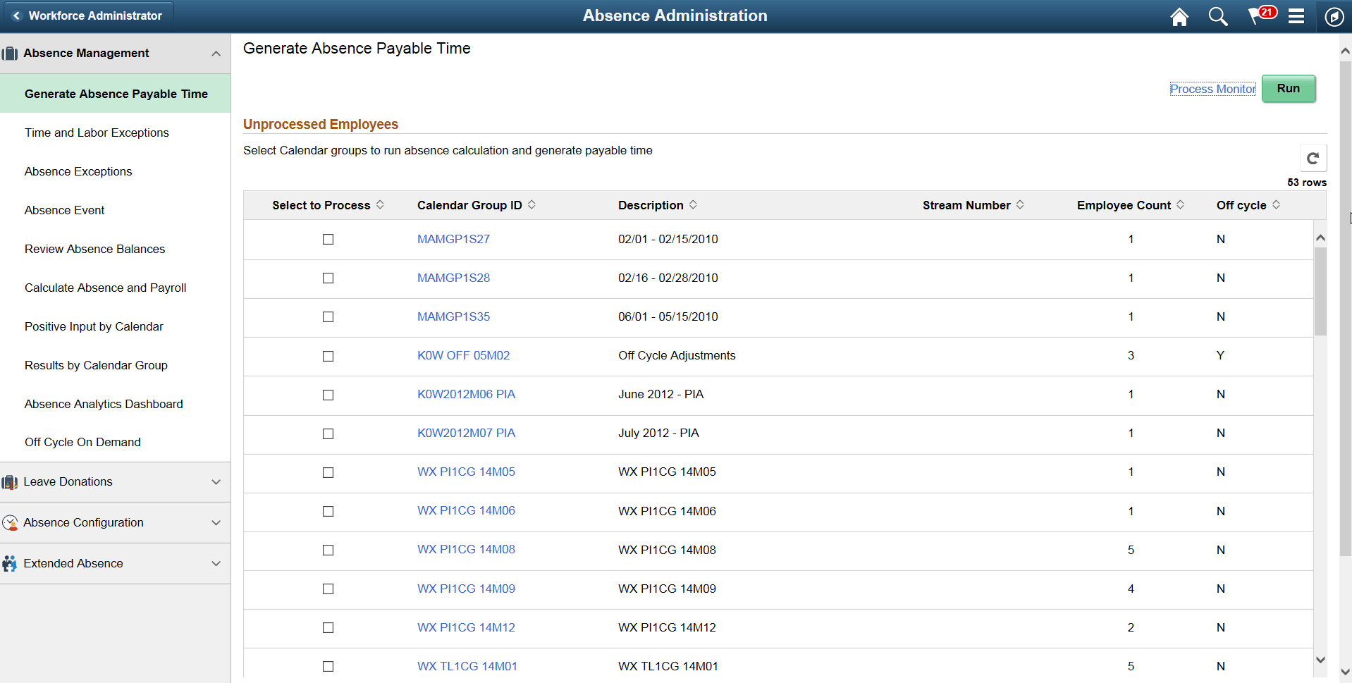

This example illustrates the Absence Administration Start page.
This application start page is a navigation collection that enables administrators to access frequently-used Absence Management components from one location. The left panel of this page lists the components collected under four categories:
  • Absence Management
  • Leave Donations
  • Absence Configuration
  • Extended Absence
The right panel displays the component selected in the left panel.

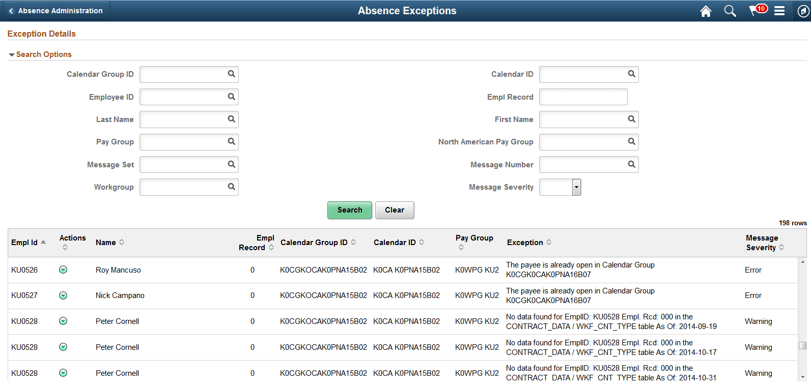

Use the Absence Exceptions page (HGA_PAYEE_MSG_FL) to view the details of the errors and warnings for absence calculations.
Navigation:
Click the Absence Administration tile on the Workforce Administrator fluid home page and select Absence Exceptions from the Absence Management navigation collection.
Click the Absence Calculations Tile from Exceptions section on the Generate Absence Payable Time page.
This example illustrates the Absence Exceptions Page.
Field or Control
Description
Search Options
Use the search option to filter the exception details using Calendar Group Id, Calendar Id, Employee Id, Employee Record, Name, Pay Group, Message Set, Message Number, Workgroup and Severity.
Actions
Use the related actions to access the following pages:
  • View Results by Calendar Group
  • View Messages
  • View Status
  • Review Triggers
  • Create and Maintain Absence
  • Approve Absence
  • Administer Extended Absence
  • Calculate Absence and Payroll
  • Review Absence Balances

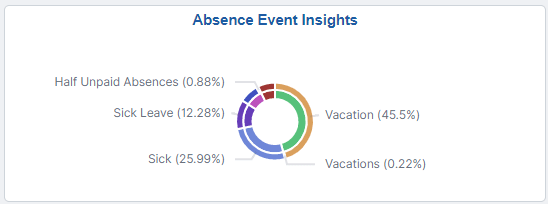

The administrator can use the Absence Event Insights tile to access Absence Event Insights Dashboard and analyze the employee absences event data.
This example illustrates the fields and controls on the Absence Event Insights tile.
Absence Event Insights Tile
Based on user privileges, administrators can access the visualizations delivered on the Absence Event Insights dashboard.
The absence event data is the data submitted by employee, manager or administrator.
The Absence Event Insights Analytics dashboard is built on the PeopleSoft Insights platform, which relies on an underlying analytics engine and search engine. Absence Event data that is visible on the dashboard comes from the HC_GP_ABS_RQST search index.

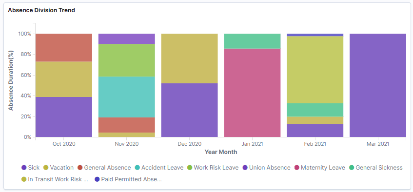

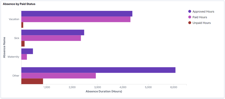

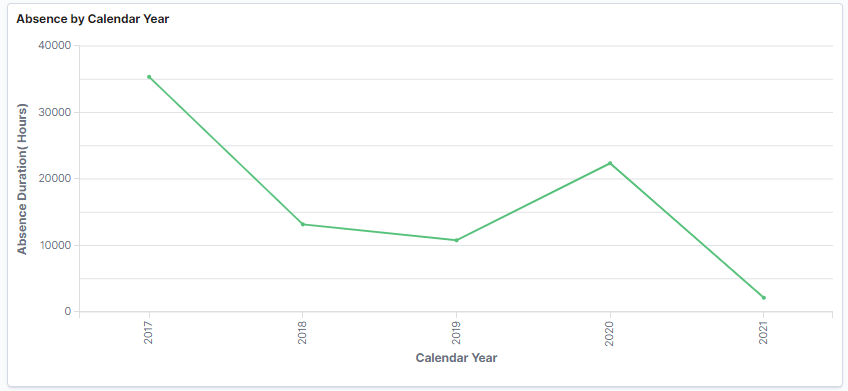

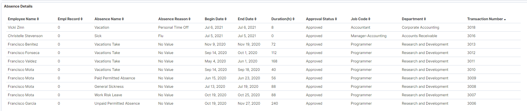

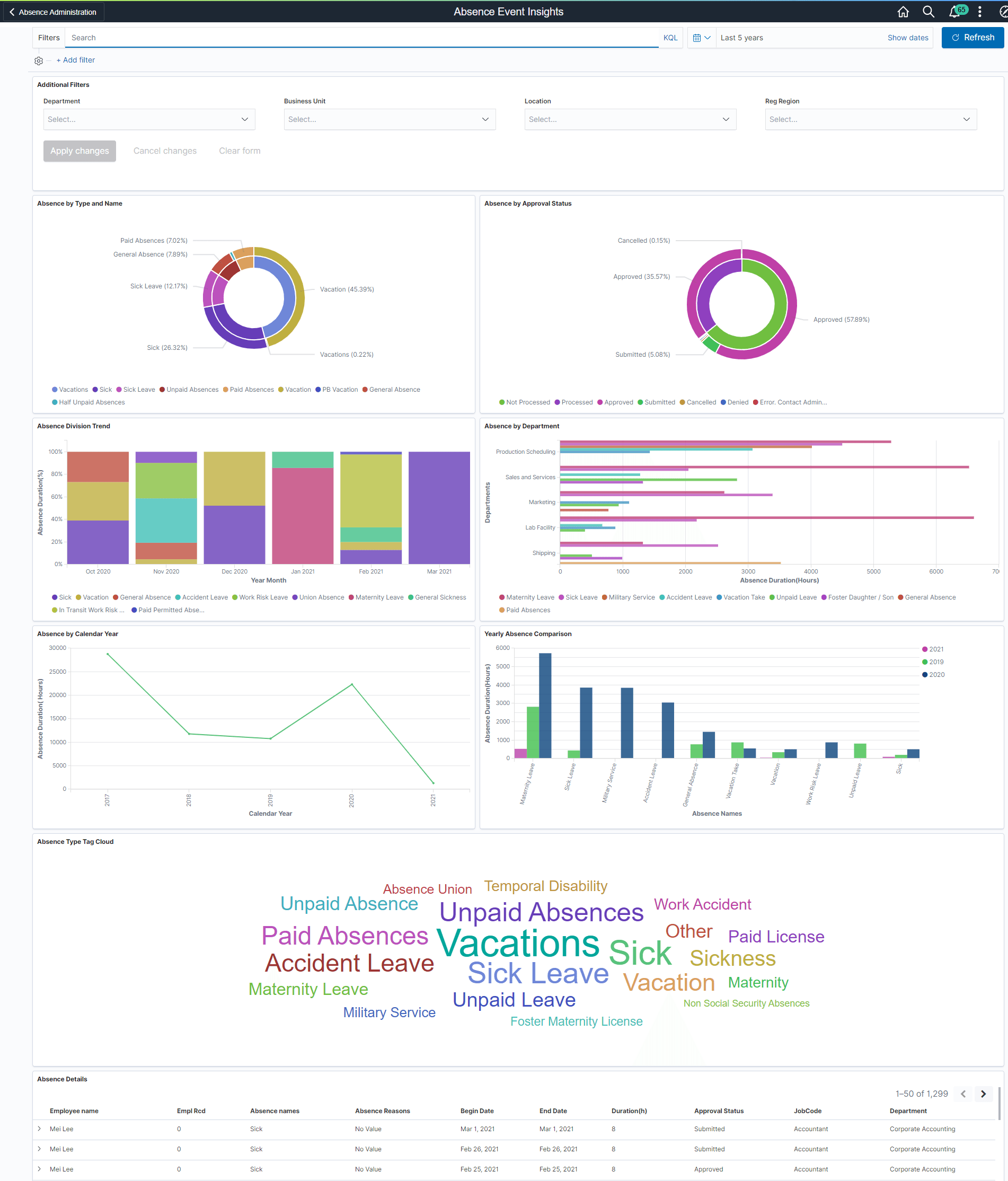

PeopleSoft Absence Analytics Event Insights dashboard provides administrators the ability to view and analyze absence event data using Insights visualizations.
Navigation:
Workforce Administrator home page > Absence Administration tile > Absence Event Insights tile
This video provides an overview of the Absence Management Insights feature:
Video: Image Highlights, PeopleSoft HCM Update Image 38: Absence Event Insights Dashboard
This example illustrates the fields and controls on the Absence Event Insights dashboard. You can find definitions for the fields and controls later on this page.
The different visualizations can be used by the administrator to:
  • Work with managers and first level administrators to manage absenteeism in their realm of work.
  • Take corrective actions before processing absences.

Enter criteria to filter data on the visualizations. You can add filters in a number of ways:
  • Enter them manually in the Filters search field.
  • Use the + Add filter link to create filters using fields, operators and field values.
  • Select a chart item from a visualization.
  • Use the filter options in the Absence Details grid to add or exclude items.
  • Use the legend to add or exclude items.
Calendar iconCalendar icon (Calendar) or Show dates
Click to select a different time period for the analytics. You can enter it manually, or choose from commonly used date ranges provided by the system or from the recently used selections. When a new period is selected, all visualizations are refreshed automatically to reflect that change. If you have selected a commonly used date range, for example, This month, or Week to date, click the Show dates link to view the approximate date period in relation to the current date. For example, the current date is November 1 and the selected date range is Year to date. Clicking the Show dates link displays ~ 10 months ago —> now, which indicates that the selected date range started from approximately 10 months ago and ends on the current date.

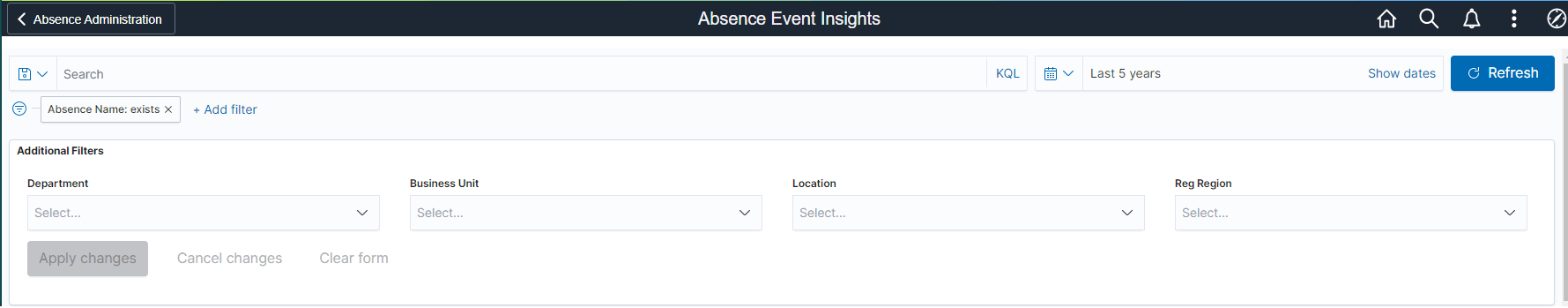

Additional Filters
This example illustrates the fields and controls on the Additional Filters. You can find definitions for the fields and controls later on this page.
Filters Information
Note: By default, the data populates for the past five years.
Additional Filters allow you to select the following filters:
  • Department
  • Business Unit
  • Location
  • Regulatory Region

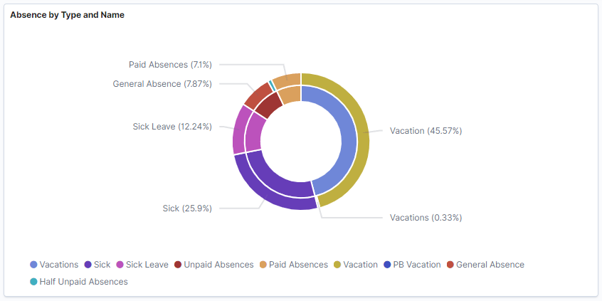

Absence by Type and Name Visualization
Use this visualization to view the absences by type and name for the selected period in an organization.
This example illustrates the fields and controls on the Absence by Type and Name.
The double doughnut visualization represents count of different absence within each absence type used by the organization. The inner doughnut is the absence type and outer doughnut represents the absences names within each type.

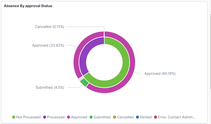

Absence by Approval Status Visualization
Use this visualization to view the absences by approval status for the selected period in an organization.
This example illustrates the fields and controls on the Absence by Approval Status.
This visualization represents the absences on the basis of approval status. Here, the inner doughnut is the absence processed and unprocessed status and the outer one is the absence approval status within each of it.

Absence Division Trend
The bar chart shows the percentile information of each absences and represents the monthly trend of absence submissions. The default setting is for the last six month of data.
Note: If the Administrators have access rights to update the design of visualization, they can do it in the Insights Designer mode.

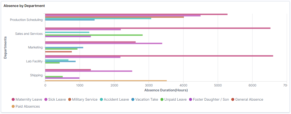

Absence by Department Visualization
Use this visualization to view the absence trends by department for the selected period.
This example illustrates the fields and controls on the Absence by Department.
This visualization represents absence duration by departments and shows how the absences are submitted across departments in terms of absence duration. The default visualization is set for five departments.

This example illustrates the fields and controls on the Absence by Calendar year.
Absence by Calendar Year
Line diagram which represents the totals or cumulative of absence duration in hours. You can check the absenteeism by year on year. The default visualization is set for five years.

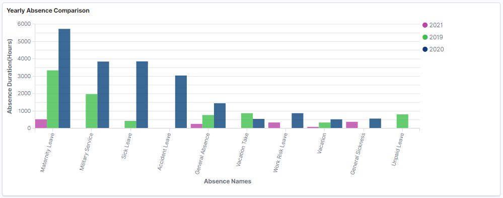

Yearly Absence Comparison Visualization
Use this visualization to view the absence duration trends in hours by its names for the selected period.
This example illustrates the fields and controls on the Yearly Absence Comparison.
The bar chart with different color shows the year-on-year trend by absence name. This is on the basis of the timeline selected. The default is set to three years of calendar year series.

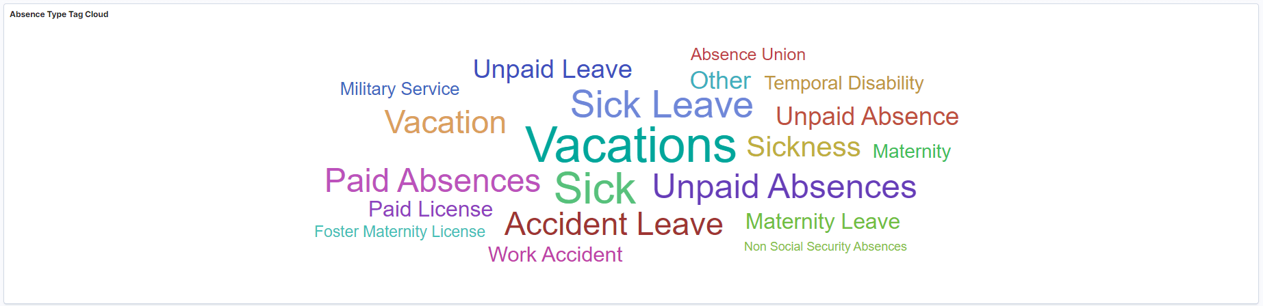

Absence Type Tag Cloud
The Administrator can view the information regarding a particular Absence and on selecting the absence name, it gives more information in different analytics.
This example illustrates the fields and controls on the Absence Type Tag Cloud.
The absence types labels size appear in the descending order of most applied, with the size of the absence type label with most applied absences displayed as the biggest. In this case, it is Vacation. The Administrator can use this information as the immediate filter, much more than the filter applied. On selecting one particular absence type refreshes the entire dashboard.
Absence Details
This example illustrates the fields and controls on the Absence Details.
Absence Details
Absence details is the customizable list of information presented based on user needs.

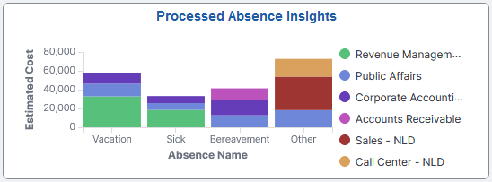

The administrator can use the Processed Absence Insights tile to access Processed Absence Insights Dashboard and analyze the employee processed absences data.
This example illustrates the fields and controls on the Processed Absence Insights tile.
Processed Absence Insights Tile
Based on user privileges, administrators can access the visualizations delivered on the Processed Absence Insights dashboard.
The processed absence data is the data submitted by employee, manager or administrator.

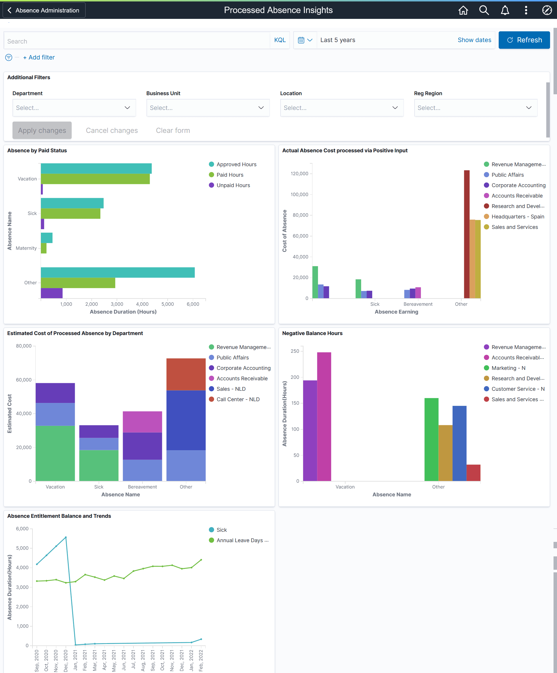

Processed Absence Insights dashboard provides administrators the ability to view and analyze processed absence data using Insights visualizations.
Navigation:
Workforce Administrator home page > Absence Administration tile > Processed Absence Insights tile
This example illustrates the fields and controls on the Processed Absence Insights dashboard. You can find definitions for the fields and controls later on this page
The different visualizations can be used by Administrator to:
  • View the processed absence data for the employee.
  • Work with HR, Finance and first level administrators to understand/ manage absence cost, productivity and liabilities.

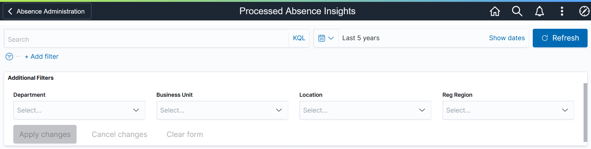

Additional Filters
Additional Filters
  • Department
  • Business Unit
  • Location
  • Regulatory Region

This example illustrates the fields and controls on the Absence by Paid Status Visualization.
This visualization represents the total hours of approved absences and how many of those hours were paid versus unpaid. Each absence type used by the organization will be represented.

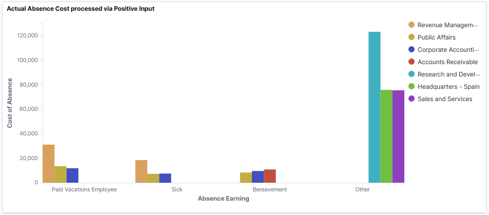

Actual Absence Cost processed via Positive Input
Use this visualization to view the cost of generated positive input by department for different absence types.
This example illustrates the fields and controls on the Actual Absence Cost processed via Positive Input Visualization.
The bar chart shows the cost of positive inputs for each absence types in each departments.

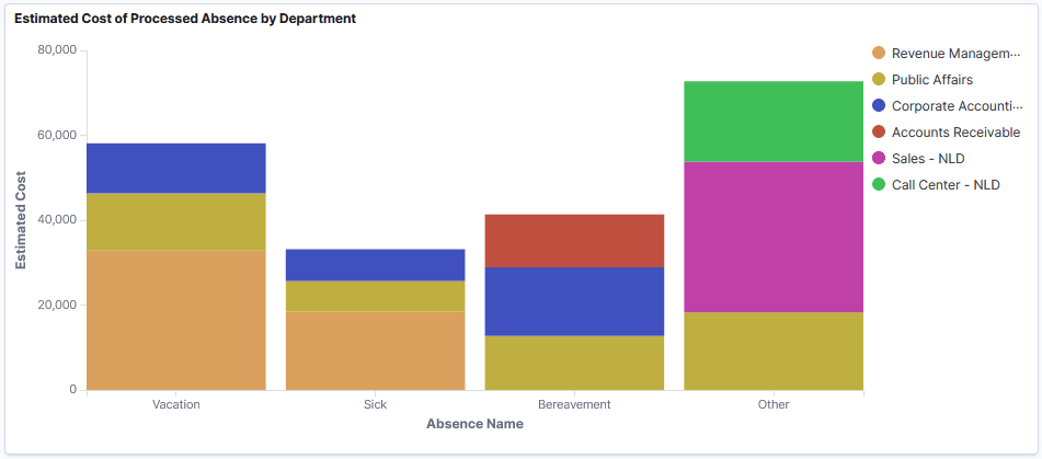

Estimated Cost of Processed Absence by Department
Use this visualization to view the cost of processed absences by department for the selected period in an organization.
This example illustrates the fields and controls on the Estimated Cost of Processed Absence by Department.
Estimated Cost of Processed Absence by Department Visualization
The bar chart represents the cost of different absences by departments.

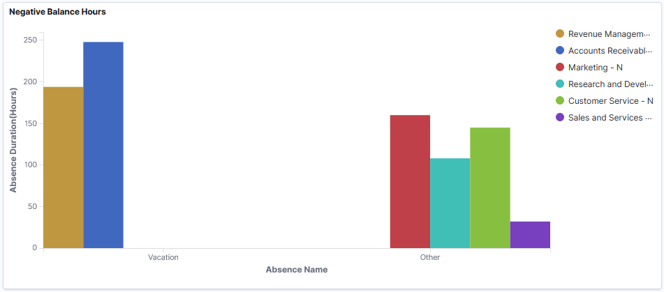

Negative Balance Hours Visualization
Use this visualization to view the number of negative absence balance hours for each absence type for the selected period.
This example illustrates the fields and controls on the Negative Balance Hours Visualization.
This visualization represents negative absence balances in hours for each absence type by department. The default visualization is set for six departments.

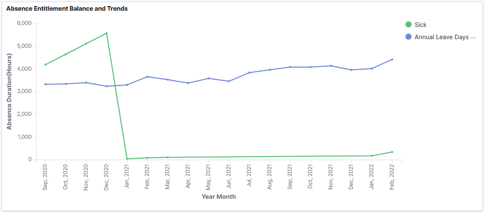

Absence Entitlement Balance and Trends Visualization
Use this visualization to view the trend of absence balances by absence type and month.
This example illustrates the fields and controls on the Absence Entitlement Balance and Trends Visualization.
Line diagram which represents the entitlement balances by month.
