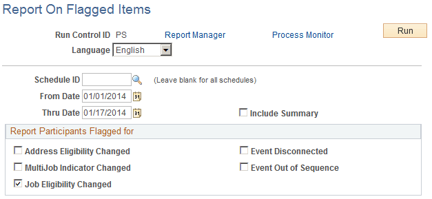

Use the Report on Flagged Events page (RUNCTL_BAS008) to lists events that have had job, address, or union eligibility information changed, events that have been processed out of sequence, and events that have been disconnected during processing.
Navigation:
This example illustrates the fields and controls on the Report on Flagged Events page. You can find definitions for the fields and controls later on this page.
Field or Control |
Description |
Schedule ID |
To print flagged events from all schedules, leave this field blank. |
Include Summary |
Select to include summary information on all flagged participant events. |
Reports Participants Flagged for |
Select all of the criteria in this group box to use when reporting on selected participants. |
