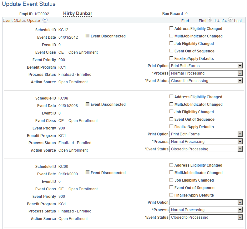

Use the Update Enrollment Event Status (benefits administration event status update) page (BAS_PARTIC_STS) to reprocess individual participant events.
Navigation:
This example illustrates the fields and controls on the Update Enrollment Event Status page. You can find definitions for the fields and controls later on this page.
You see all events currently in BAS_PARTIC for the participant and benefit record number combination that you select in descending date order, so the current events are at the top. The event currently in process has an event status of Open.
Note: Only one event can have an event status of Open. You cannot change another event to Open status until the current event is closed.
Field or Control |
Description |
Event Disconnected (disconnected event) |
If selected, this option indicates that the event is disconnected and can no longer be processed, with the exception of finalized and disconnected events, which can be reprocessed to a Void status. |
Address Eligibility Change, MulitJob Indicator Changed (multiple job indicator change), Job Eligibility Changed, and Event Out of Sequence |
These check boxes indicate that changes have occurred since the event was scheduled; the event may have been affected and may need to be reprocessed. If you determine that the event does not need reprocessing, deselect these check boxes. Note: These check boxes remain selected until you deselect them. After you reprocess the event or otherwise correct the problem that caused the system to select the check box, you should return to this page to deselect the check boxes. |
Finalize/Apply Defaults |
When this option is selected, the system attempts to finalize and apply defaults for the participant event on the next run of the Benefits Administration process. |
