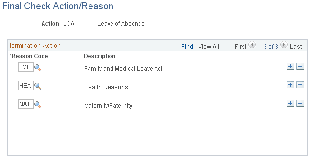

TERM_ACTN_RSN |
Define the action and action reason code combinations that automatically trigger a final check request when an employee termination Job record enters the system. |

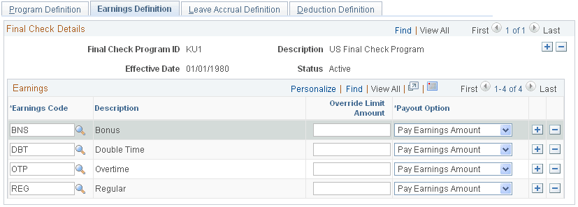

Final Check Program Table - Earnings Definition Page Final Check Program Table - Earnings Def Page |
TERM_PGM_DEFERN |
Define earnings for the final check program. |

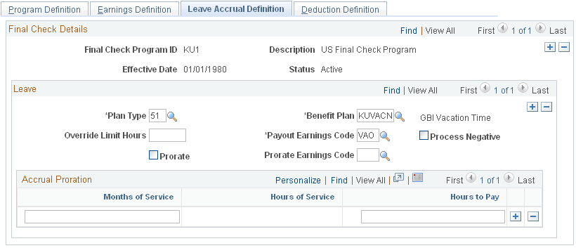

Final Check Program Table - Leave Accrual Definition Page Final Check Program Table - Leave Accrual Def Page |
TERM_PGM_DEFLVE |
Define rules that apply to paying leave accruals to employees for whom you decide to pay earned or prorated accruals. |

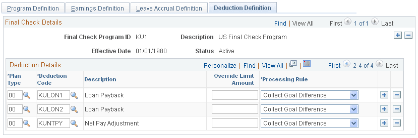

Final Check Program Table - Deduction Definition Page Final Check Program Table - Deduction Def Page |
TERM_PGM_DEFDED |
Define which deductions to include in a final check and which limits and special rules to use when calculating the deduction. |

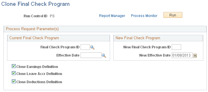

RUNCTL_FCXCLONE |
Run the Final Check Pgm Clone Utility (final check program clone utility) SQR Report process (FCXCLONE). |

Use the Final Check Action/Reason page (TERM_ACTN_RSN) to define the action and action reason code combinations that automatically trigger a final check request when an employee termination Job record enters the system.
Navigation:
This example illustrates the fields and controls on the Final Check Action/Reason page.
Field or Control |
Description |
Reason Code |
Select an action reason to associate with the action code. Maintain action codes and reasons on the Action Reason Table page. |

Use the Final Check Program Table - Earnings Definition page (TERM_PGM_DEFERN) to define earnings for the final check program.
Navigation:
This example illustrates the fields and controls on the Final Check Program Table - Earnings Definition page.
Field or Control |
Description |
Payout Option |
Select: Pay Earning Amount: Select this value if the Final Check process uses the regular earnings amount to pay the earnings for the earnings code. Pay Goal Difference: Select this value if the Final Check process searches for a corresponding Additional Pay record for the earnings code and calculates the remaining balance on the employee's goal amount. |
Note: The final check includes only earnings that you identify here. For example, to include additional pay earnings for a car, you must include the appropriate earnings code for those earnings on this page. Otherwise it is not included in employees' final checks.
Use the Final Check Program Table - Leave Accrual Definition page (TERM_PGM_DEFLVE) to define rules that apply to paying leave accruals to employees for whom you decide to pay earned or prorated accruals.

This example illustrates the fields and controls on the Final Check Program Table - Leave Accrual Definition page.
Leave
Field or Control |
Description |
Override Limit Hours |
To apply an override when the payout earned and prorated hours exceed the limit, enter the number of hours. |
Payout Earnings Code |
Select a payout earnings code to use for paying the accruals that are earned and awarded for the benefit plan. You can pay only the earned and awarded accruals, only the prorated portion, or both. Define the earnings code that you use for paying the earned and awarded accruals in the Earnings table as earnings that do not reduce regular pay but do add to hours taken. This ensures the integrity of the Accrual Balance records when you pay employee leave accruals upon termination. |
Process Negative |
Select this check box to pay negative accruals. |
Prorate Earnings Code |
Select a prorated earnings code to use for paying the prorated portion of accruals for the benefit plan. You can pay either:
Define the earnings code that you use for paying prorated accruals as earnings that do not reduce regular pay, but do add to hours taken and hours adjusted. This ensures the integrity of the Accrual Balance records when you pay employee leave accruals upon termination. Note: Leave may be accrued each payroll by the hour, but the system does not prorate hour-to-hour leave accrual in the final check process. Even if you set up final check leave accrual to prorate leave on an hour-to-hour basis, the Final Check process does not calculate it. |
Accrual Proration
If you prorate accruals for the benefit plan, use this group box to establish the proration rules.
Field or Control |
Description |
Months of Service |
To prorate accruals by months of service, enter the monthly increments. For example, less than or equal to 1 month of service, 2 months of service, and so on. The system computes the months of service based on the employee's termination date and the last date on which you ran the Run Leave Accruals COBOL SQL process (FGPACCRL). |
Hours of Service |
To prorate accruals by hours of service, enter the hourly increments. For example, less than or equal to 160 hours of service, 320 hours of service, and so on. |
Use the Final Check Program Table - Deduction Definition page (TERM_PGM_DEFDED) to define which deductions to include in a final check and which limits and special rules to use when calculating the deduction.
Navigation:
This example illustrates the fields and controls on the Final Check Program Table - Deduction Definition page.
Field or Control |
Description |
Deduction Code |
Select the deduction code that identifies the deduction in the Deduction table. Note: U.S. Savings Bond deductions are not valid deductions. Do not use deduction code KUUSBD (U.S. Savings Bond Deduction). |
Processing Rule |
Select a processing rule for each deduction code: Collect Goal Difference: Select this value to collect general deductions only. You collect the amount of the general deduction data goal amount minus the goal balance. Collect Pay Period Deduction: Select this value to collect general deductions and benefit deductions. You collect the amount of the scheduled pay period deduction. Refund Bond Bal-Ready to Dist (refund savings bond balance ready to distribute): U.S. Savings Bond deductions are not valid. Do not use this value. Refund ESPP Balance (refund employee stock purchase plan balance): This value is reserved for future use. Do not use this value. Refund Goal Balance (refund goal balance): Select this option to refund general deductions only. You refund the amount of the general deduction data goal balance. Refund Last Deduction (refund last deduction): Select this value to refund general deductions and benefit deductions. You refund the amount of the pay deduction data current deduction, which represents the amount deducted at the last time the deduction was taken. Refund Month-to-Date Balance: Select this value to refund general deductions and benefit deductions. You refund the amount of the deduction balance data MTD deduction. Refund Quarter-to-Date Balance (refund quarter-to-date balance): Select this value to refund general deductions and benefit deductions. You refund the amount of the deduction balance data QTD deduction. Refund Sav Bond Balance (refund savings bond balance): U.S. Savings Bond deductions are not valid. Do not use this value. Refund Year-to-Date Balance: Select this value to refund general deductions and benefit deductions. You refund the amount of the deduction balance data YTD deduction. |
Important! The Final Check process performs normal payroll arrears processing whether or not you include the deduction in the final check program.
Use the Final Check Program Clone page (RUNCTL_FCXCLONE) to run the Final Check Pgm Clone Utility (final check program clone utility) SQR Report process (FCXCLONE).
Navigation:
This example illustrates the fields and controls on the Clone Final Check Program page.
Identify the final check program that you're cloning, specify a final check program ID and the effective date for the new program, and indicate which program elements to copy to the new final check program.
