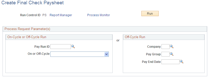

Use the Create Final Check Paysheet page (RUNCTL_TERM) to run the Final Check Build process to create final check paysheets.
Navigation:
This example illustrates the fields and controls on the Create Final Check Paysheet page.
On-Cycle or Off-Cycle Run
If you use this group box, the Off-Cycle Run group box becomes unavailable for entry.
Field or Control |
Description |
Pay Run ID |
Select a pay run ID to create final check paysheets for the pay calendars that are associated with the ID. |
Off-Cycle Run
If you use this group box, the On-Cycle or Off-Cycle Run group box becomes unavailable for entry.
Note: The Final Check Build process gathers information from system tables about the employees for whom you processed final check requests and generates the pay earnings information for each payline.
Note: After creating final check paysheets, run the normal Pay Calculation and Pay Confirmation processes.
