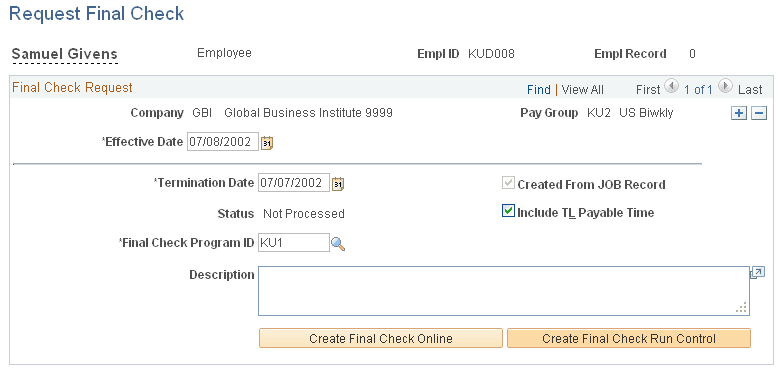

Use the Request Final Check page (TERM_RQST) to run the online or batch final check request process.

This example illustrates the fields and controls on the Request Final Check page.
Note: When you add a final check request for an employee whose status on the Job Data table is not Terminated, Final Check Workflow automatically creates a worklist item for the Personnel Administrator role user.
Field or Control |
Description |
Termination Date |
Enter the date of the last day for which the employee is to be paid. |
Status |
The system displays status of Updated to Paysheets or Not Processed, depending on whether you've processed the request. |
Final Check Program ID |
Select the final check program ID that identifies the final check rules appropriate to the employee's check. |
Reprocess |
Select this option to reprocess. |
Created From JOB Record |
The system automatically creates a final check request when you change an employee's job status to Terminated. The system selects this check box if the final check request you've accessed was created this way. |
Include TL Payable Time (include time and labor payable time) |
Select this option if you are using data from PeopleSoft Time and Labor. |
Create Final Check Online |
To access the Online Check process for the final check request, select this button. |
Create Final Check Run Control |
To access the batch payroll process for final check requests, select this button. |

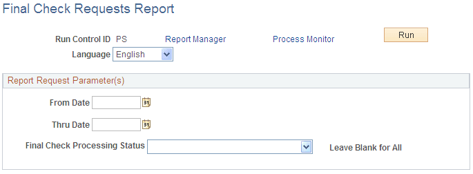

Use the Final Check Requests Report page (RUNCTL_PAY056) to generate the PAY056 report that lists final check requests for which an employee's final check processing status is either N (not processed) or P (loaded to paysheets).

This example illustrates the fields and controls on the Final Check Requests Report page.
Field or Control |
Description |
Final Check Processing Status |
Extracted: All employees whose final check request processing status is Not Processed or Loaded to Paysheets. Loaded to Paysheets: All employees whose final check processing status is Loaded to Paysheets. Not Processed: All employees whose final check processing status is Not Processed. Paysheet Created: All employees whose final check processing status has paysheets created. Note: Leave the field blank to report all statuses. |
