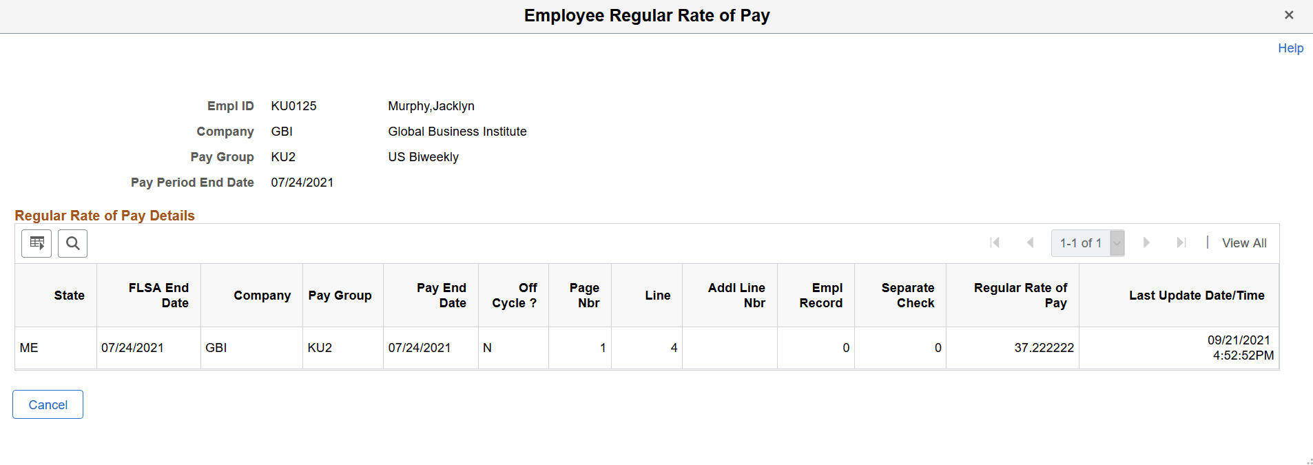

Example 1: Standard Calculation for Maine Employee Working 40 Hours a Week
In this example, the employee in Maine worked for 40 hours in the specified 7-day FLSA period. The selected calculation routine for Maine is Standard Calculation.
Maine is not set up on the Alternative Overtime State Table page. The employee's FLSA status is Nonexempt.

The system calculates the employee's regular rate of pay because the number of total hours worked exceeds 40. The regular rate of pay is calculated by dividing the total earnings for the week by the total hours worked, which is 37.22 USD.
This example illustrates the calculated regular rate of pay for the FLSA period on the Employee Regular Rate of Pay page (example 2).

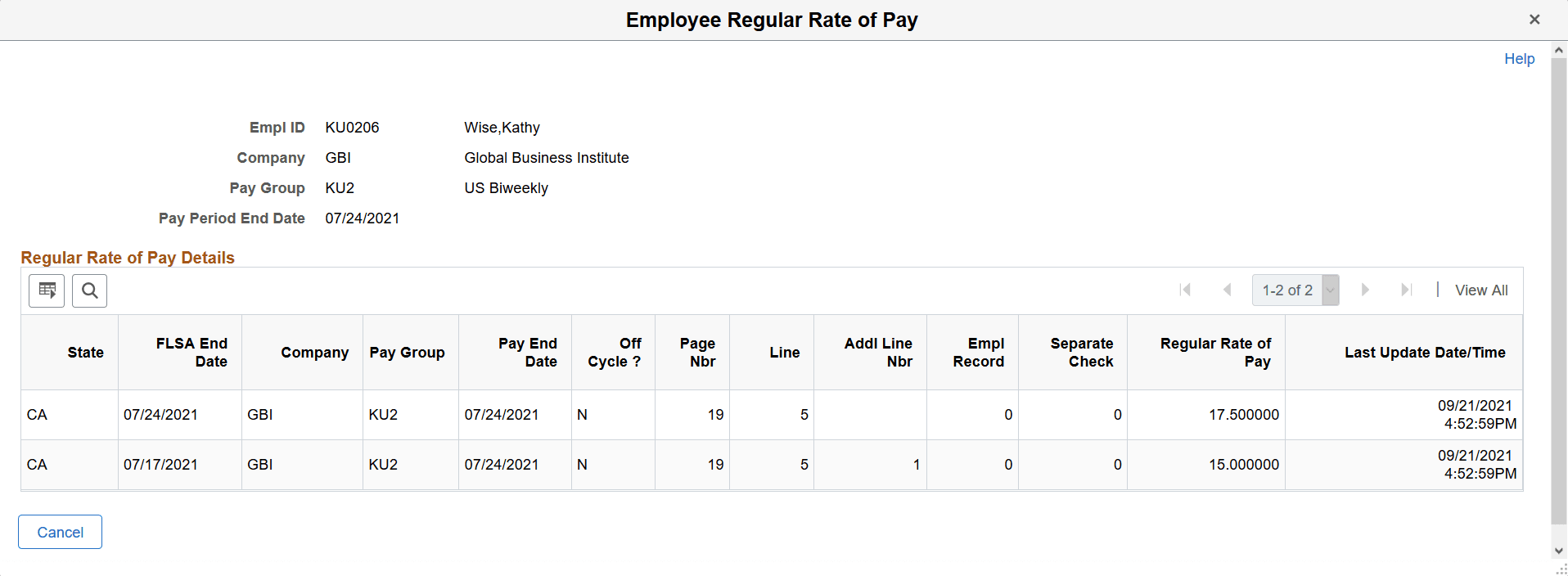

Example 3: Standard Calculation for California Employee Working 40 Hours a Week
In this example, the employee in California worked for 40 hours in each of the two 7-day FLSA weeks of the current pay period. The selected calculation routine for regular rate of pay for California is Standard Calculation.
California is set up on the Alternative Overtime State Table page. The employee's FLSA status is Nonexempt Alternative Overtime.

Even though the number of total hours worked doesn't exceed 40, the system calculates the employee's regular rate of pay because the 40-work-hour rule doesn't apply when the state is specified in the alternative overtimes state table and the employee is in the right FLSA status. In the first week's example, the calculated regular rate of pay is 15 USD, same as the hourly rate.

Total Earnings for the Week |
15 USD x 40 + 100 USD = 700 USD |
Regular Rate of Pay |
700 USD / 40 = 17.50 USD |
In the second week's example, the employee had a 100 USD bonus and the calculated regular rate of pay is 17.50 USD.
This example illustrates the calculated regular rates of pay for both FLSA periods on the Employee Regular Rate of Pay page (example 3).

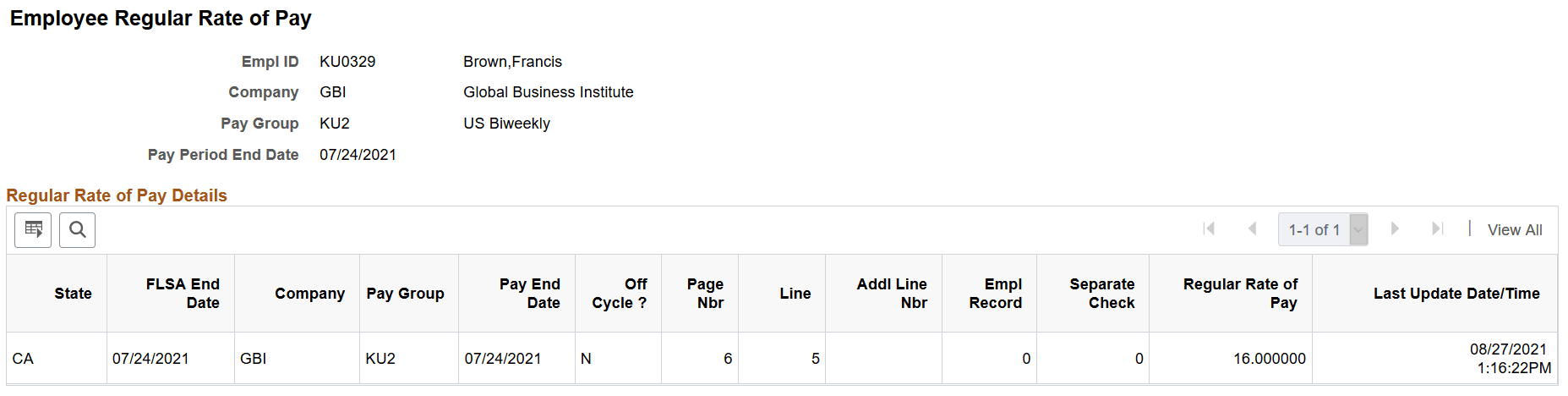

Example 4: Include Overtime Premium Calculation for California Employee Working 40 Hours a Week
In this example, the employee in California worked for 40 hours in the 7-day FLSA period, and had a flat sum bonus. The selected calculation routine for California is Include Overtime Premium.

The regular rate of pay is calculated by adding the hourly rate and overtime premium, which is 18.50 USD.
This example illustrates the calculated regular rate of pay for the FLSA period on the Employee Regular Rate of Pay page (example 4).

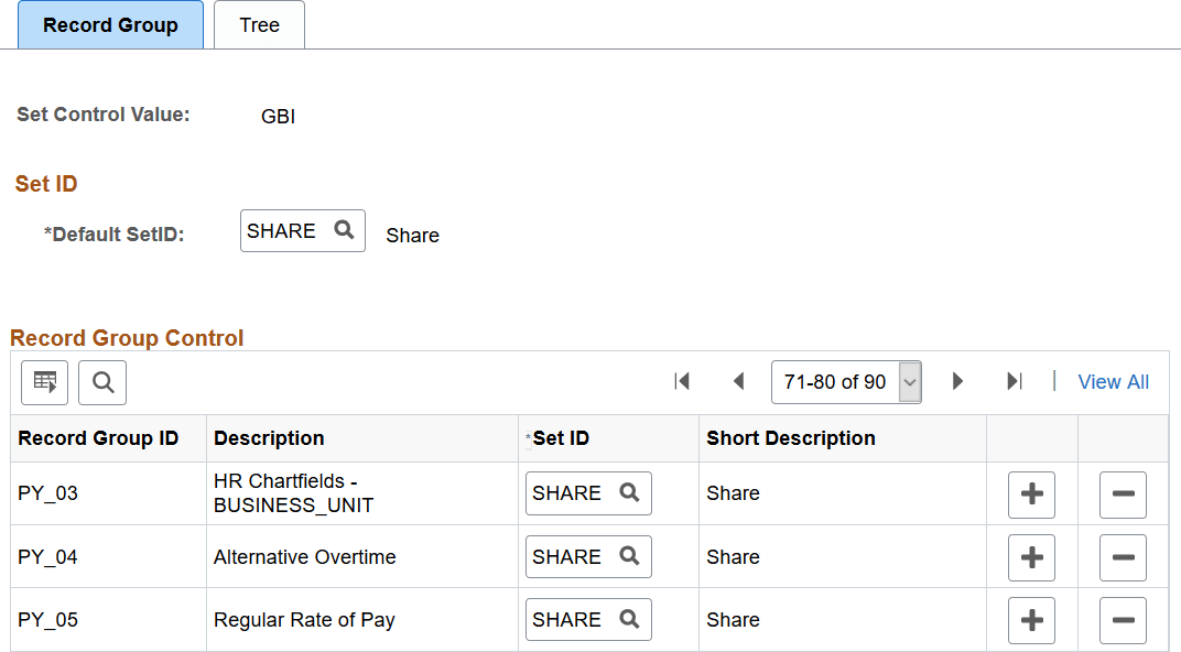

Here are the high-level steps for setting up the Regular of Rate Pay calculation.
Select an setID for the PY_05 record group on the Record Group page (SET_CNTRL_TABLE1) to match the setID that you use for the regular rate of pay setup on the Regular Rate of Pay Control Page.
This example displays the record groups and their setIDs for GBI on the Record Group page. The setID for the PY_05 record group is SHARE, the same setID that is also used in the regular rate of pay setup.

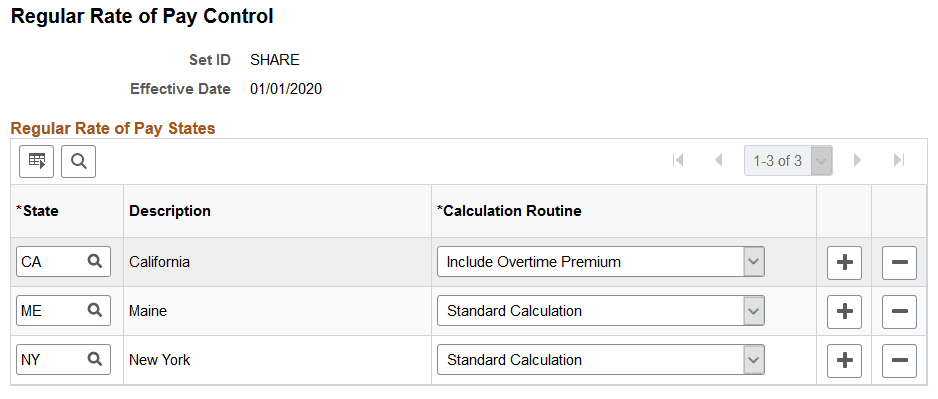

Specify the states that require employees’ regular rate of pay to be calculated for non-overtime pay and the applicable calculation routine on the Regular Rate of Pay Control Page. The Pay Calculation process uses the setID of the company on the payline to determine if the state needs the regular rate of pay calculation as of the earnings end date.
Use the Regular Rate of Pay Control page (PY_REG_RT_TABLE) to specify the states that require regular rate of pay calculation for non-overtime pay.
Navigation:
This example illustrates the fields and controls on the Regular Rate of Pay Control page.
The SHARE setID is delivered as sample data showing the states that use the regular rate of pay to calculate non-overtime pay for non-exempt employees. This screenshot displays state information for illustration purposes. Update information on this page to support your organization's alternative overtime business rules.

Calculation Routine |
Select the applicable calculation routine for the state. Values are: Include Overtime Premium: Select this option if the state, for example, California, requires the regular rate of pay to include the overtime premium/regular bonus rate. This calculation routine factors a flat sum bonus that an employee receives into their regular rate of pay by: Amount of the bonus / total number of non-overtime hours worked during the work period Standard Calculation (default value) |
