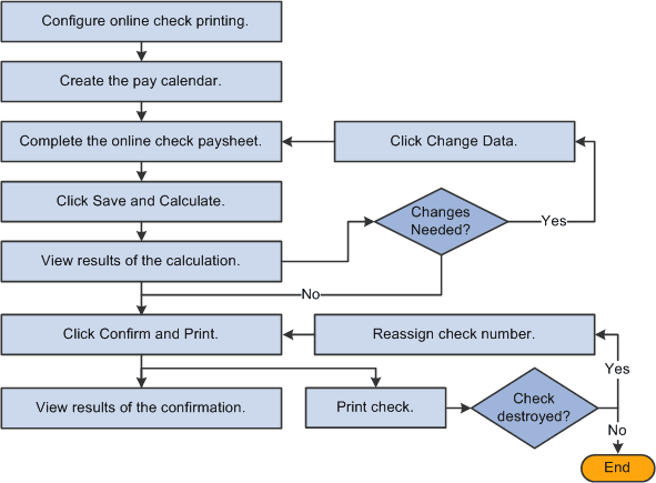

This diagram illustrates the step involved in online check processing from configuring online check printing to the printing of checks.

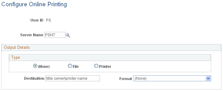

Use the Configure Online Printing page (PAY_OL_PRNT) to configure the system for online printing.
Navigation:
This example illustrates the fields and controls on the Configure Online Printing page.
Field or Control |
Description |
Type |
Select Printer, File, or None. |
Destination |
Enter a printer port or file directory to receive your output. |
Format |
Select the format in which you want the report printed. |

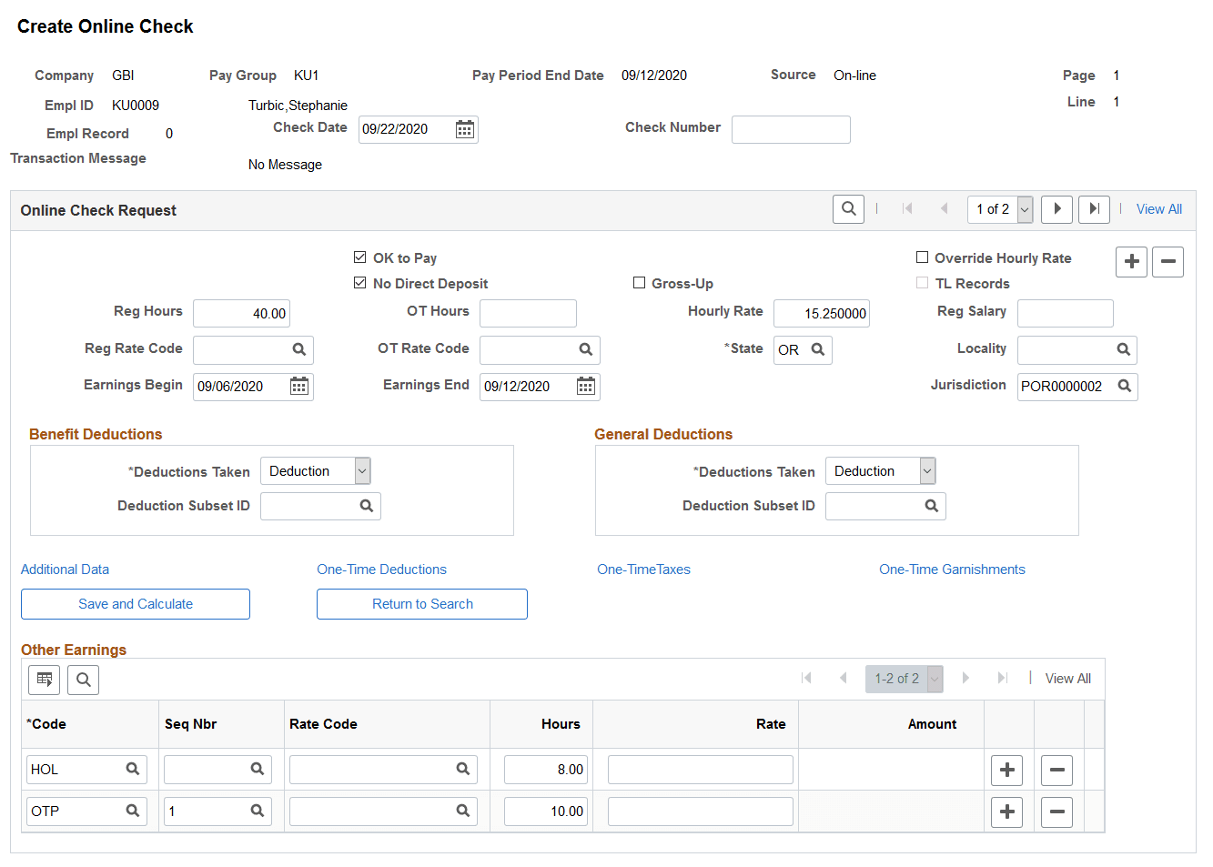

(USA, USF) Use the Create Online Check page (PAY_OL_SHEET_S1) to create an employee's online check paysheet and check.
Note: (CAN) The Online Cheque Paysheet page is similar to the U.S. version.
Navigation:
You must enter filter options to access the Create Online Check page.
Note: Many of the fields on the Create Online Check page are identical to those on the Paysheet page.
Warning! If you use the Paysheet Creation process for online checks using the same on-cycle pay calendar that's being processed in batch, the employee receives a duplicate check.
Field or Control |
Description |
Check Number |
You can either specify a number or have one assigned by the system. |
Benefit Deductions
Field or Control |
Description |
Benefit Deductions Taken |
The initial value comes from the pay calendar, but you can override it.
General Deductions
Field or Control |
Description |
Deductions Taken |
Additional Page Elements
Field or Control |
Description |
Save and Calculate |
When you're ready to calculate the check, select this button to start the calculation process. The system then displays the Review/Print Online Check page. |
Return to Search |
If you want to set up a single check for another employee, select Return to Search to redisplay the Create Single Check selection page. |

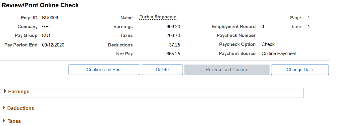

(USA, USF) Use the Review/Print Online Check page (PAY_OL_CHECK_S) to confirm and print a check, delete the check, or return to the Create Online Check page to change data.
Navigation:
This example illustrates the fields and controls on the Review/Print Online Check page after calculation.
When you select Save and Calculate on the Create Online Check page, the system performs the calculation and displays the Review/Print Online Check page.
You must assign a pay run ID to the appropriate pay calendar. Otherwise, the system cannot find any employee data for online single check processing. The fields on this page are display-only and are based on the data that was entered on the Create Online Check page.
Important! Any uncalculated or unconfirmed online single checks are automatically calculated or confirmed by an off-cycle pay run if the online check page numbers fall within the range entered for the off-cycle pay run.
Field or Control |
Description |
Confirm and Print |
Select to confirm and print the online check. Select whether to use BI Publisher to create a PDF paycheck for this employee for self-service viewing. If you select No, the system creates a non-PDF paycheck for the online check using SQR reports. Note: If you use the BI Publisher process with the View Paycheck transaction in PeopleSoft ePay, the number of days from check date that you specify on the Paycheck Options Table page determines when the employee can view the check online. After confirming, the system returns you to the Review/Print Online Check page. |
Field or Control |
Description |
Delete |
If you fail to confirm and print the online check, you will leave an outstanding paysheet that prevents pay calculation later. Delete the check if you do not complete the process. |
Change Data |
Select to return to the Create Online Check page to change data and recalculate. |

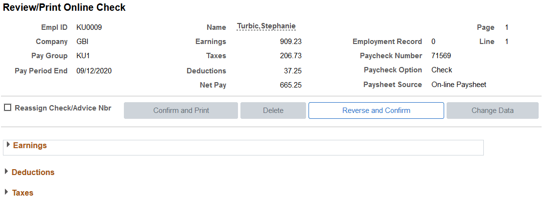

This example illustrates the fields and controls on the Review/Print Online Check page after confirmation.
Field or Control |
Description |
Reassign Check/Advice Nbr (reassign check or advice number) |
If the online check was destroyed while printing, select this check box to reprint the check with a different check number. When you select this check box, the Confirm and Print button becomes available. |
Confirm and Print |
This button is available if you select Reassign Check/Advice No. Select this button to access the Paycheck Printing/Re-assignment page, where you enter the new check number and select OK to print the check with the new number. |
Reverse and Confirm |
Select to access the Check Reversal page and run the Check Reversal process. You cannot reverse a single check until it has been confirmed and printed. Until then, this button is unavailable. |
To reverse a confirmed online check:
Select Reverse and Confirm on the Review/Print Online Check page.
Enter a pay group and a pay end date.
The reversal is posted to the company, pay group, and pay end date specified here.
Select OK to run the Check Reversal process.
The system displays the Print Pay Checks page.
Review results of the reversal on the Review/Print Online Check page.
