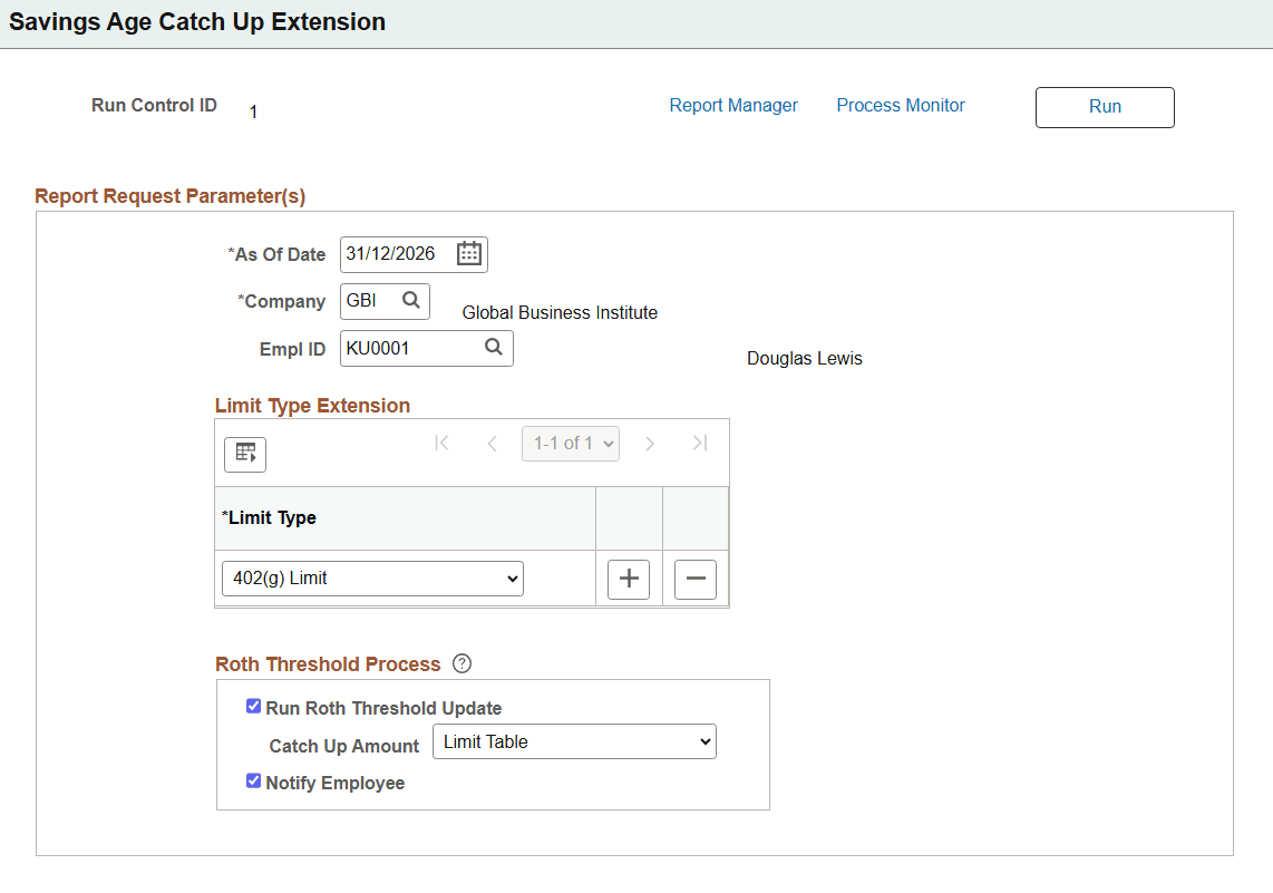

This example illustrates the fields and controls on the Savings Age Catch Up Extension page.
Savings age catch up extension page
Field or Control
Description
As Of Date
Enter the last day of the calendar year for which the age catch up extension applies.
Limit Type
Select the limit type extension that you want to run. Delivered options are 402(g) Limit, 415(c) Limit, 415(c) Limit for 403(b) plans, and 457 Limit.
You can run multiple limit types at the same time and produce age extension records for each limit type.
Run Roth Threshold Update
Select to allow the age catch-up extension process to verify the employee’s prior year Taxable Gross Year-To-Date (YTD) amounts for Tax Class D (OASDI/Disability – EE) against the limit entered in the Limit Table. The employees whose YTD earning exceeds the threshold are flagged for Mandatory Roth rollover and are checked in the Benefits Savings Management Page.
Catch Up Amount
This field is displayed only when Run Roth Threshold Update is selected. The option selected for this field determines the age catch up amount to be assigned for the employees flagged in the Benefits Savings Management page. Available values are:
  • Limit table: Assign age catch up amount based on employee’s age and company in Company Limits grid of Limit Table. This is the default option.
  • None: Assign zero to age catch up amount. This option is used by companies who do not offer a Roth Rollover plan. The employees who are flagged for Mandatory Roth Rollover are processed to have no age catch up extension.
Notify Employee
This field is displayed only when Run Roth Threshold Update is selected. Select to send notifications (in-app alert and email) to employees flagged for Mandatory Roth rollover after the savings age catch-up extension process is run.
