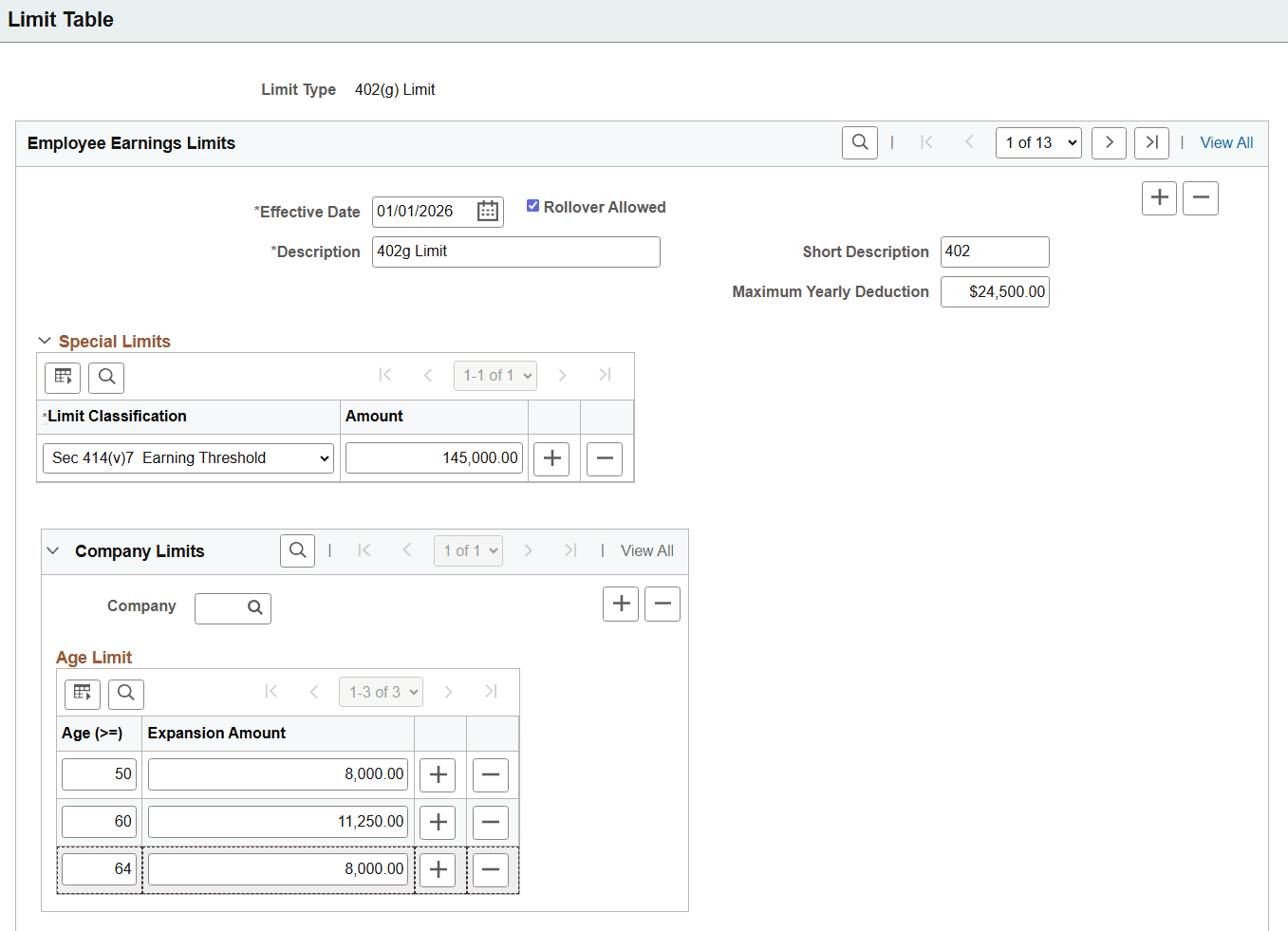

  • 402 – Extensions per age range defined in the Limit table for a 401(k) and, a 403(b) plan, or both.
  • 415 – Extensions per age range defined in the Limit table for a 401(k) plan.
  • 415z – Extensions per age range defined in the Limit table for a 403(b) plan.
  • 457 – Extensions per age range defined in the Limit table for a 457 eligible governmental plan.
  • 401(a) – Adjust Eligible Earnings for 401(k), 403(b), and 457 plans.
Field or Control
Description
Age Limit
Enter the catch-up amount for different age range.
Special Limits
Select the limit classification and enter the amount.
Select Sec 414(v)7 Earning Threshold for Limit Classification and enter applicable limit in the Amount field.

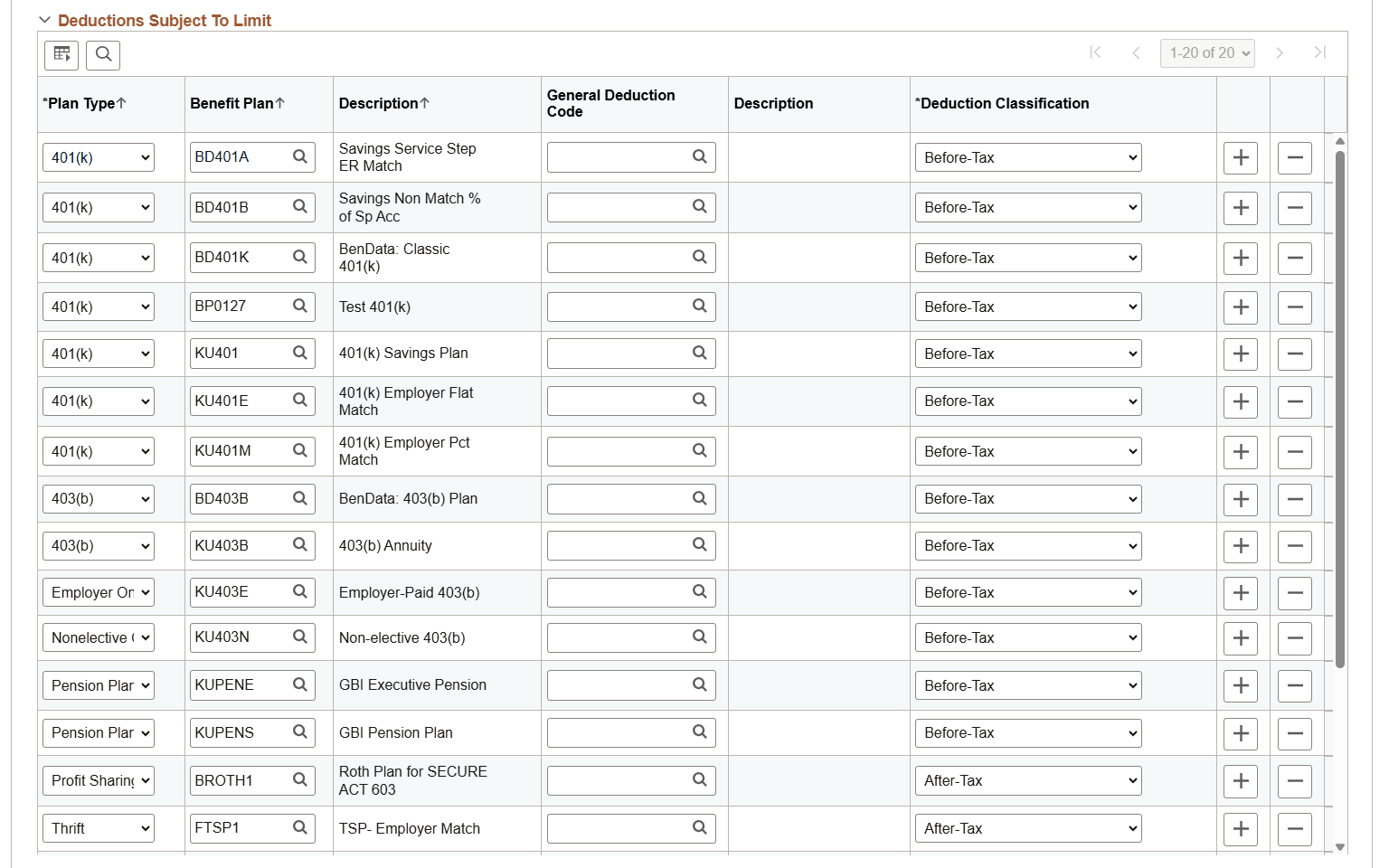

Deductions Subject To Limit
Select the deduction codes for any and all benefit plans that fall under the specified limit. This list should be as comprehensive as possible. Both general deductions and benefit plans can be specified.
To associate a limit with a deduction, enter the plan type, benefit plan, general deduction code, and deduction class.
A single plan type may require more than one deduction classification. You may have to insert rows for after-tax, before-tax, nontaxable benefit, and nontaxable pretax benefit classifications for a single 401(k) plan.
Note: 401(a) limit processing is supported on savings plan deductions only. A general deduction will not enforce 401(a) limits.

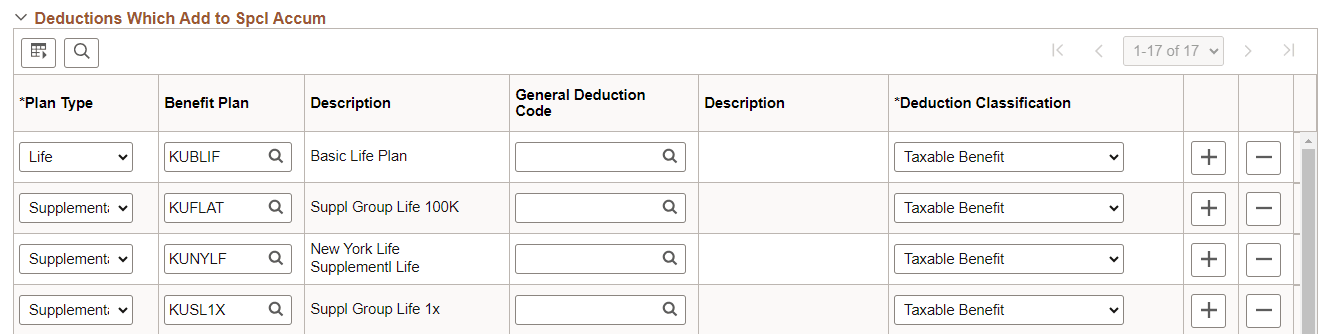

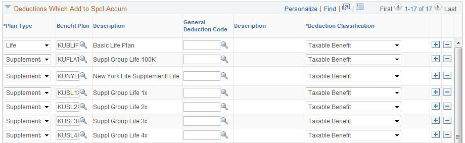

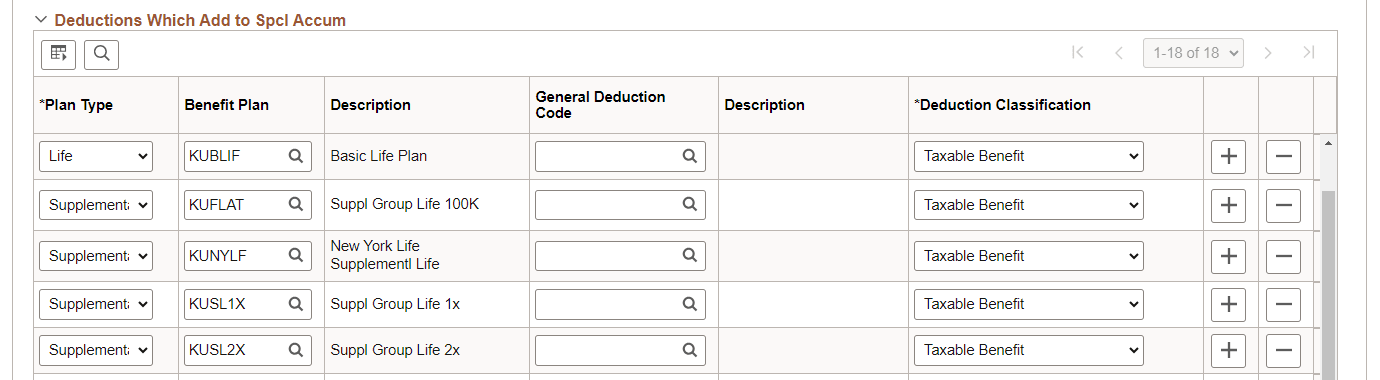

Deductions Which Add to Spcl Accum (deductions which add to the special accumulator)
Enter deductions to add to the special accumulator. These are the taxable benefits that the IRS stipulates can be included in the calculation of the limits.
The system increases the employee's eligible earnings by the total year-to-date plus the current amount of the taxable benefits that you enter here before calculating the employee's current limit.
To add a deduction to a special accumulator, enter the plan type, benefit plan, general deduction code, and deduction class.

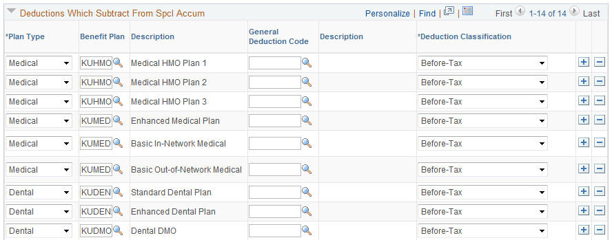

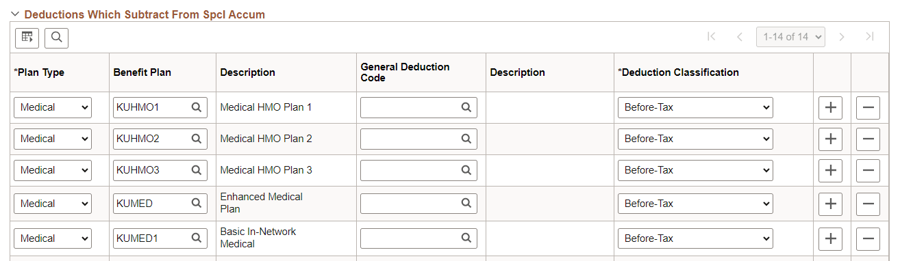

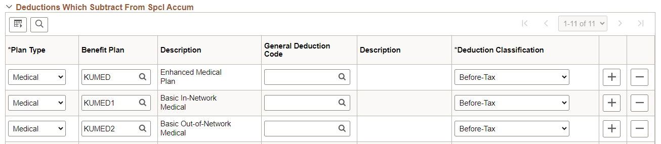

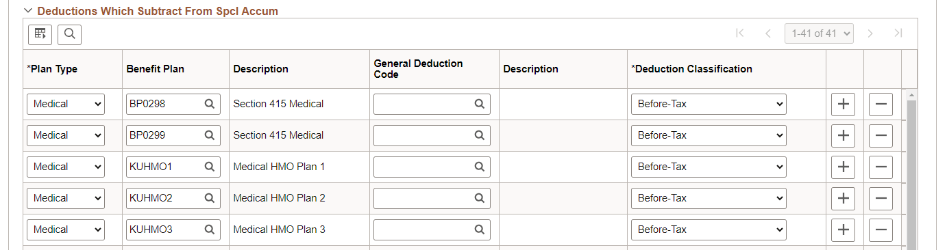

Deductions Which Subtract From Spcl Accum (deductions which subtract from the special accumulator)
Enter the deductions that subtract from the special accumulator. These are deductions that the IRS stipulates must be excluded from the calculation of the limits. (Ordinarily, these are before-tax deductions, but you may encounter exceptions.)
The system reduces the employee's eligible earnings by the total year-to-date plus current amount of the deductions that you enter here before calculating the employee's current limit.
For each taxable benefit, fill in the plan type, benefit plan, deduction code, and deduction class.

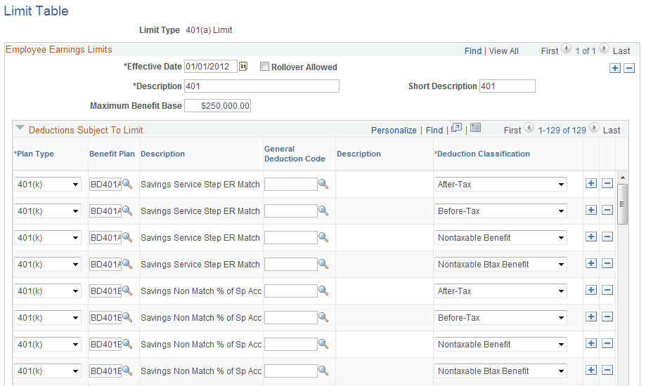

Use the Limit Table page (LIMIT_TBL1) to identify the rules that apply to the 401(a) limits.
Navigation:
Set Up HCM > Product Related > Base Benefits > Rates and Rules > Limit Table > Limit Table
Access the Limit Table page for 401(a) limits.
This example illustrates the fields and controls on the Limit Table page for 401(a) limits.
Use the Limit Table page (LIMIT_TBL1) to identify the rules that apply to the 402(g) limits.
Navigation:
Access the Limit Table page for 402(g) limits
This example illustrates the fields and controls on the Limit Table page for 402(g) limits (Page 1 of 2).
402g_Limit Table (Page 1 of 2)
This example illustrates the fields and controls on the Limit Table page for 402(g) limits (Page 2 of 2).
402g_Limit Table (Page 2 of 2)

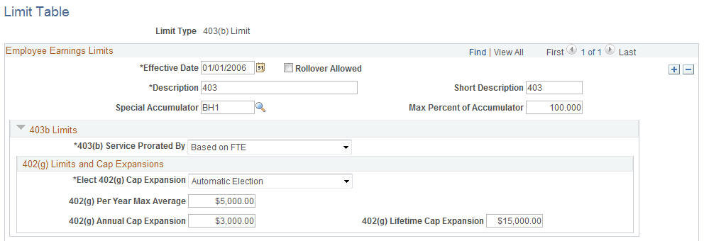

Use the Limit Table page (LIMIT_TBL1) to identify the rules that apply to the 403(b) limits.
Navigation:
Access the Limit Table page for 403(b) limits
This example illustrates the fields and controls on the Limit Table page for 403(b) limits (1 of 3).
Limit Table page for 403(b) limits (1 of 4)
This example illustrates the fields and controls on the Limit Table page for 403(b) limits.
Limit Table page for 403(b) limits (2 of 4)
Limit Table page for 403(b) limits (3 of 4)
Limit Table page for 403(b) limits (4 of 4)
Field or Control
Description
403(b) Service Prorated By
Select the proration method to use for the 403(b) service year calculation in the Projection process. This information is taken from the employee's job record.
Elect 402(g) Cap Expansion
Select either Automatic Election, No, or Yes.
402(g) Per Year Max Average, 402(g) Annual Cap Expansion, and 402(g) Lifetime Cap Expansions
All of these fields are determined by IRS regulations. Enter the current approved standards.

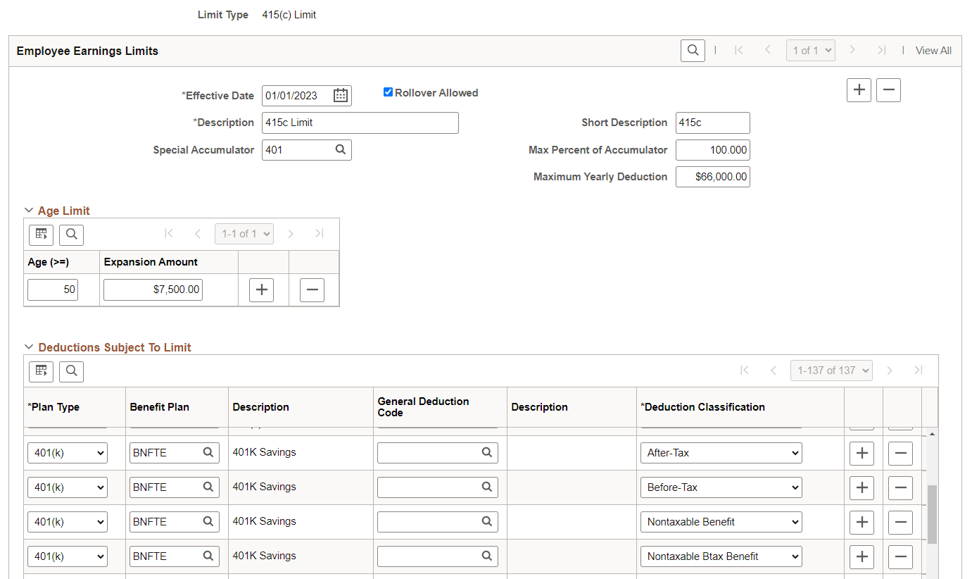

Use the Limit Table page (LIMIT_TBL1) to identify the rules that apply to the 415 limits.
Navigation:
Access the Limit Table page for 415 limits.
This example illustrates the fields and controls on the Limit Table page for 415 limits (1 of 3).
Limit Table for 415(c) Limit (Page 1 of 3)
This example illustrates the fields and controls on the Limit Table page for 415 limits (2 of 3).
Limit Table for 415(c) Limit (Page 2 of 3)
This example illustrates the fields and controls on the Limit Table page for 415 limits (3 of 3).
Limit Table for 415(c) Limit (Page 3 of 3)

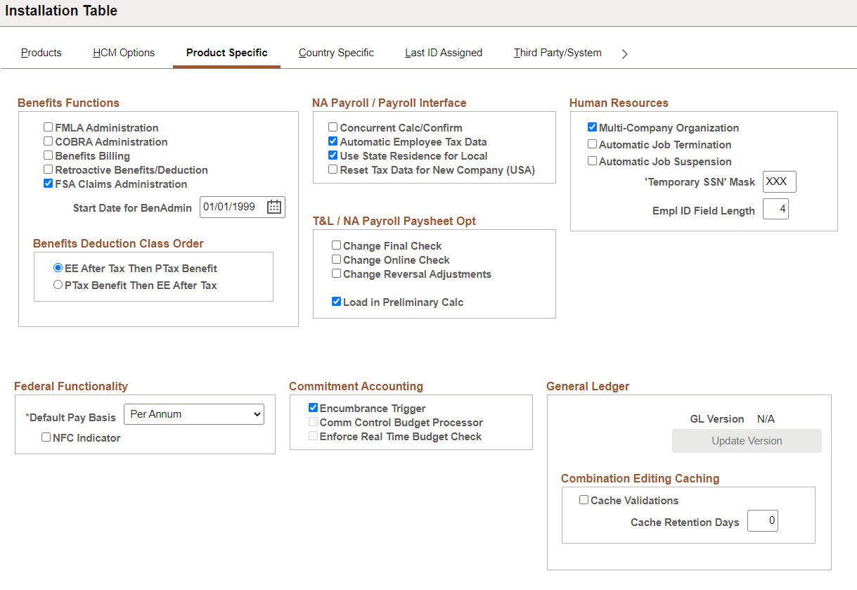

If you are setting up the 415 Limit Table, access the Installation Table to set the deduction class order.
Access the Installation Table (Set Up HCM > Install > Installation Table).
Navigate to the Product Specific tab.
This example illustrates the fields and controls on the Installation Table - Product Specific page.
Benefits Deduction Class Order
Field or Control
Description
EE After Tax Then PTax Benefit
When applying the 415(c) limit, the system applies the reduction first to the employer before tax contribution, then to the employee after tax contribution.
Field or Control
Description
PTax Benefit Then EE After Tax
When applying the 415(c) limit, the system applies the reduction first to the employee after tax contribution, then to the employer before tax contribution.

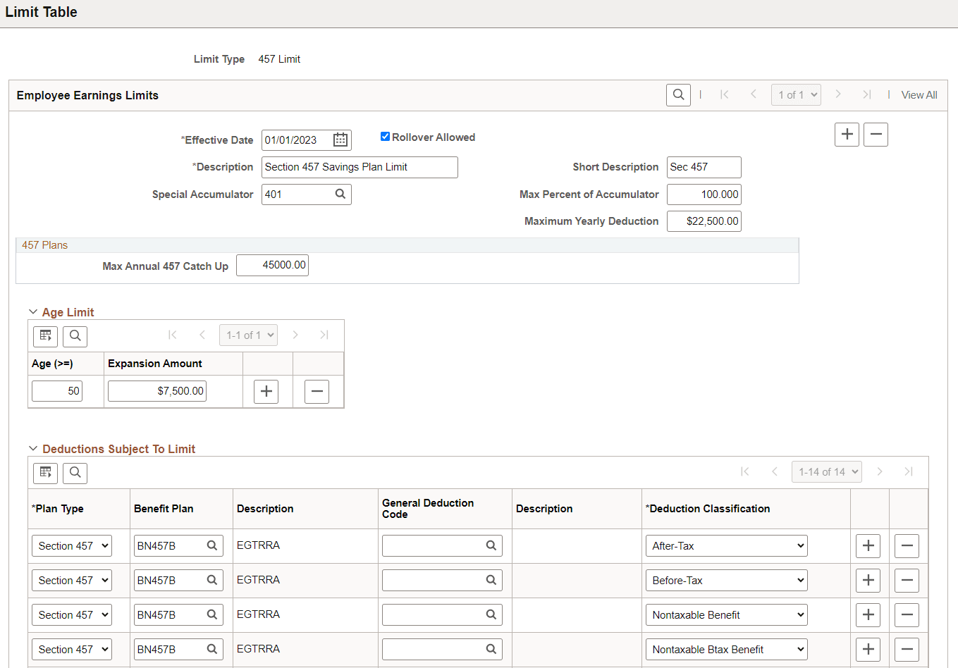

Use the Limit Table page (LIMIT_TBL1) to identify the rules that apply to the 457 limits.
Navigation:
Access the Limit Table page for 457 limits.
This example illustrates the fields and controls on the Limit Table page for 457 limits (1 of 3).
Limit Table for 457 Limit (Page 1 of 3)
This example illustrates the fields and controls on the Limit Table page for 457 limits (2 of 3).
Limit Table for 457 Limit (Page 2 of 3)
This example illustrates the fields and controls on the Limit Table page for 457 limits (3 of 3).
Limit Table for 457 Limit (Page 3 of 3)

Max Annual 457 Catch Up (maximum annual 457 catch up)
Section 457 plans have a catch-up rule. Within three years of retirement, a participant can increase the amount contributed to the savings plan. This field is determined by IRS regulations.

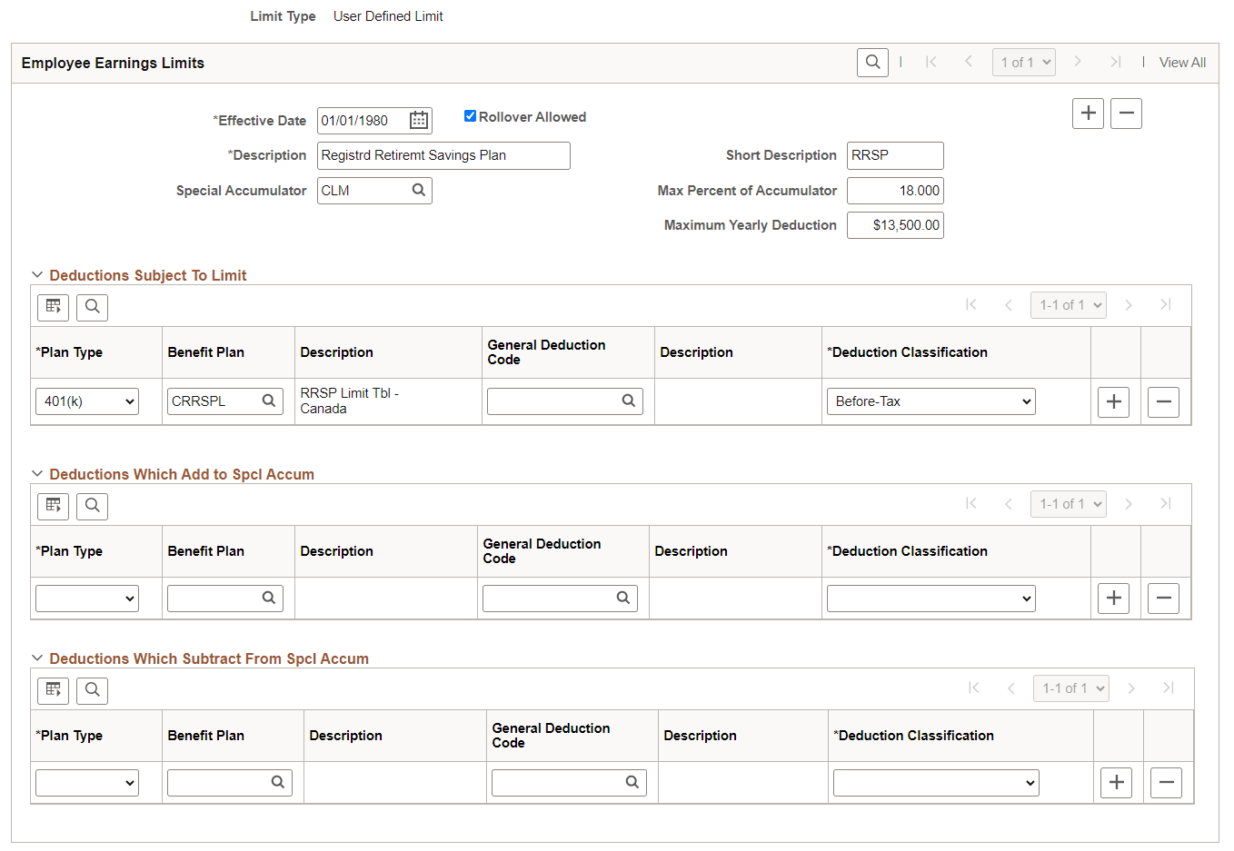

Use the Limit Table page (LIMIT_TBL1) to identify the rules that apply to User Defined limits.
Navigation:
Access the Limit Table page for User Defined limits.
This example illustrates the fields and controls on the Limit Table page for User Defined limits page.
Limit Table for User Defined Limit
User Defined Per Check Limit can be used to limit a deduction across two plans. For example, the table can be set up to limit the employer contribution across two plans.
Note: Unlike the other limits, User Defined Per Check Limit is set to limit in one pay check period. The others are set to limit plan balances.
