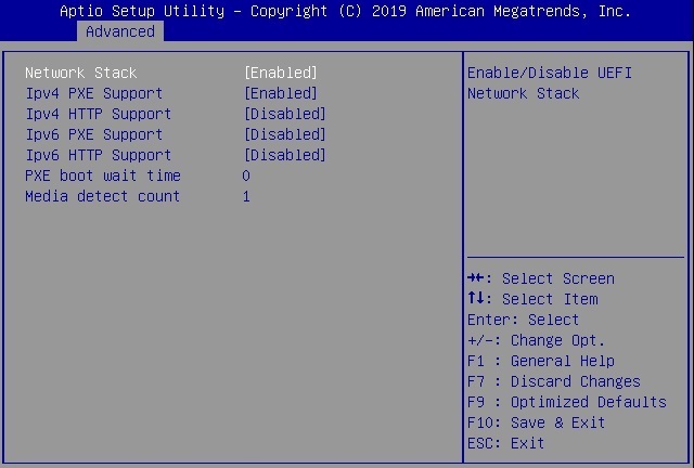

The BIOS Setup Utility Network Stack screen appears.
This causes the server to reset. After resetting, the BIOS screen appears again.

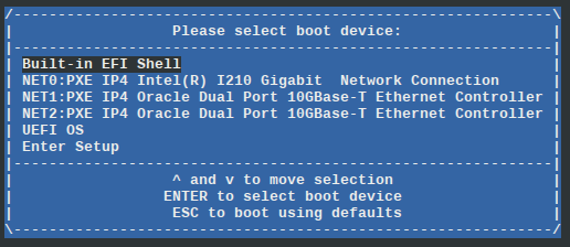

The Please Select Boot Device menu appears, listing the available boot devices.
The PXE boot port is the physical network port configured to communicate with your network install server.
Follow the onscreen prompts to complete the PXE installation.
