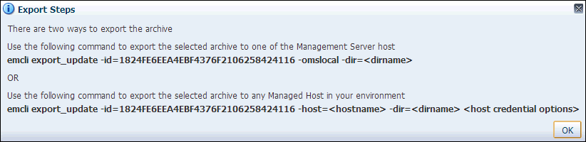

      A pop-up window appears with the command required to export the file. Figure 5-1 shows an example of the window.
      Figure 5-1 Export Command Example
      export command

  1. Navigate to the Management Connector Updates page and export the HPSM 9 Connector.
  2. Copy the first EM CLI command listed in the Export Steps window for later use:
    emcli export_update -id=C5289206C5A5A84AF82C49821C8F2931 -omslocal -dir=<dirname>
