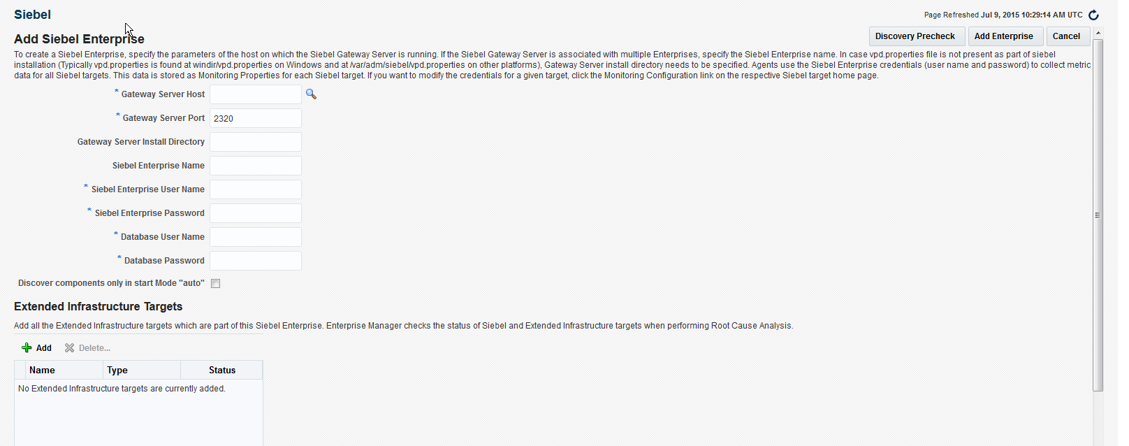

To add a Siebel Enterprise to Cloud Control for monitoring, perform the following steps:
Figure 3-1 Add Siebel Enterprise Page

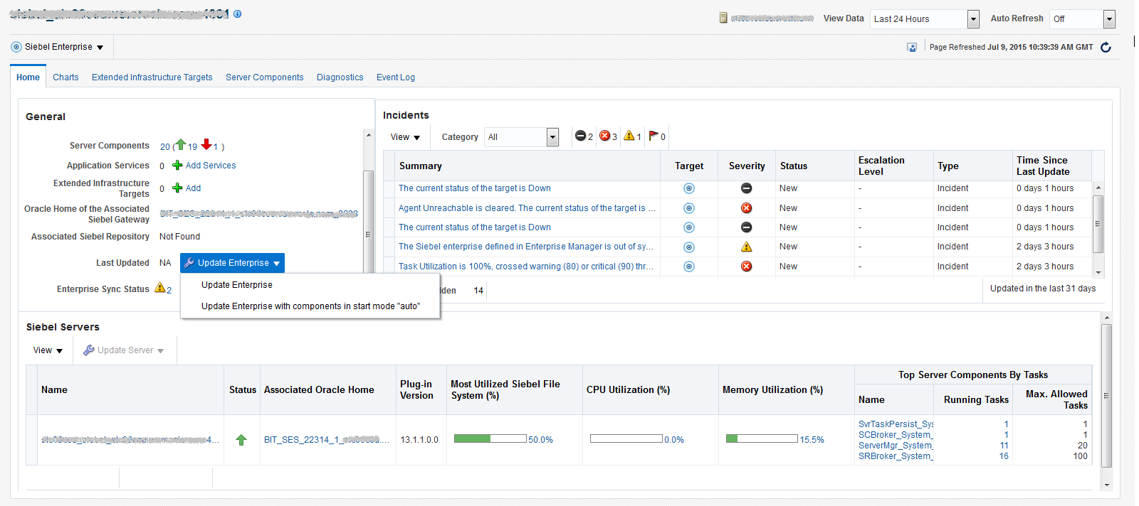

After you add or remove Siebel servers or server components from your Siebel Enterprise, you must update the Enterprise, and check the relations between the Siebel Enterprise and Enterprise Manager targets.
Perform the following steps to update the Enterprise:
Figure 3-2 Siebel Enterprise Home Page

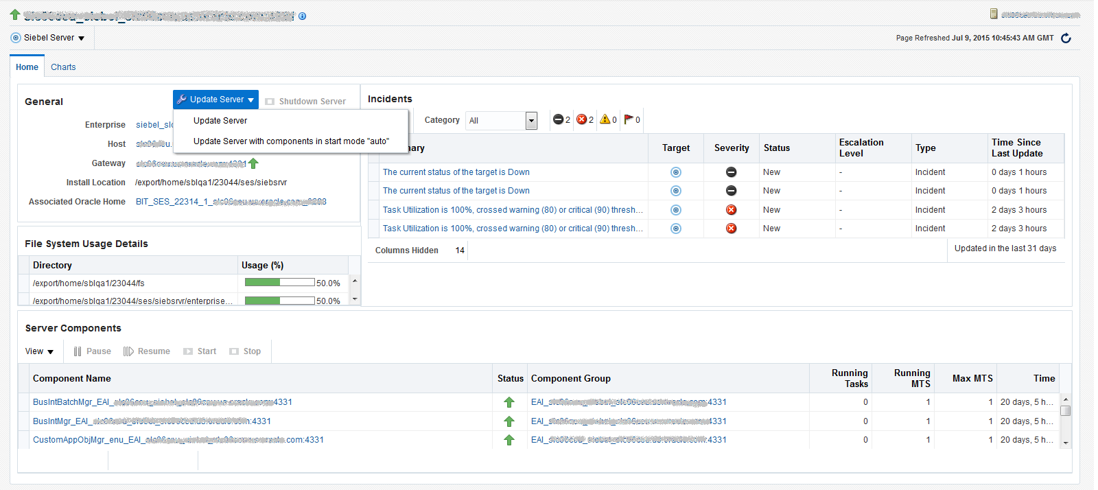

To synchronize the topology for Siebel Servers, perform the following steps:
Figure 3-3 Siebel Server Home Page
