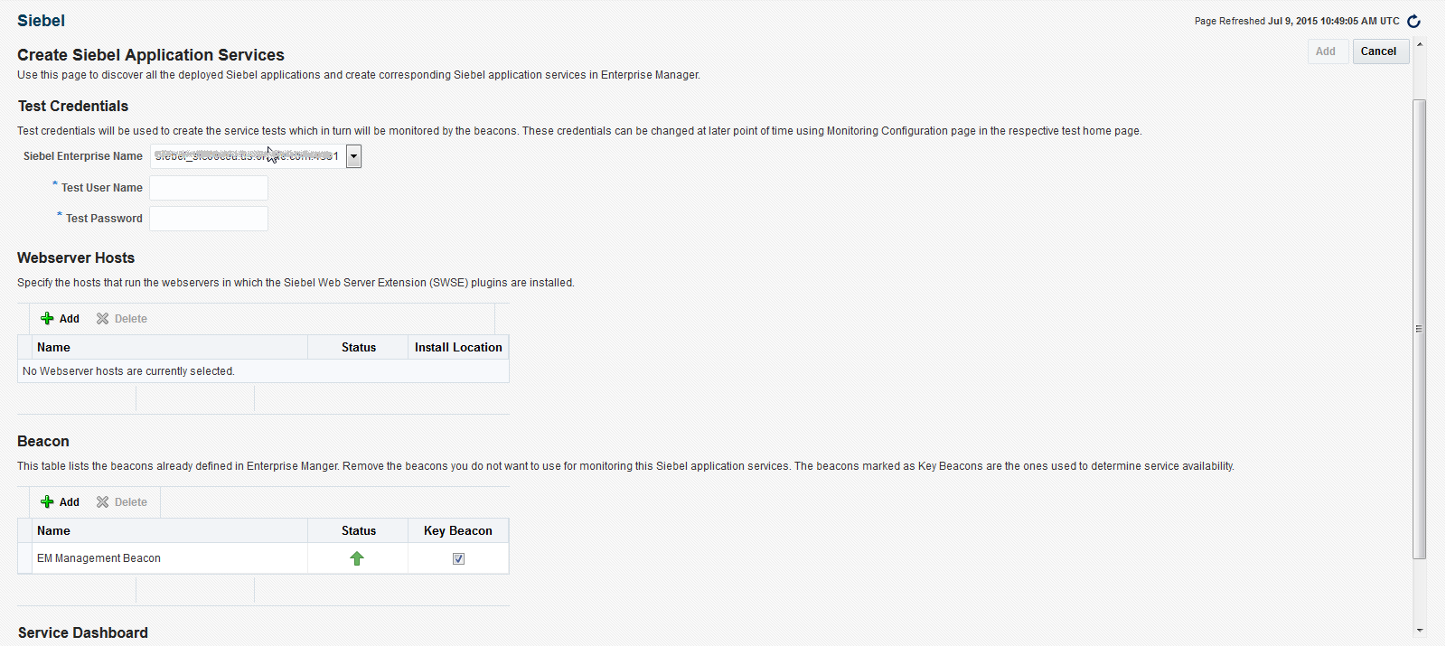

To create Siebel application services, perform the following steps:
Figure 4-1 Create Siebel Application Services Page
Before proceeding, note the following advisory information:
