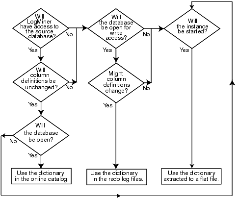

Figure 20-2 shows a decision tree to help you select a LogMiner dictionary, depending on your situation.
Figure 20-2 Decision Tree for Choosing a LogMiner Dictionary
Description of Figure 20-2 follows
Description of "Figure 20-2 Decision Tree for Choosing a LogMiner Dictionary"
